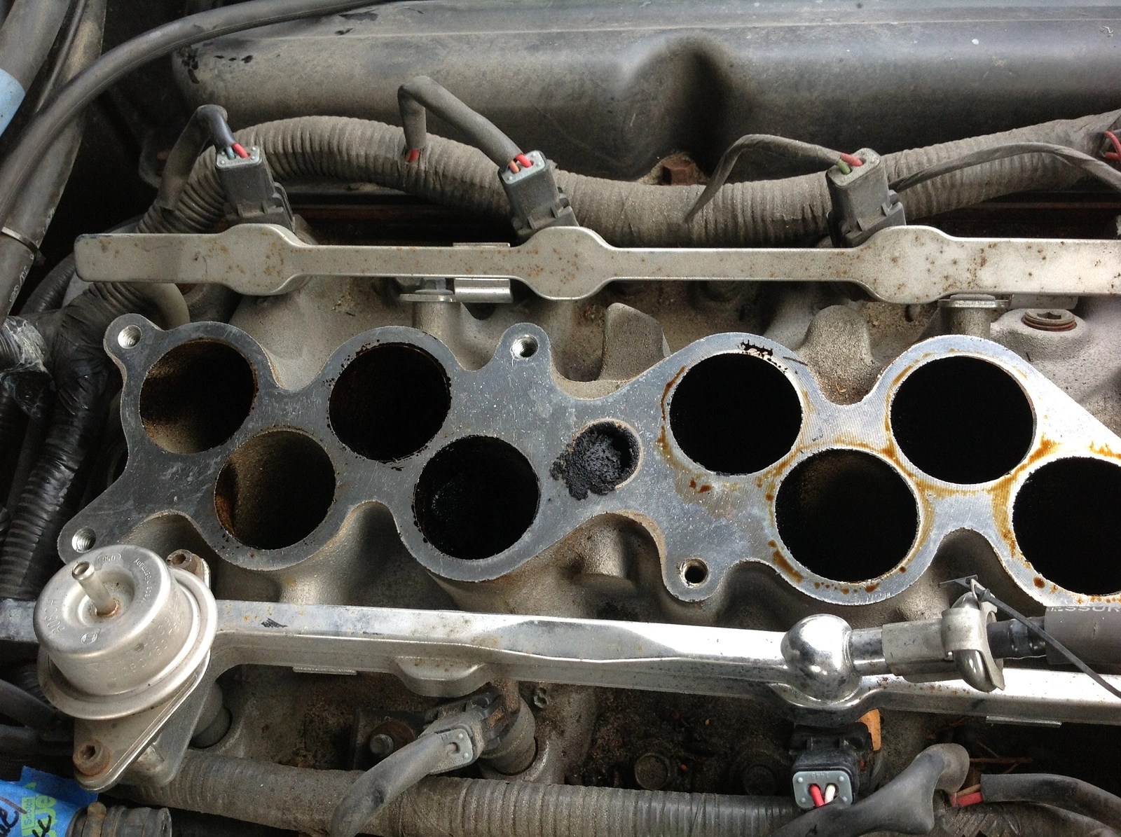

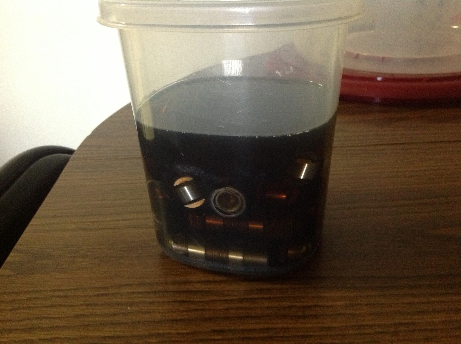

  11. joetrainer31
    joetrainer31 Member
    Joined:
    Mar 31, 2013
    Messages:
    375
    Likes Received:
    Trophy Points:
    Location:
    CA
    image.jpg lifter bath.
    image.jpg dirty boy intake had a gasket that was so brittle it fell apart. The lower intake bolts were little more than hand tight. Its a wonder the car even ran!

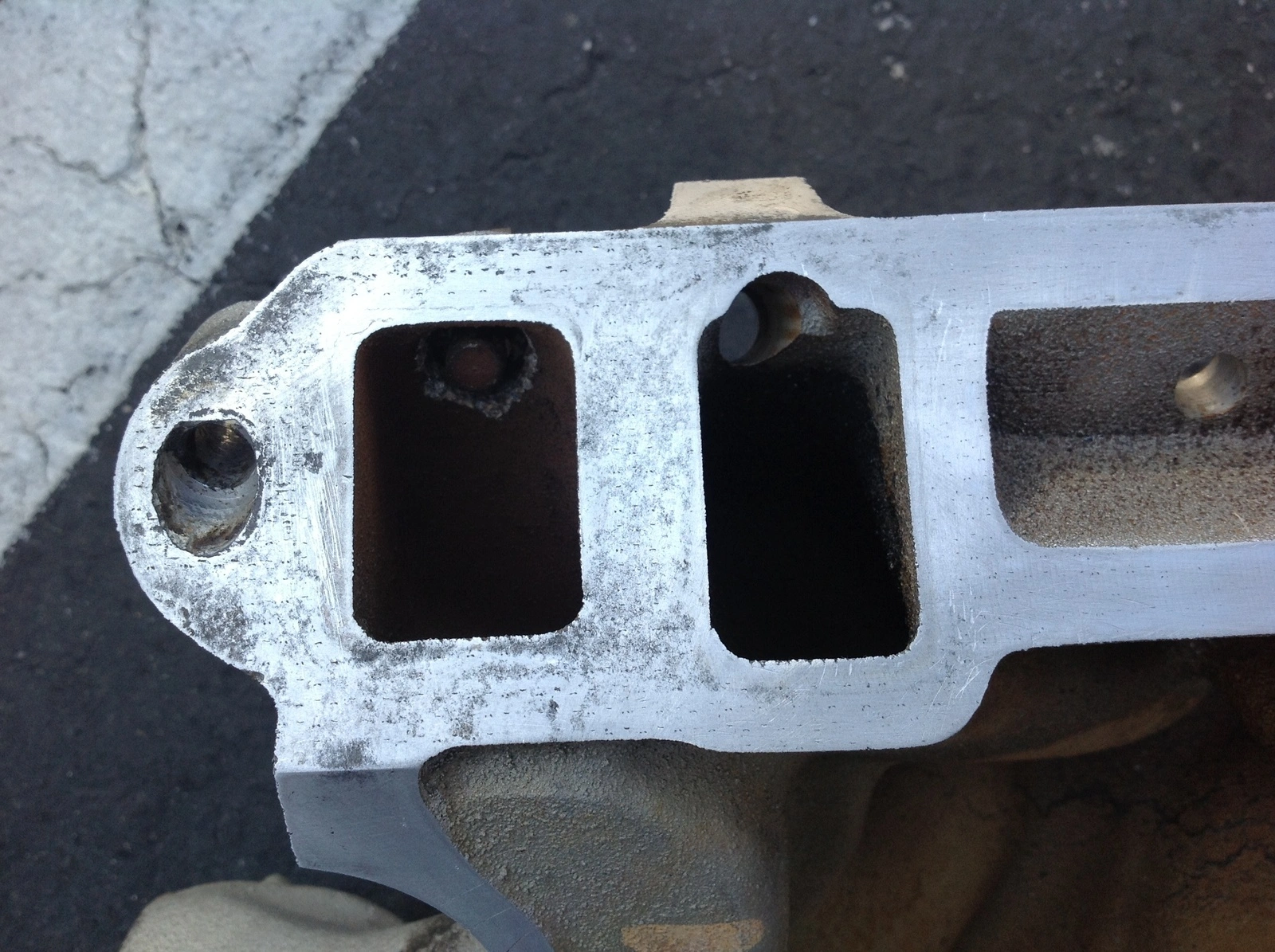

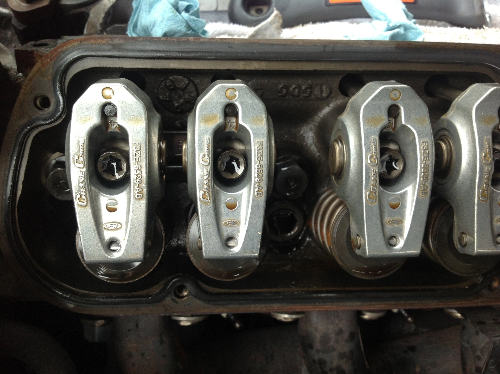

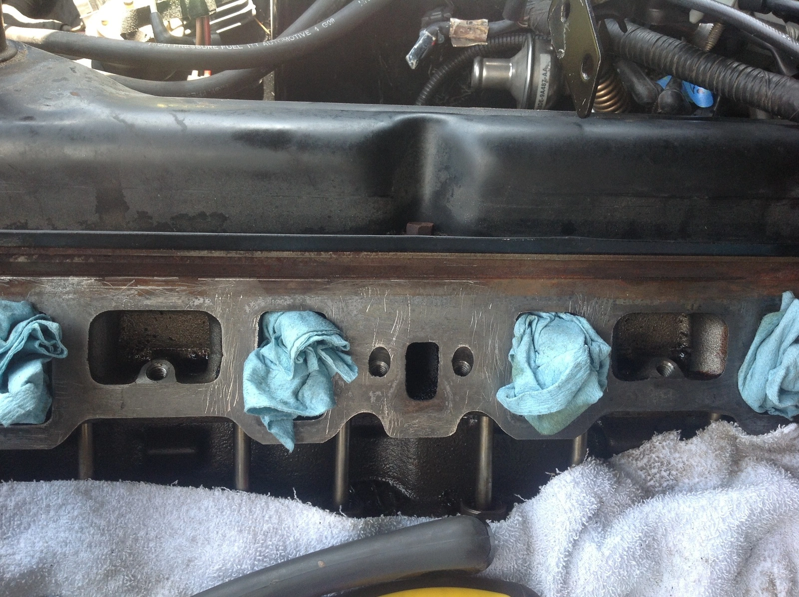

  12. joetrainer31
    joetrainer31 Member
    Joined:
    Mar 31, 2013
    Messages:
    375
    Likes Received:
    Trophy Points:
    Location:
    CA
    image.jpg clean lower intake. image.jpg image.jpg heads read for light sanding/vacuum, then an ascetone wipe down. image.jpg how are these for factory rocket arms. These come standard with the SVO GT40 dealer option.

  13. ratio411
    Joined:
    Apr 21, 2002
    Messages:
    3,872
    Likes Received:
    69
    Trophy Points:
    69
    Location:
    Pensacola FL
    Those roller rockers came on Cobra engines, from Detroit, not the dealer.
