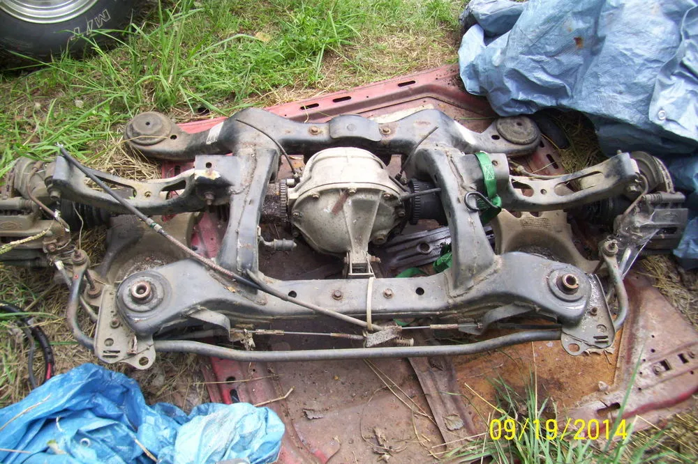

I had 31 spline axles in my 04 cobra with an 8.8 and I had over 100 passes with zero problems. I launched as high as 5000 rpm's on slicks and it worked flawless. I did have the axle tubes welded. I had the IRS in it for a good while, but got tired of the random wheel hop, even with level 5 half shafts. I never broke one shaft even when it had the stock shafts, but decided the solid was better for my purposes of mostly drag racing. I haven't had a chance to get my notch to the track yet, but I have 31 spline axles and welded tubes and an anti roll bar which is a must for drag racing in my opinion. It's amazing how straight your car goes with the anti roll bar. I don't expect any problems with the current set up. My cobra made 650 to the wheels and my notch is making 641 but weighs considerably less of course.
