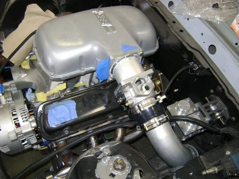

  1. It's 1.5 X 2.5. Perfect fit on these cars.
  2. Some tinkering with the parts that came in this weekend. Just need to make a bracket to hold it up in place so they line back up.
  3. are you going to mill off the the reverse bbk logo? not hatin just thinking. . . .
  4. nah it's cool. Where thinking the same thing since it's backwards. Only hard part is copying the texture. But he may want it powder coated though. So that would solve that problem.

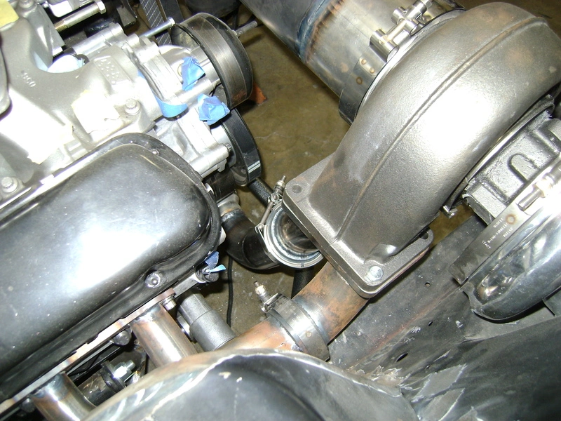

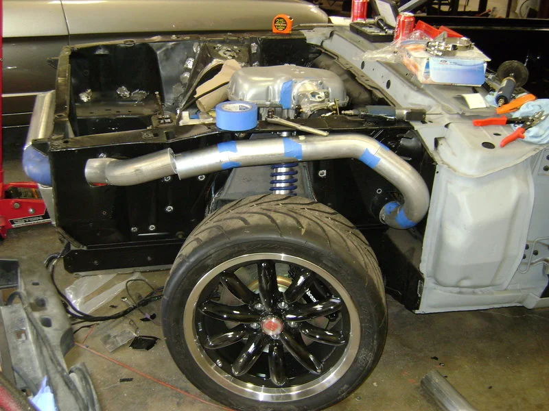

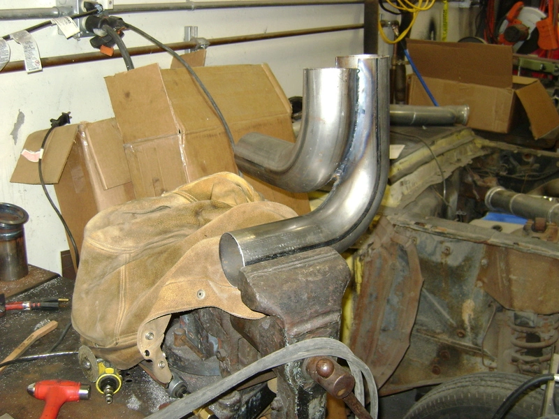

    Started work on the crossover and DP's. Ended up with splitting it into 2 3's. Will reduce it down to 2.5 quickly to get it out. Just trying to find a reducer that butts ups, not a slip fit.
    This kit is going to have quite a few v-bands. 8 ! Since it's going through the K-member, need to make it possible to get it out. 5 are on the Dp's.

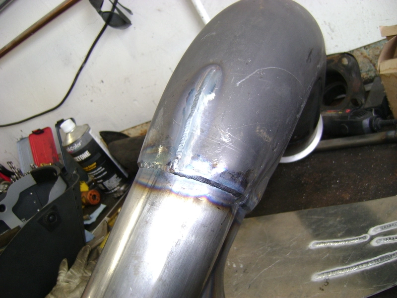

    Got the 5in split, and split the tubing a little to get it to form to the smaller stuff. You would figure being so big it would be easy to from. Nope. Had to stick it in the press and weld. That sucked.

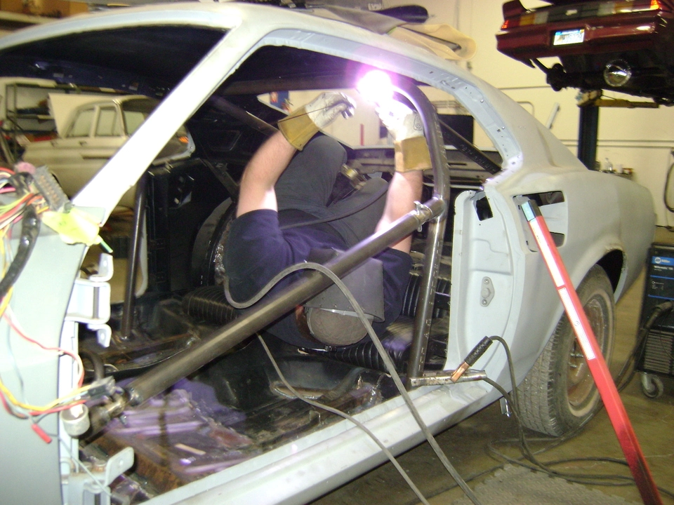

  10. I officially to damn big for this kinda work. Mind you at 275, welding with the pedal between my legs, sucks.

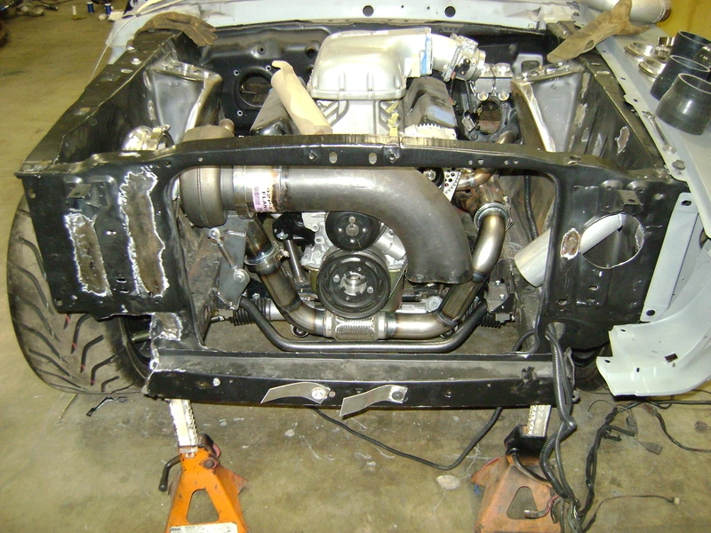

  11. Been working a little on the turbo kit, nothing really new. But got it back from the paint shop and getting some more stuff done while the primer sets up.
    Maier export came in, and didn't quite fit right. But niether do any others. So we just ordered it unassembled, and got 'er done.

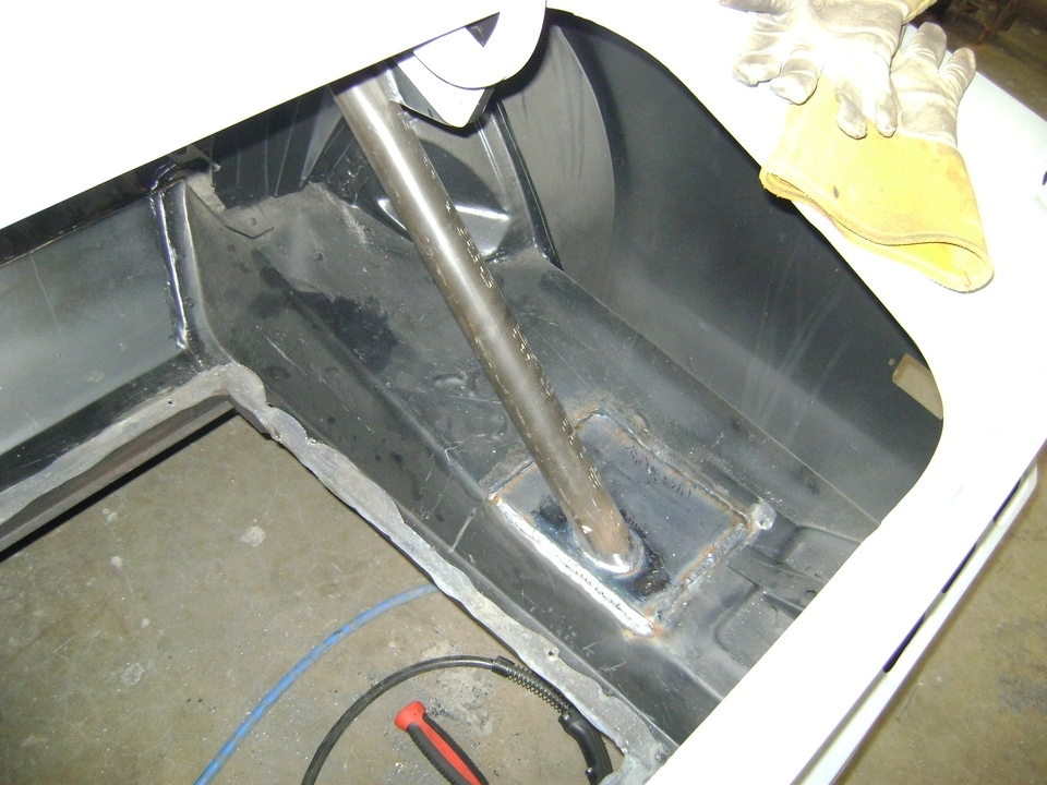

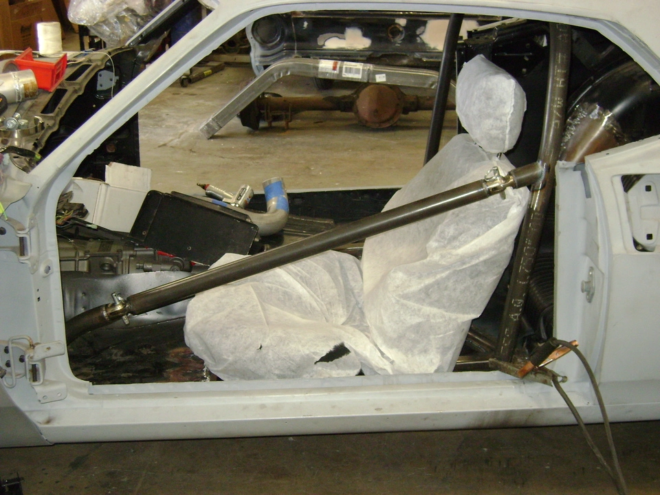

  13. That looks like some pretty thin metal that is bolted to the shock towers--do you think it will be strong enough to do the job of keeping the towers in place?
    I have an export brace from a no-name manufactuer that is almost identical to this one, but the plates at the rear and on the shock towers are probably either 18-ga or at best, 16-ga steel; I'm going to redo them with 1/4" flat stock so that they'll actually keep those shock towers where they're supposed to be before trying to install it onto mine . . .
  14. Ohhh, god no. It's not that thin. If it was, It woulda been thrown away lol. When the engine comes back out it will get a little more bracing on that piece, and the underside of the pinch welds on that cowl.

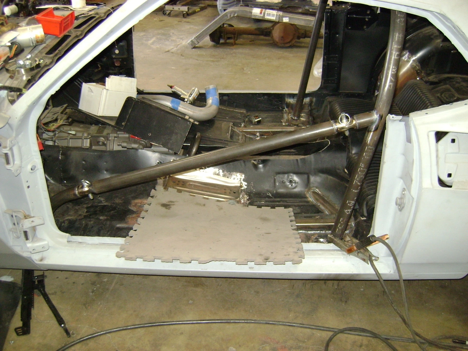

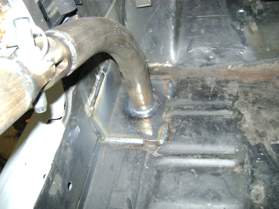

  18. Alright, got the brackets done, everything mocked, and fits, barely. Talk about a tight fit. The MC for the clutch BARELY fits. Talk about 10 lbs in a 5lb bag.
