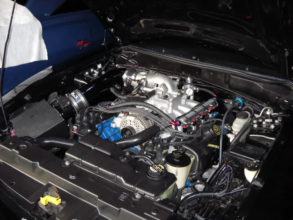

  6. thanks for the install pictures 98COBRA281 , they do look awesome on your car , wish my engine bay would look this clean , id be cruising without a hood on :)
    and 04GTBLKVERT ill be putting mine this friday , ill update thread with pics.

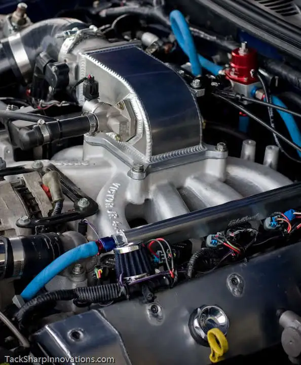

  11. thanks man, it made 320rwhp@ 6k where the cams peaked, and ran out of fuel, with the big cams, and the extra 1000 rpm, it should be a great combo with the manifold, im also going to order the 6061.com upper plenuim, so that should help some too!
  12. If you dont mind me asking cobra what are you "goals"?
  13. That will look killer! How much do those plenums cost?

  17. That plenum w/the welding bead looks Gourgeuos:drool:,

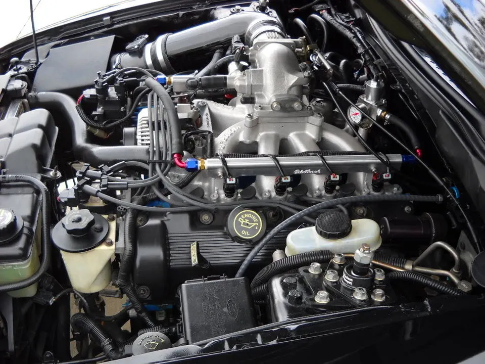

  18. alittle update with the plate and Rails in place :)
  19. Looks good, I was going to get my done but I didn't know you need an adapter for the plenum so I just order it..
