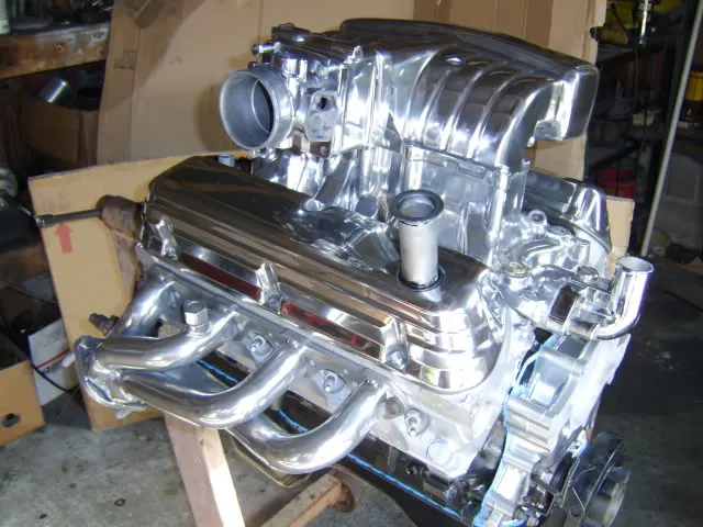

  5. Oh, yeah didn't see the ceramic part lol. At my old job we'd turn the oven up as high as it'd go for ceramic and cure it about an hour. The oven would go to 450 and that would do it. No failures yet on headers that have been in service for a few years now, including my own! I hear you on the resiliant part though, the luster of my polished ceramic headers has dulled pretty badly now, but I can polish them back pretty easily! this is what they looked like when they were fresh though:
    Ceramic is the closest thing to polished aluminum I have found, but it is VERY insulating so we don't wanna coat any temp sensitive parts with that stuff!!

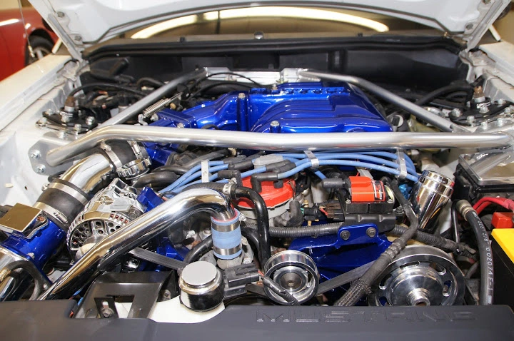

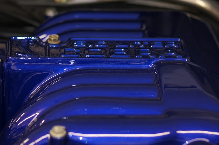

  6. I wouldn't mind more shots of this, I love that blue and if I leave my car white I may do something similar! Those look like candy blues.
  7. Uh, with all do respect...YOUR engine is pretty sick man. I wouldn't change anything.
    Yeah it's a candy blue. I have a white car with blue racing stripes. So the blue picks up the engine compartment.

  11. Looks clean! Wish mine was cleaner but with all the miles on it I would need to pull the motor and clean everything. What is that black pipe and hose coming up behind the middle idler pulley? My 95 does not have that.
  12. That black hose is part of the Cobra's unique coolant piping I believe.
  13. You are correct. 94-95 Cobras have a factory oil cooler; it routes coolant through that black metal pipe down to the adapter bolted to the block. I think I have photos of it from my Cobra clone build, I can post them if you want.
