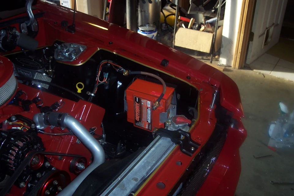

    It was like looking for the Arc of the Covenant trying to find this thread, it was so buried. But I finally found it in the back corner. Section E, building 437, Corridor 19, shelf 7, space 213.:doh:
    It's 76 degrees here in Birmingham today. All thoughts of power adders took a back seat to the inevitability of 98 degree days soon enough.
    I decided to unbox the rear mount A/C unit and put the evaporator in and cut the (is it a package tray,...or a hat rack?) for the air intake.
    The first thing I had to do however was to relocate the trunk mounted battery forward. The A/C replaced my hoopty 10" sub/amp combo that was back there and forced me to re-think the sub situation. I think I'm gonna put it where the battery used to be behind the left rear tire, so like I said, the battery had to move up front ( That's probably a switch around here huh,.... somebody actually moving a battery to the front of the car)
    For those that don't know, that is an Odyssey dry cell. It don't give a rats red bunion hole how it's mounted, so to save space, I turned it up on end.
    After all of that junk got done I moved on to the Evap. This system is a Vintage air piece that is actually intended for a street rod, but if we keep it down,....maybe my car won't hear us. ( Cause if I was my car, I'd be offended at the notion I'm sporting some stodgy A/C system typically found in some 37 packard street rod)
    Officially, the reason I'm trunk mounting an A/C system is to keep A/C lines out of my firewall (why,....because I think they look like ass. [​IMG]) The other reason was I'd have to blow the charge to even get a valve cover off the engine. So,......now you know.

    Question though. What's with the holy angle? :shrug:
    Oh... and did you know that your battery is mounted sideways?
