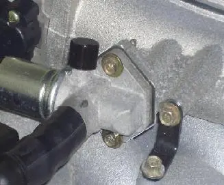

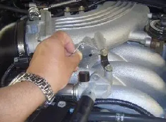

magnum347 said:
These are two pictures of the 1st plate I put in my Bullitt. Same as the GT because your IAC is in the same area. Upper intake.
