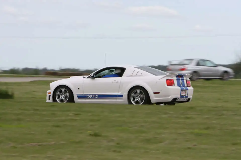

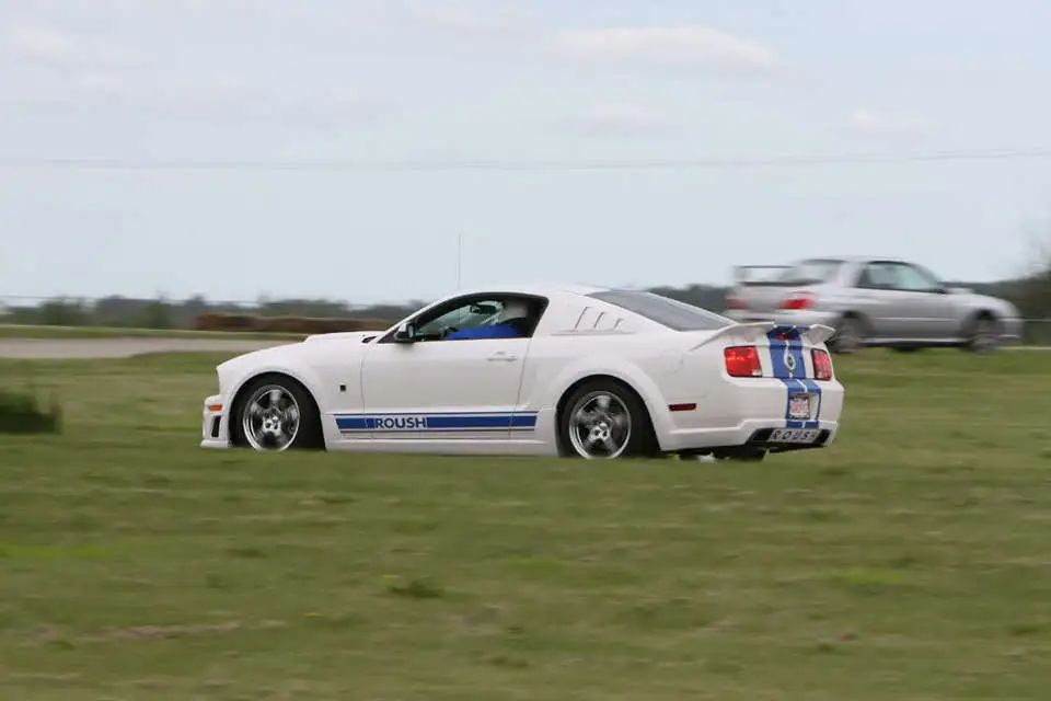

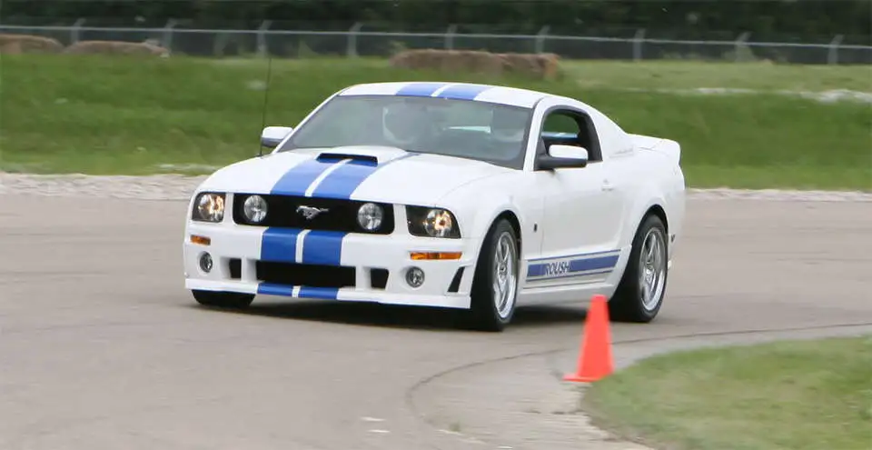

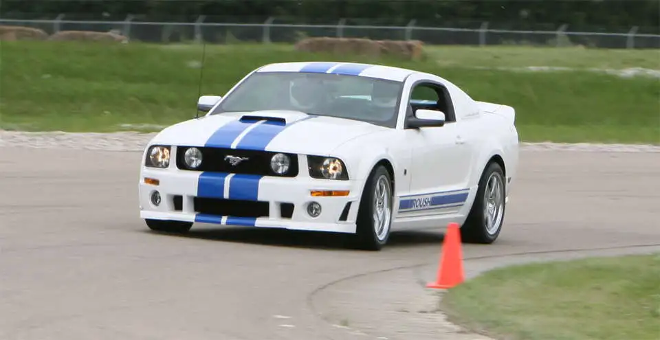

I took the car to Hallet this weekend for some road racing and found out three things. 1) My cars ability exceeds the skill of its driver. 2) 115 degree asphalt + BFG KDW tires + 4000 lb car at limit of lateral traction for 15 min straight = big melted tread blocks that look like they were first melted with a blow torch and then not so gently rubbed with a cheese grader. 3) At these kinds of lateral G forces my fat butt is hard to hold in a mostly unbolstered seat. Does anyone know where I can get a harness bar? I tried Sparco but they only list one for the 99 to 04's. I've GOT to get some better seats and a 6 point harness.

car looks good going down the track!
