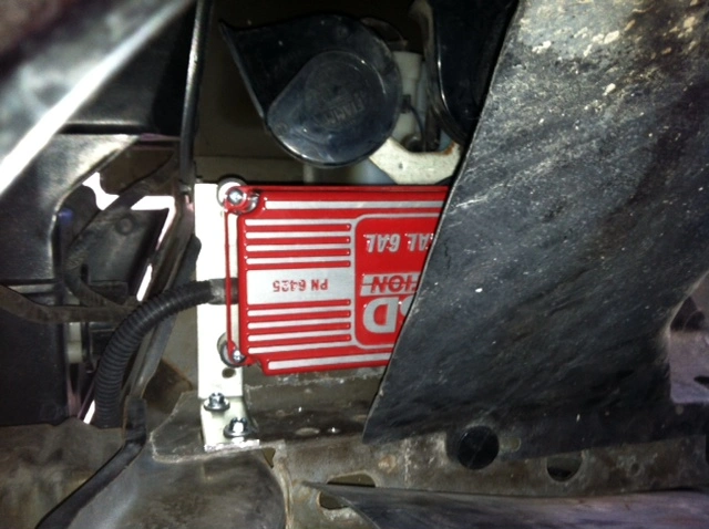

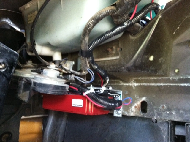

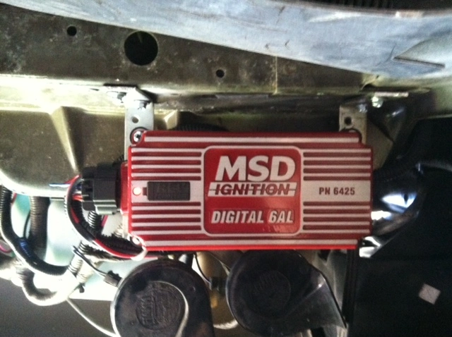

    Installed the MSD today. I mounted it underneath the windshield washer pump with a couple of L-brackets and some self-tapping screws. Unless you know what you are looking for, you can't even tell it is on there.

    Are you not worried about it getting wet?

    That is what the tuner recommended. Plus, I was able to buy it brand new for under $200.
    Not at all. The car is only driven when the weather is nice and sits in the garage the rest of the time. If it was my daily driver then I would have been a little more concerned about it.

    By the way, the MSD took care of the misfire problem without having to regap the plugs. It pulls hard all the way to redline now.
