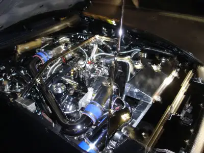

    hi, i have quite a bit of polished parts under the hood too, i found that california custom makes a product called purple metal polish which you can order from California Custom Products Inc. - Waxes & Polishes for Automotive Finishes and it works on aluminum, brass, copper , chrome, silver, stainless, and it removes blueing from pipes and headers as well. plus there is also a product called wenol which is awesome as well. everything on my engine has been done by hand by my roommate and he does the work for himself as well and his car constant show winner, pic below. anywho good luck.
    [IMG]
