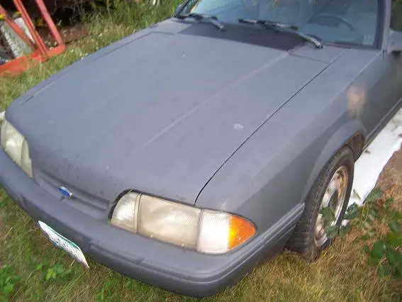

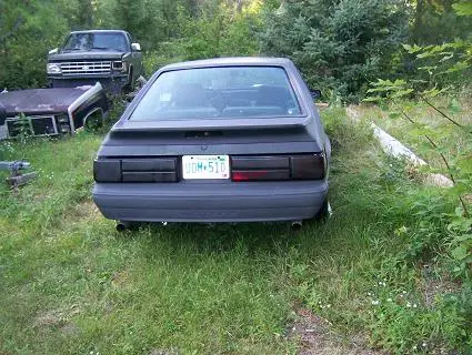

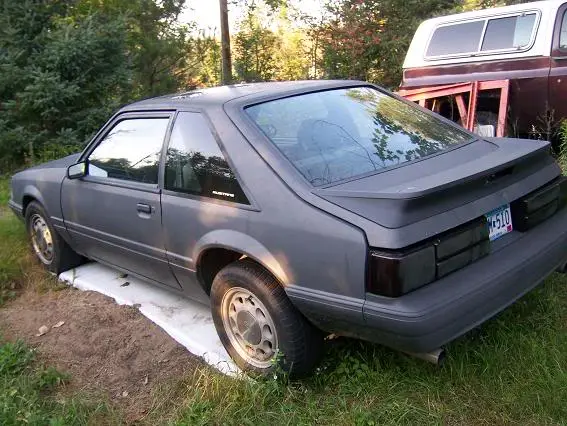

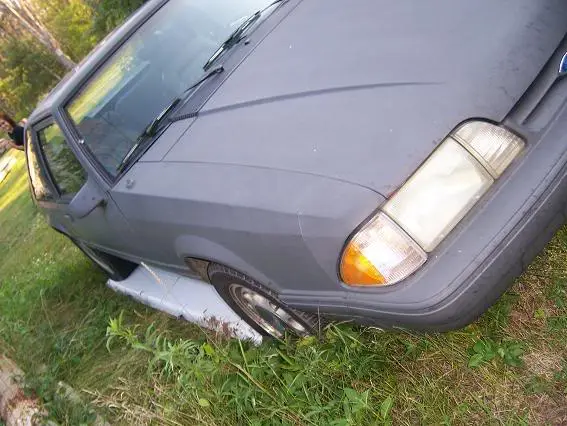

Hey, just signed up as I just bought a project 92 Fox LX to work on. I'll have pics up later to see it. Also, I'm Brian looking forward to finding a lot of tips on here to build her up!
Here are pics of the car! I forgot to say this will be my 3rd Foxbody, so yes I'm addicted!:D
Some things done to the car
no too shabby. looks straight. anything done to it?
As far as I was told, it has 3.73 with a off road H-Pipe and Cat-Back (said he wasn't sure on the brand) and 36 lb Injectors and 130 lph Fuel Pump with stock Mass Air Meter. That's the first thing I'm going to upgrade is that. Then I need to figure out why the headlights don't work, I hit the switch the parking lights are on but not the Headlights.
That'll be my next issue to resolve.
