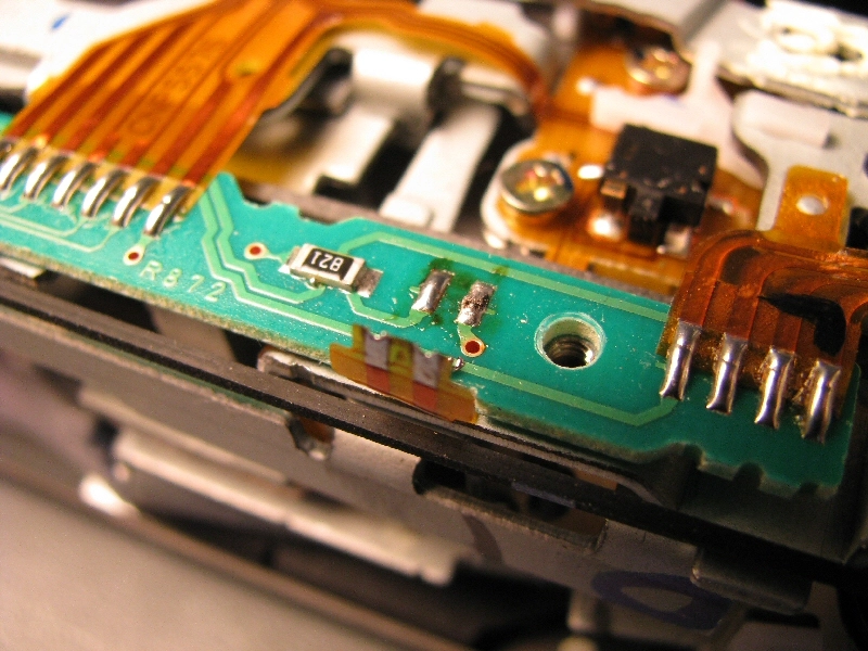

  12. Good stuff! I do not understand why that board had to be de-soldered? It does not look like it is impeding the removal of the belt...
  13. The board itself is held in place by two tiny screws. It has several flexible printed circuits (FPCs) soldered directly to it. In the pic you can see one leaving off the right and a couple of larger ones leaving off the back. The problem is that there's one -- a two-trace deal -- leaving off the front. Here's a pic:
    In this pic I've already desoldered the two-trace guy. He must be desoldered to tilt the board up and back to clear the way to remove the belt.
