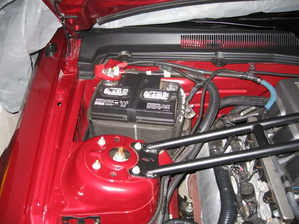

    I an attest to the fact that mice love that battery blanket. I used some poison in the garage to get rid of them, but if you are having a problem outside then you might want to remove the blanket.
    [IMG]
