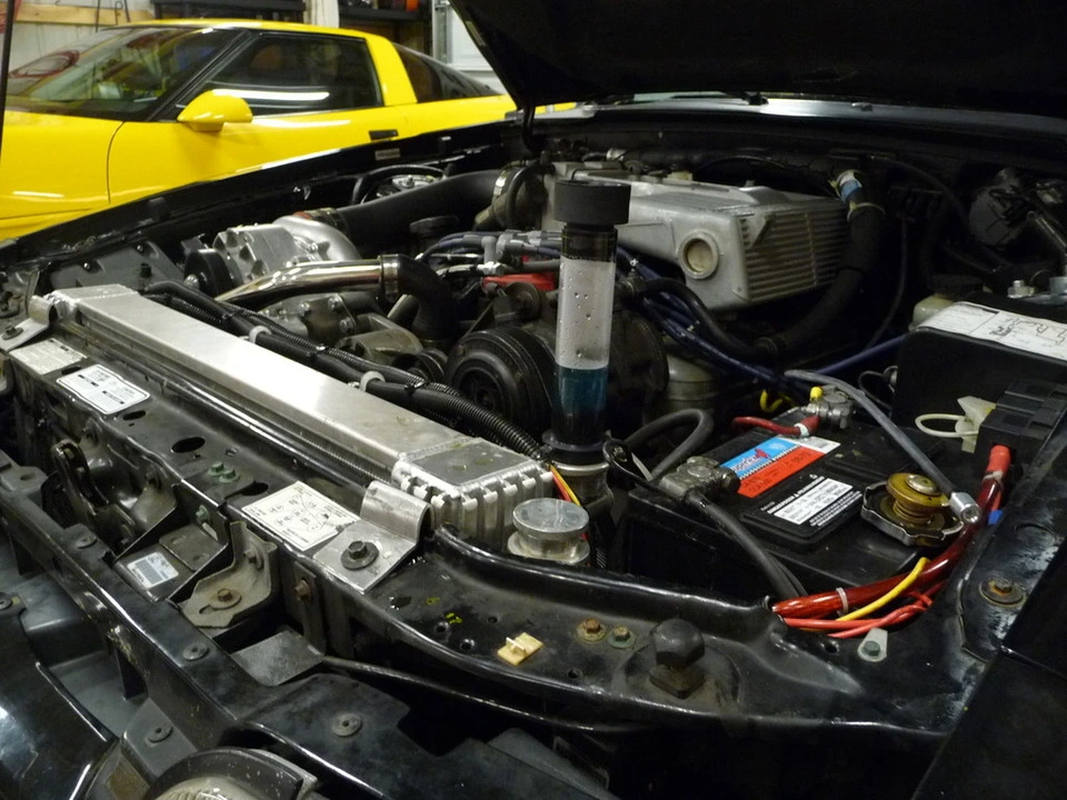

Completed the test for combustion products in the coolant. It passed. The instructions say to bubble through the fluid for 2 minutes. Well, I did it for 4 minutes and the test fluid remained blue indicating no combustion products in coolant. Is it possible to pass this test and still have a problem with head gasket leak only under boost?
Next is compression test.

you need to make certain the engine is up to operating temperature and there is enough of an air space on top of the radiator. It is certainly possible that the HG is bad but the test is not showing exhaust gast in the coolant. Have you done a compression or leak down test? That will tell you for sure.

Test the test fluid. I was doing the test and it wasn't changing colors. I put some in a medicine cup, and held it by the exhaust pipe it stayed blue. The fluid has a shelf life of two years. I guess my test kit I bought had been sitting on the self awhile. With new working fluid it turned yellow on me pretty quick, Ill be pulling the heads this weekend. Ughhh
