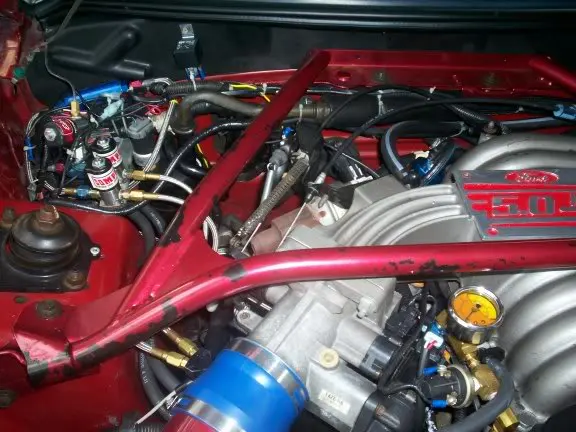

you will have alot of opinions here but i think the wet kit is the best when properly installed and safer than a dry kit...and to properly install requires in my opinion a filter #1 never run without a filter most kits come with a filter,a purge solenoid and tube some kits come with solenoid and tube and some don't you need to check before buying system,a window switch which will activate nitrous at 3000 rpm's and turn it off at 5800 rpms,a wide open throttle switch that will allow nitrous to activate only at wide open throttle,a fuel pressure cut off switch (adjustable) set at approx 33 psi this will turn nitrous system off if fuel pressure goes below 33 psi and a fuel pressure guage mine is permanetly installed,a bottle warmer with an automatic cutoff pressure switch set at 1050 psi and a pressure guage...all these items need to be wired in with relays i have all this equipment on my system wired in with 2 relays two switches and a push button switch (heater switch and nitrous arm switch and a purge push button switch).it can get expensive. but in my opinion this is what you need to run a nitrous kit safely and efficiently..and in my research before i bought my compucar system i found that only two nitrous companys carry a lifetime warranty that is compucar and nitrous express this is very important when considering a system to buy i bought mine used and i contacted compucar and they informed me that the warranty follows the system from buyer to buyer and that if i have any problems they would replace or repair free of charge if i paid actual shipping costs.
Holy wires and solenoids batman!
