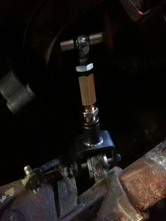

Reinstalled the rear end yesterday and torqued down all the bolts today and put the sway bar and calipers back on. I came to one brake line fitting that runs off the housing and connects straight up to a brake line that runs along the bottom of the car that will not re connect. It came off fine but now it will not thread back in.
This is the bolt and the block that it connects to ( to the left of the UCA)
This is from laying on my back to see where the fitting connects to
I remember that one from my Cobra conversion. Memory says it was a PITA to get the threads started, so you're not going crazy. No special advice except to keep trying and as always, be careful about cross-threading. Also don't forget to replace the crush washers. While you might be able to re-use them, they're cheap enough that I wouldn't risk it.
I never had a problem screwing that up. The threads could be boogered up though. Connect the end of the line that is harder to connect first. Instead of hunting around for new crush washers, you can hit the old ones with a torch real quick to anneal the metal. Makes them good as new.
Kurt
I'll give it another shot today when I get home. If I cant get it in what should I do next? Could I run a tap through the fitting just to clean the threads up if they are messed up? If it wont screw in it seems like the only reason it wouldn't.
got it back in, what an f'ing pain in the ass that was. Was really starting to think I stripped it but right on the verge of giving up the threads grabbed and it went back in. So short of having the rear end fluid in the differential , the rear end is fully installed.....
