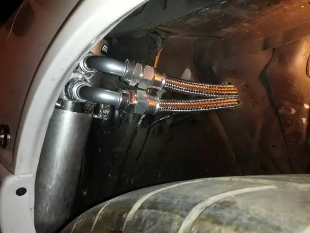

  3. mines similar except I tucked the can back in pretty far.
    #523 madspeed, Apr 1, 2014

  4. What's the idea behind the breather on the catch can? Shouldn't an operable PCV system be sealed?
  5. My system is not hooked to a vacuum source it's just venting the gases not pulling when it was pulling through the valve I was getting oil little bit but still oil.. Yes i have the little screen and the valve was operational
  6. Mine is in all actuality as far back as I could go on that flat surface that is there on the passenger side
  7. That im guessing is far from hitting the tire right?...lol...is this over the black wheel well cover? or behind it?....
  8. Uhm I don't have a wheel well cover lol and like I said if I see the tire rub it I will swap the straights for a set of 45? Fittings

  10. Ohhhh i still do...guess i cant use that area...lol
  11. You probably can it's pretty far back behind there
  12. Ok i will take a look today when i get home Thanks!!!!!
  13. Now being that your boosted I'm not entirely too sure if you have to do anything different I personally wouldn't think you need to but @madspeed could help since he is turbo as well
