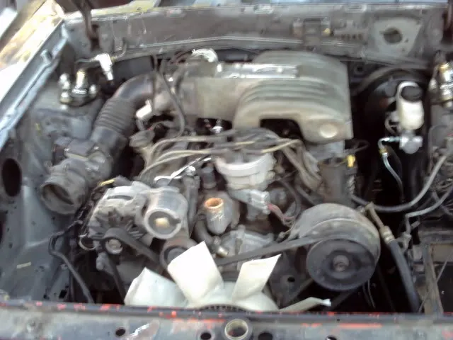

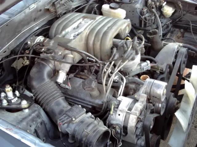

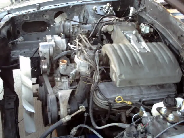

  2. Engine is in, ran out of time installing stuff so i didnt get it started but i did get pressure to the fuel system, anywho less talking more pics

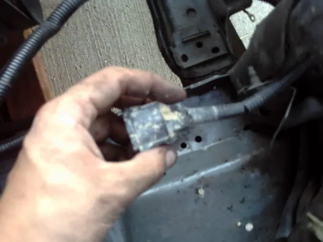

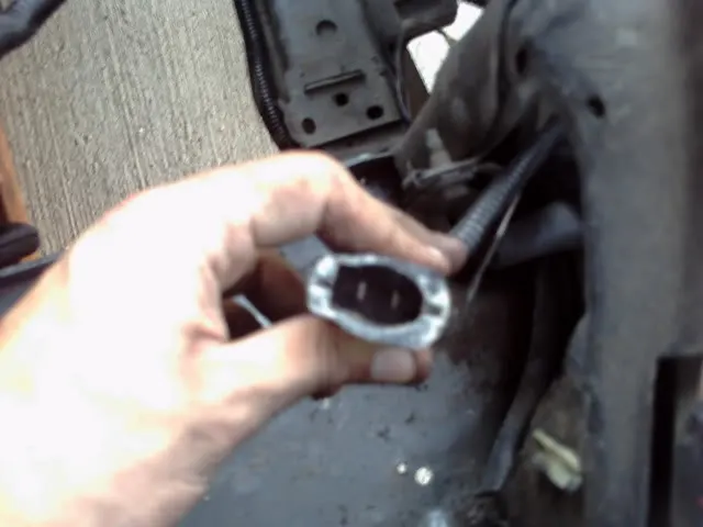

    also anyone have any idea with these ****ers go?
  3. ah, ****en, what about the hose on the underside of the intake?

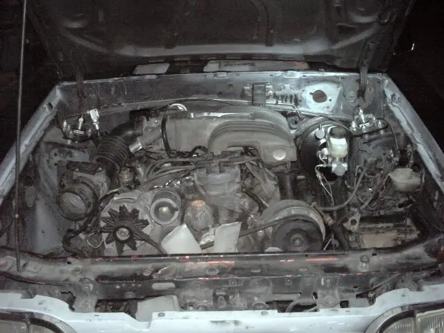

  4. SHE LIVES, played out phrase i know but im just excited i got to fire her up tonight, no real pictures, now i just need to install the clutch cable, radiator and clean up some wiring, and i'll be able to drive her onto the trailer to have the subframes and TA tabs welded on, hopefully by the end of the month she'll be drivable

  11. Frontside?
    Goes to charcoal canister
  12. ah ok, well i guess i gotta put that back in
  13. :lol: Me too and I dont even have a stang right now! :rlaugh:
    As to the hose, is it the vaccume hose that goes to the tree and/or brake booster?
  14. no that one is currently hooked up already, and you need to fix that not having a stang issue

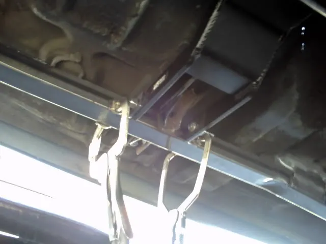

  18. alright i was up bright and early at 6am today to start on the car camera weirded out on me so i only got these few pics of the install

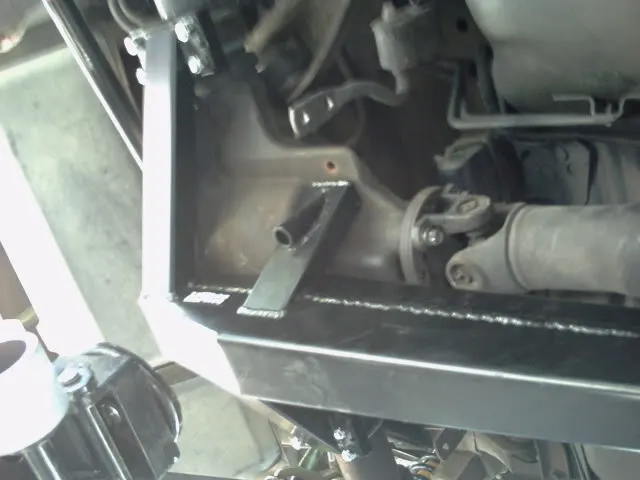

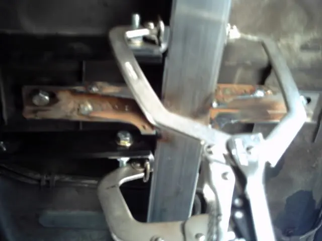

    Subframes welded up and torque arm tabs welded on, wind starting picking up so we couldnt complete the welds fully, and since my instructor was the one helping me with the welds and he lives 35 miles away i gotta take it to the local muffler shop to finish the welds on the front of the subframes and have the h pipe and u bends for the mufflers modded to fit the additional crossmember for the torque arm, well here are the pics
  19. Man that thing looks like it just destroys your ground clerance.
