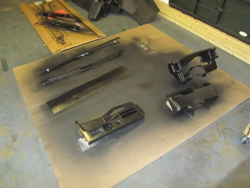

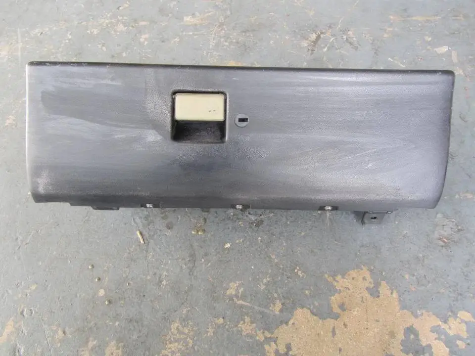

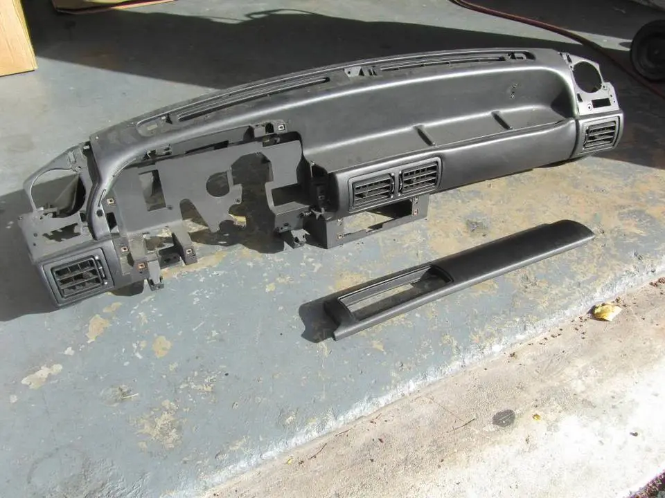

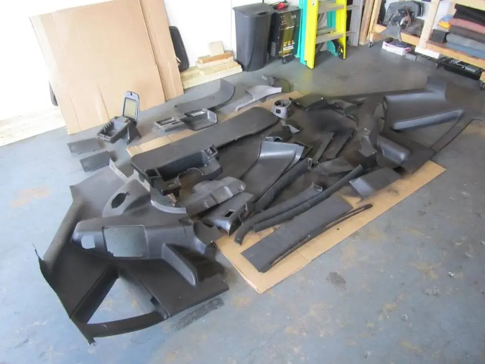

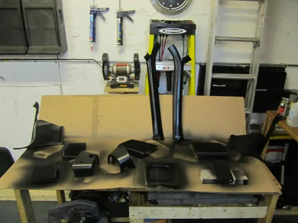

  15. Interior progress
    Very happy with the prep & dye outcome. New material and process has resulted in a good finish, and light sheen.
    [​IMG]
    [​IMG]
    [​IMG]
    Working on the rear quarter panel liners now, speaker grilles, and the headliner.

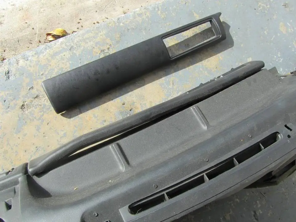

    Door panels are in rough shape, so we opted for new ones from the guys at Late Model Resto
    The old: Water damage and warpage.
    [​IMG]
    [​IMG]

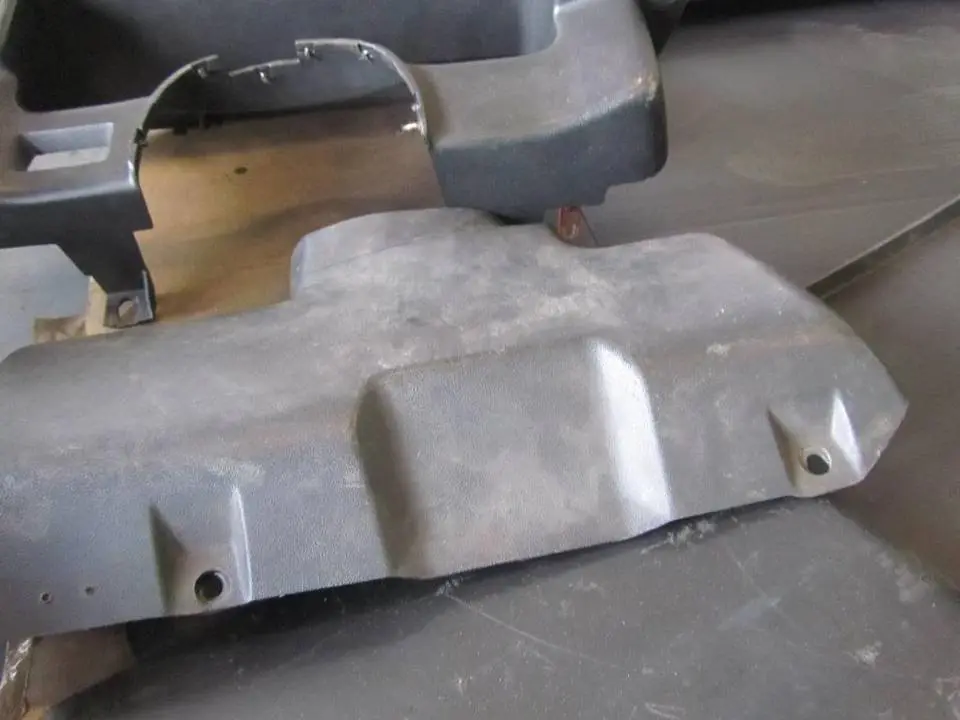

    Even the door panel pads are dismal. Custom work commencing
    [​IMG]
    [​IMG]

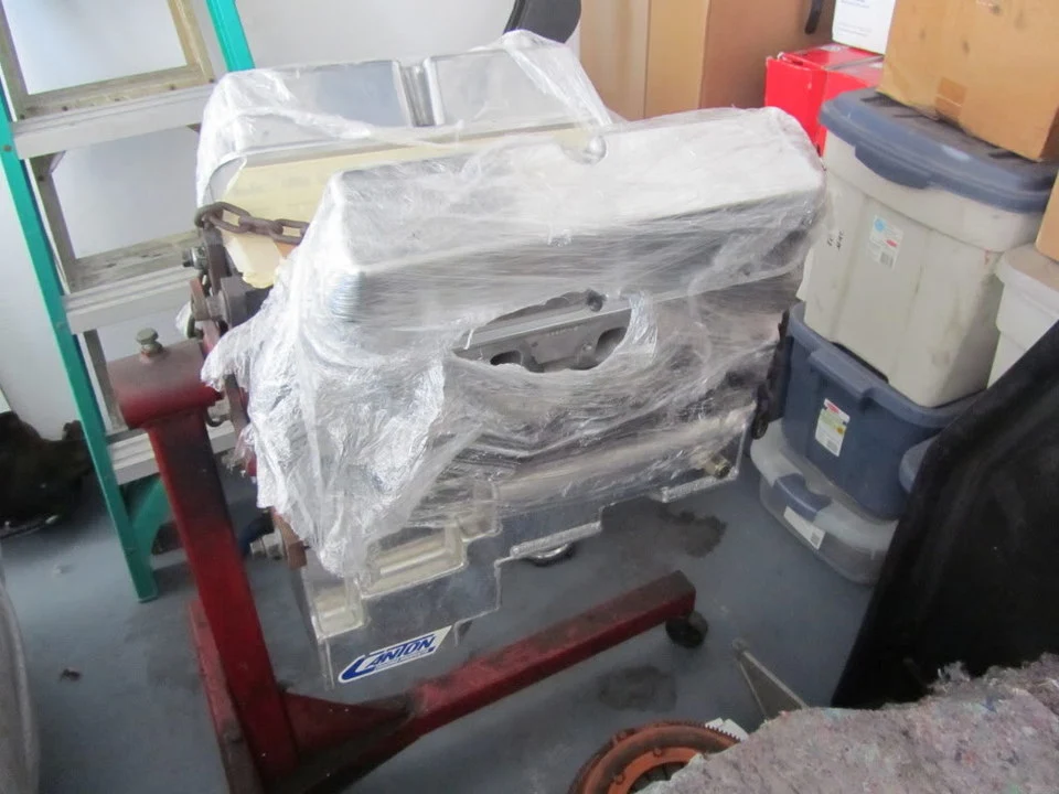

  16. Also motor has been gone through and wrapped up until time to install

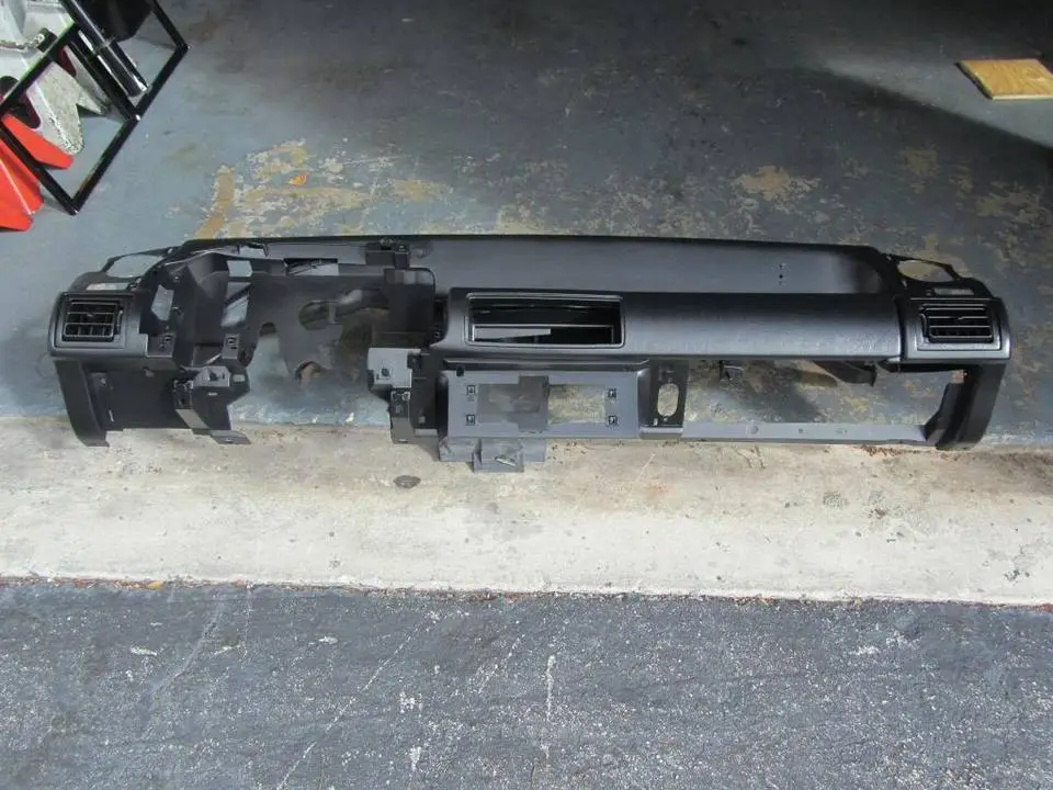

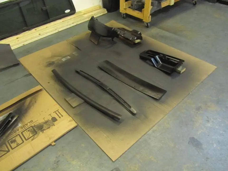

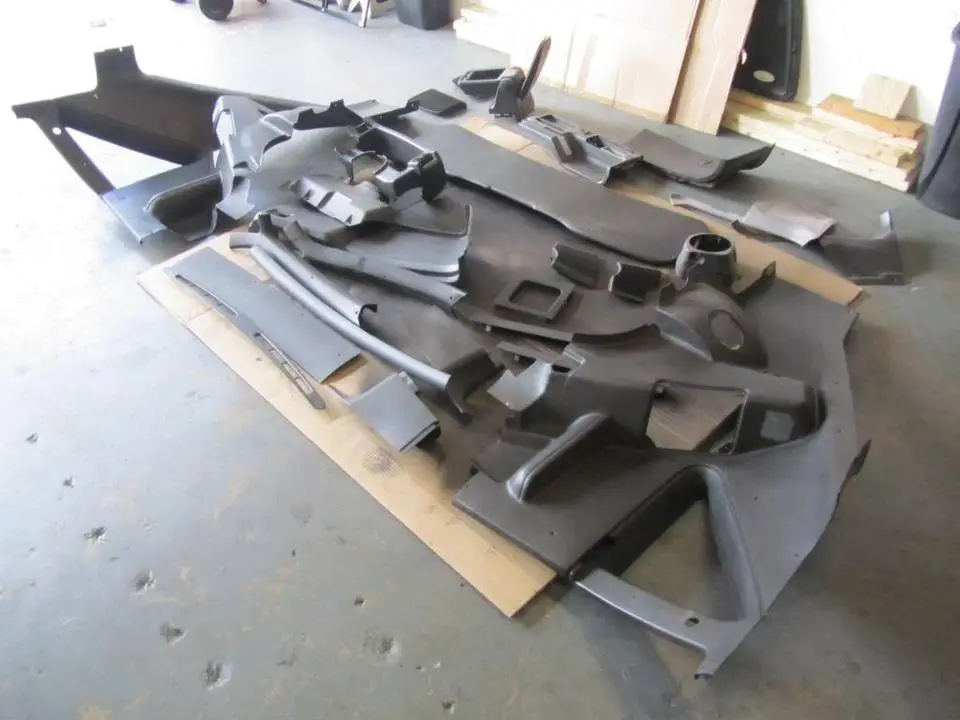

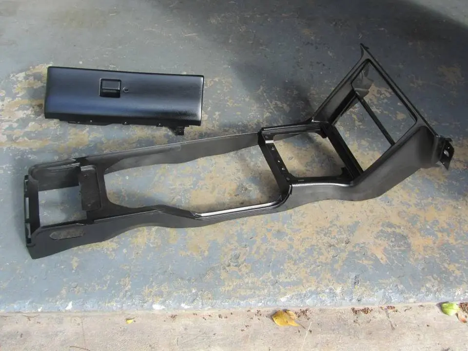

  17. More trim work, prep and dye
    Thats a lot of black!
    After
