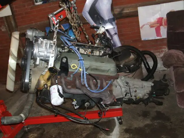

Yeah guys I didnt want to f around pulling crap apart to get the engine out so i did indeed jack the car up to begin the pull then when i had it partially out, I lowered the jack and then it just slid right out. Yepper, thats tomb raider in the back. She wasnt much help though
