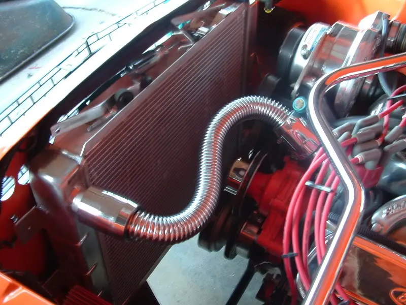

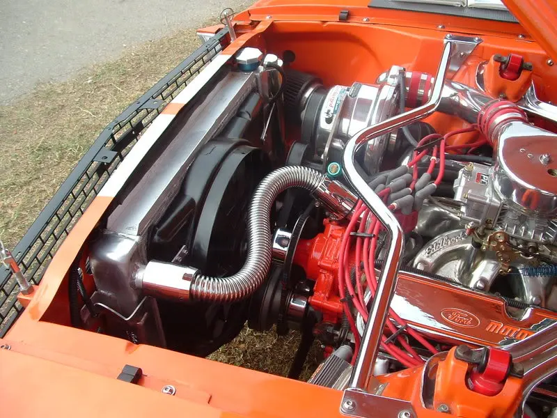

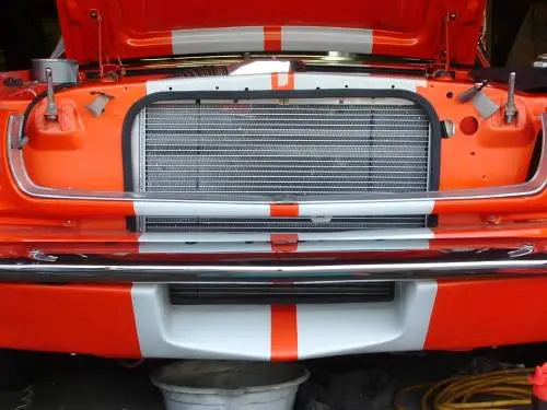

    hats what I did on mine.I put a 22" wide universal from Summit that goes frame rail to frame rail.Makes a big difference in fin surface area.
  7. on the 22" wide radiator was it the same height as the stock one?
  8. yes, the radiator cap sits under the upper lip of the support
