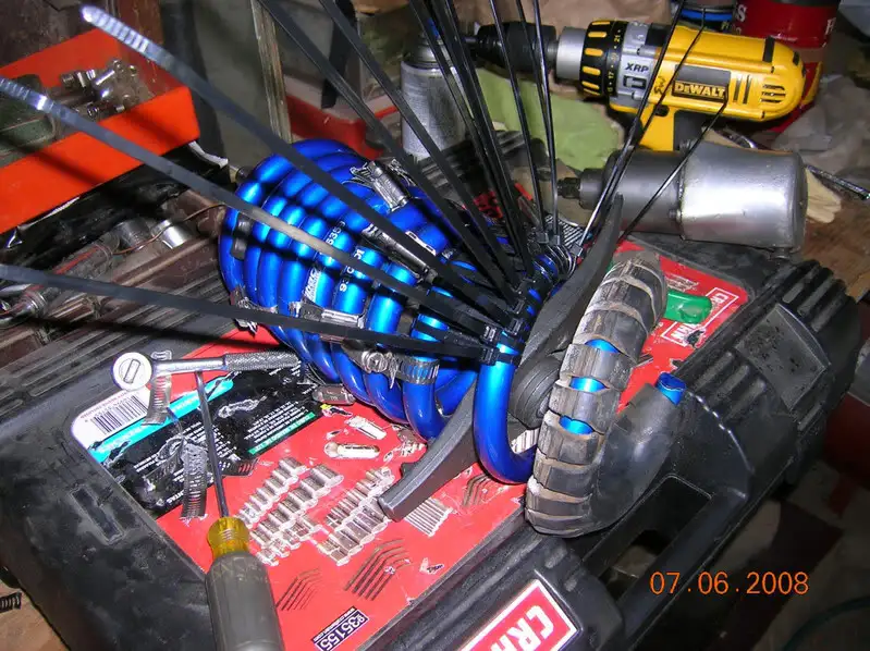

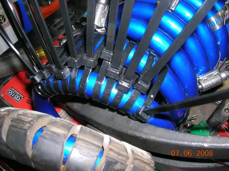

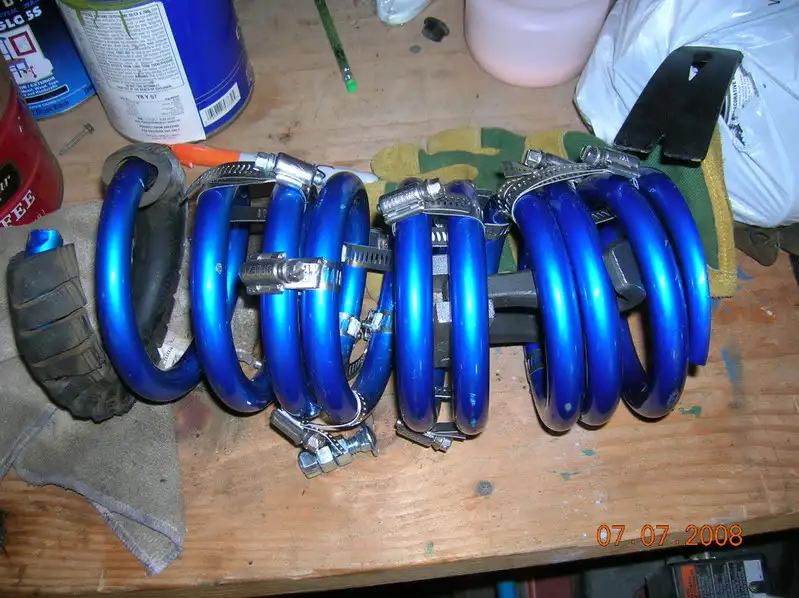

  1. I just did the same thing on my car with the springs, I rented the strut style spring compressors. I took a impact gun and compressed on side of the spring, then compressed the other side. I bought some hose clamps, I made sure they were stainless steel. I put 2 clamps on each side of the spring, took off the compressors, sat the spring in place, jacked up the a-arm and put everything back together, worked like a charm and only took about 30 minutes :D
    May not have been the "correct" way, but it sure as hell worked :nice:

  7. Heres where your method and mine differ. Because i install the spring in the control arm, then i jack the control arm to attach the spindle to the strut. Then i cut the hose clamps off. Your method works as well, but i think the spring could jump out at you, atleast the way your doing it. If you just compress the spring enough you'll be able to do it easier that way. Good luck. Glad my method works good though!

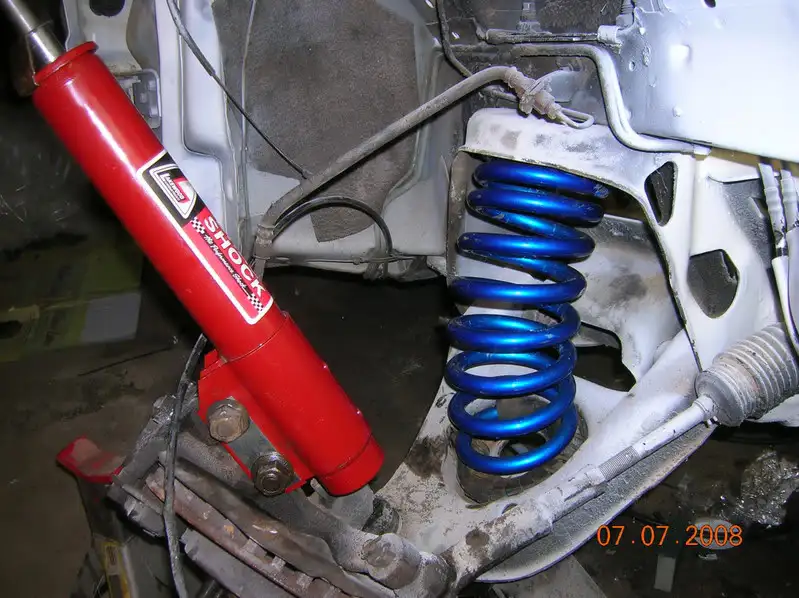

  15. I always support the lower control arm with a jack, lower the control arm and get the sping out, I always have to take the jack completely out from under the control arm, tie it with a chain or good rope if you are afraid of it flying out. Always stay to the side when you are lowering the jack. I have never compressed one to take it out.
  16. dude its easy as hell and safe, especially with stock springs. i just jacked the car up, unbolted the strut, let the a-arm down as far as i could with the jack, put a ratchet strap on the spring to keep it from coming out, then put a long peice of metal into the bottom of the spring and pried it out. all it does is go "dunk" and your done. very easy, i did the second one without a ratchet strap because when the a-arms are down theres like no tension on the stock spring, i could turn it by hand but just not quite pull it out. easy as hell to get them out, back in is the problem. if you cant get the tools to fit the springs with them in the car, your prolly not gonna be able to use them to get springs back in... hose clamp method write up is a page back if you wanna try it. if i were you i would just take it to a shop, if your scared to pop stockers out of the a-arms, cutting hose clamps off a spring with enough potential energy stored in it to take your head off will make you **** yourself. i almost did, and im crazy according to all these guys in this thread lol.
