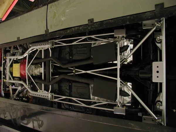

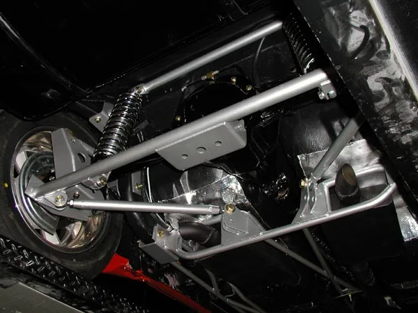

the satchell link is basically a triangulated 4 link with some adjustability, but with the mounting positions of the upper and lower bars reversed. this makes more room for packaging, in a car with really limited space it's a very good option. it also has the benefit of having a lower roll center tha most other options.
is it worth $4 grand? well i gues that would up the buyer and what he wants out of the car. you can similar performance fomr other systems. the hedits rear 4 link is a good option as is the TCP G-Bar rear system. a modified stock style leaf spring setup can work rather respectable as well but the ride quality won't be the same.

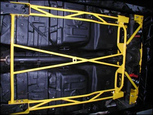

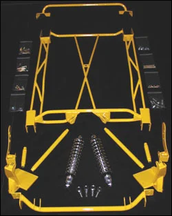

i think the satchell link is a good system but it may be a bit over priced. my money is going to go to the TCP G-Bar triangulated 4 bar, personally, mainly because it's available for my 69 cougar, plus it's about half the cost of the satchell link.
http://totalcontrolproducts.com/gBar.html
