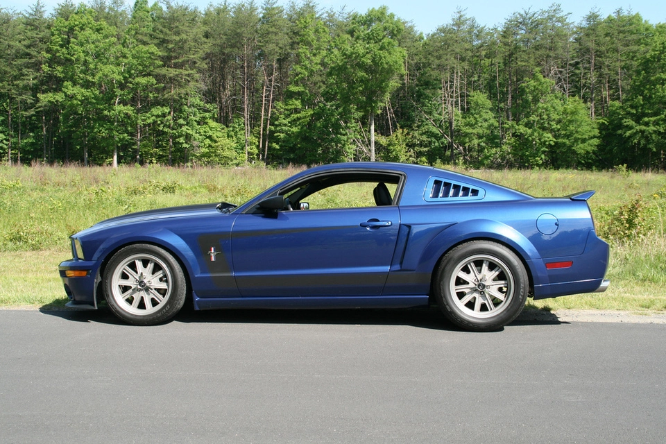

    I've heard several people say they want their Stang to sit level, but it does look odd when you stare at the tire/wheel gaps. These cars have a rake from the factory which I like as it reminds me of the older muscle cars:D I took mine to the extreme as I lowered mine .25" more in the front (1.75"/1.5") and then added the 2.2" taller tire in the back!
    [IMG]

    I think that looks amazing. I had come across another post of yours while doing my research, and you mentioned wanting to keep the rake. The car is designed to have a rake, and I think looks best when you keep it. Otherwise, your fender gaps are all off. I especially love the huge rear tire. It looks like the car has the power to lift up the front end when you really stomp it.
