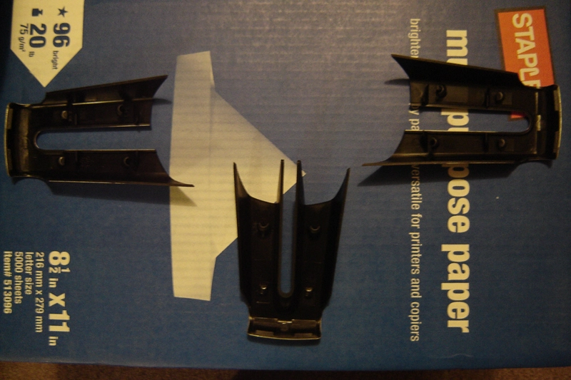

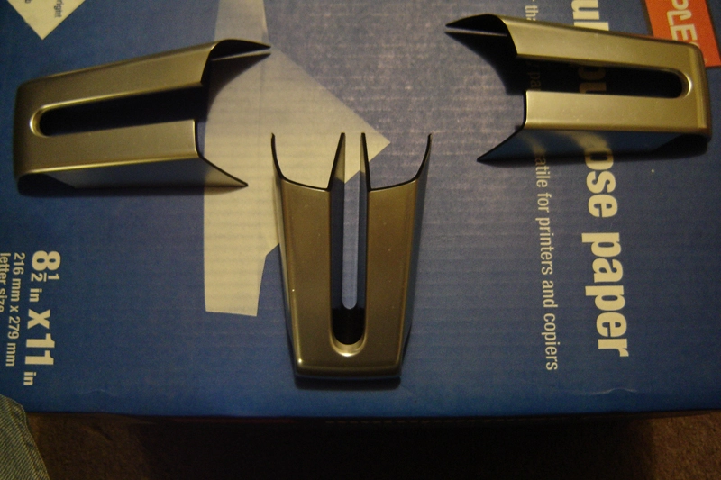

    Finally painted my inserts last night! I used the left over primer and black satin paint I used on my sub box, so I had no money tied up in this project. Actual labor time (remove, sand/scuff, clean, dry, prime (2 light coats) and paint (2 light coats) was about an hour. I allowed 30 minutes in between the coats of primer/paint (which was ok according to the directions on the cans:D I let them sit overnight for 8 hours before installing them this morning. It was still "misting" outside, so I didn't feel like using my Canon, but I wanted them back in and pics taken!
    Here is how it went:
    OEM and ready to get rid of that brushed aluminum look
    [IMG]
    Backside to show the compression clips
    [IMG]
    150 grit sand paper followed by 0000 steel wool, then rinsed and dried

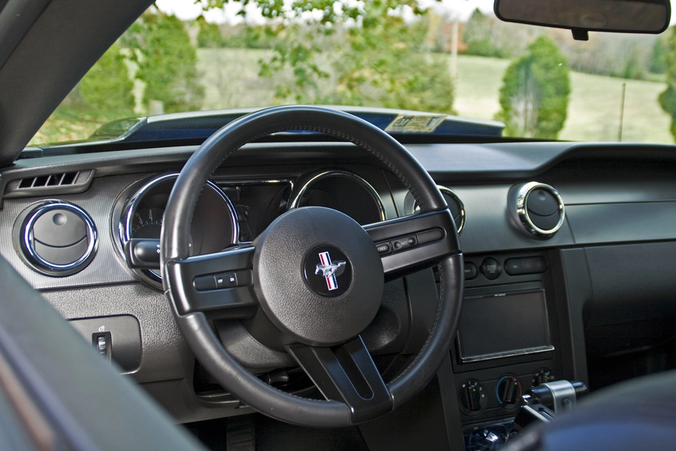

    Thanks, guys! The blueish color is the My Color feature of the Interior Upgrade Package.

    Here is a much better pic I took of the inserts.
