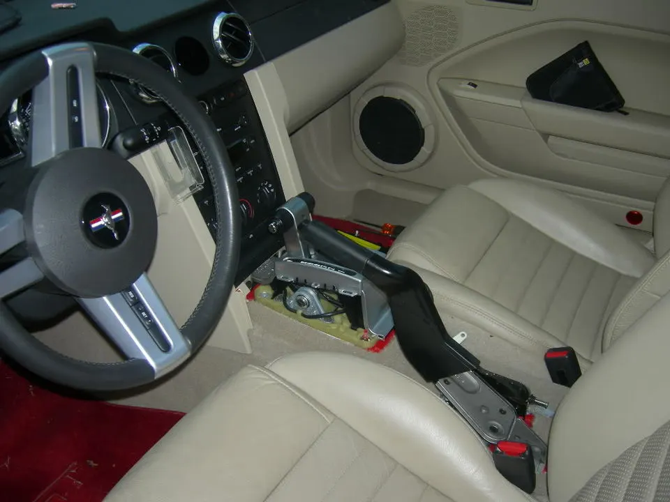

    I finally got my TCI Street Fighter shifter on Thursday and I got it installed Friday afternoon, with help from "kooldawg6".
    I already had the console out of the car, so it only took us about 45 minutes to do the actual install. The instructions that came with the shifter weren't all that explicit in some areas but I already printed two online tutorials that I got the links to here, and pages from the ford field repair manual.
    The only tricky part was the two little clips under the car that hold and attach the shifter cable. It's really hard to see and very little room for the hands, but Kooldawg figured it out and came through for me.
    Here's a couple of pics...
    Old Shifter
    [IMG]

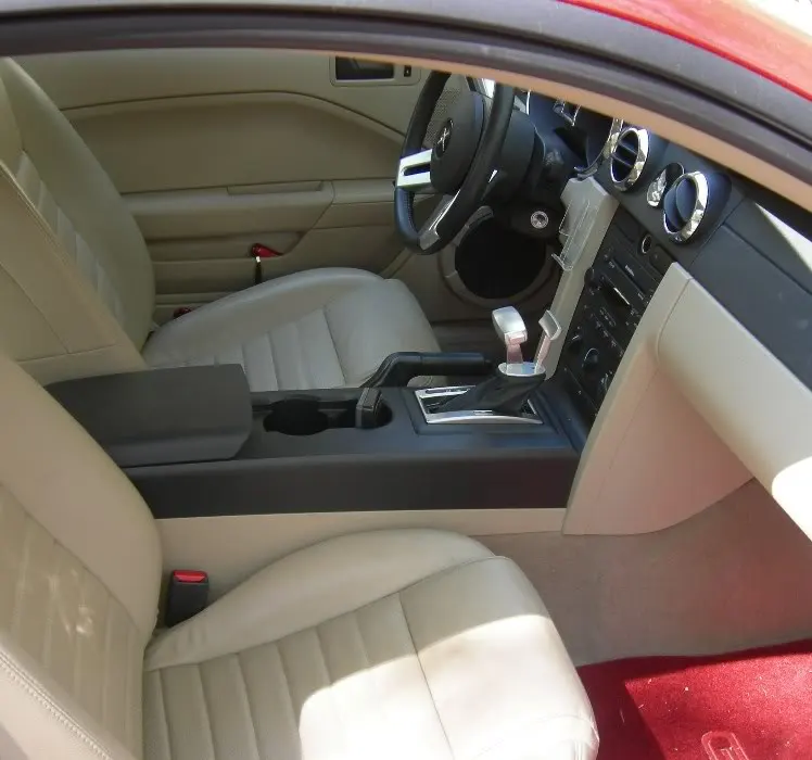

    New Shifter...
    <a href="http://s238.photobucket.com/albums/ff243/Casey4s/ZCAr/Shifter/?action=view&current=002.jpg" target="_blank"><img src="http://i238.photobucket.com/albums/ff243/Casey4s/ZCAr/Shifter/002.jpg" border="0" alt="Photobucket"></a>
    [IMG]
    Shifter works great... just as advertised...:D

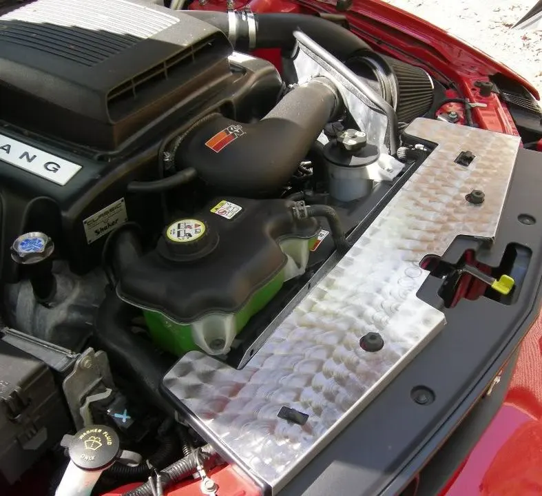

    Since I had some idle time I also installed a radiator cover to match my air box that I had recently done a "jewel" job to.

    Is that a black dash panel on your car? I'm jealous not too crazy about the ribbed aluminum look my car has.

    Yeah it's just the stock plain Black dash panel. I would like to have brushed Aluminum or Stainless, or the Silver carbon fiber.

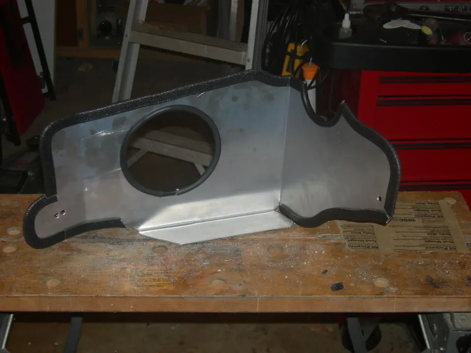

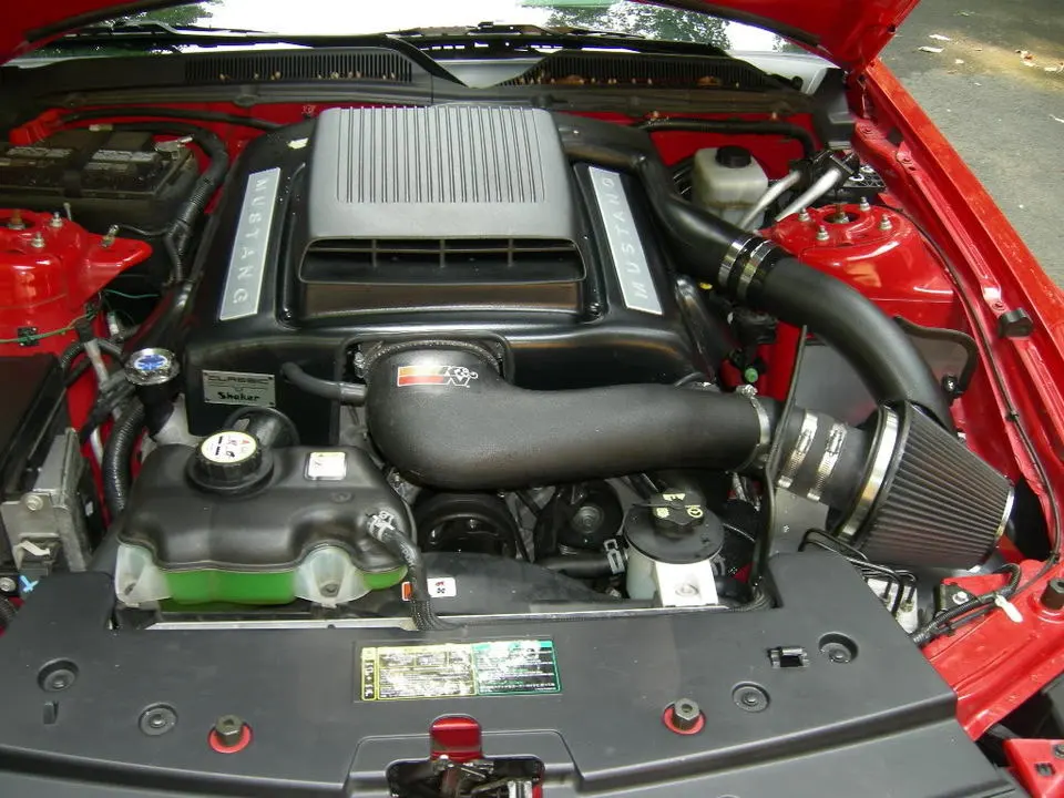

    That air box I had to build from scratch from Aluminum sheet to accomodate the Shaker forced cold air. The original K&N box just wouldn't work, and I wanted to make it more enclosed and put a bottom on it to block as much hot air as possible.
    Then last week I had to disassemble it and do the jewelling, polising, and reassemble. If I had it to do over I would do the jewelling just before I did the bending. The radiator cover is a Steeda Stainless Steel one, that I jewelled to match the air box. I have a stainless fuse box cover on order now that I am going to make match the other stuff.

    Glad to have helped out! Yeah the shifter cable sure was a tricky one! It wasn't until you got the flashlight under there that I could see the little push tab :( Once I saw that, it took no time! Then the other clip that holds the cable to the bracket was a chore as it was rather difficult to get to the top tab to release it. After several minutes it was out and didn't even break:D That sure is one nice looking shifter:nice:

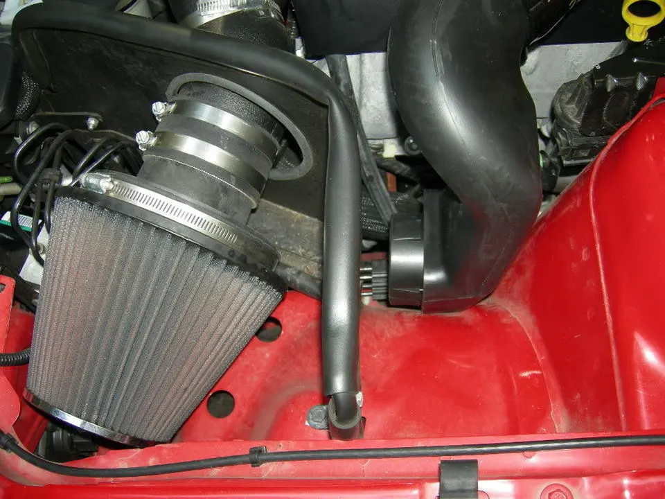

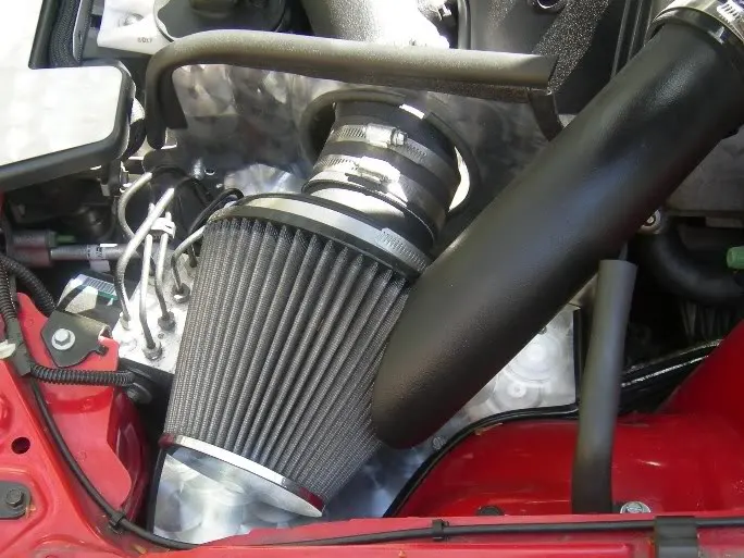

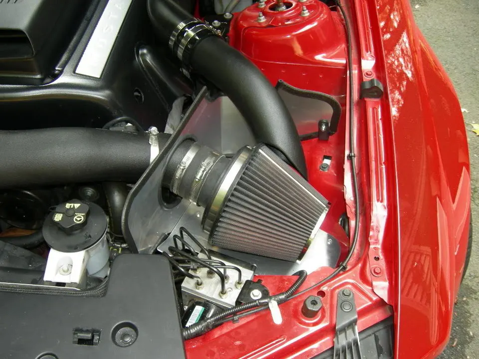

    What's that black tube coming off of the air filter?
  18. Casey4s New Member
    Member Since:
    Sep 2, 2007
    Message Count:
    236
    Likes Received:
    Trophy Points:
    Actually it's the cold air going into the filter from the CDC "Shaker" hood scoop. I already had a K&N CAI on the car when I installed the Shaker. The CDC set up would not work "as is" with the K&N air box because it was designed to go into the side of the stock Ford air box.
    This is the original K&N air box and the CDC original cold air tubing.

    This is the air box I fabricated to accept a cold air tube I fabricated out of conduit. This was the first version,
    later I cut the whole corner out of the box.
    [IMG]
    Here's the first rendition of the tube and air box
    [IMG]
    A better look at the way things look under the hood before the recent improvements the finish of the air box like it is in the photo you asked about.
    [IMG]
    I sent some pics to CDC and they thought it was an excellent solution to the K&N air box dilemma.
