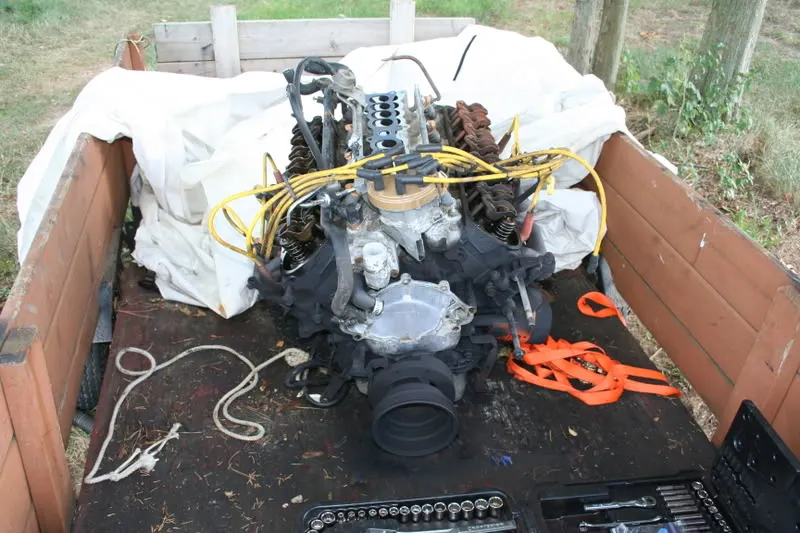

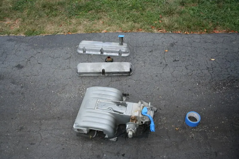

    I got the rear rims in, had them mounted and balanced. I also got a host of small misc pieces and spent the last week or two disassembling the engine, painting pieces, installing new valve cover gaskets, etc. In the next few days the new waterpump/thermostat combo will go in and i'll be bolting accessories back on.

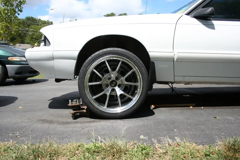

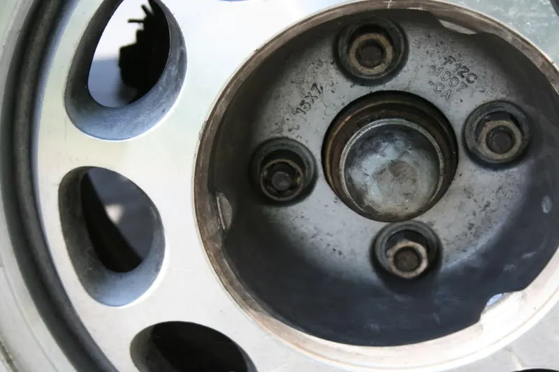

    Tomorrow's plan was to rip the whole front end apart and start the 5 lug swap on the front UNTIL i took the caps off the rims. When i did that i discovered these little beauties -
    [IMG]
    It was a huge letdown. I don't really know what to do. I don't want to go through all the time it will take to try and cut/grind/chisle them out and i don't know what to do. ANYONE please give me some ideas!!!!!!!!! I'll also post this over in the Tech section see if anyone has any ideas. Anywhoo on to some misc pics.

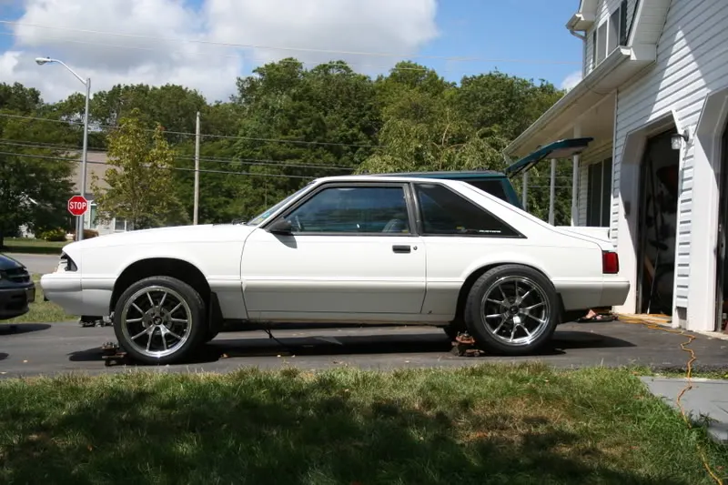

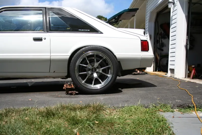

    [IMG]
    [IMG]
    [IMG]
    [IMG]
    [IMG]
    Thats all For now. I wish I didn't have the dumb lock on the front rims i bet i would have the front all together by tomorrow night. :(

    check with a ford dealer. I had the same problem with my car so I took it to a ford dealer and asked if they might have a key for the locks on my car. Turns out they did, they took them off for free and all I had to pay for was 4 lug nuts.

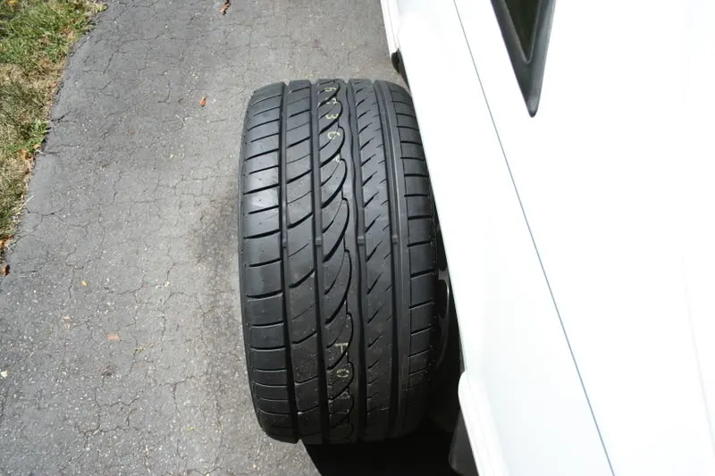

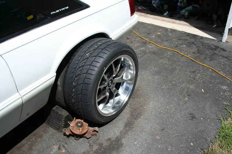

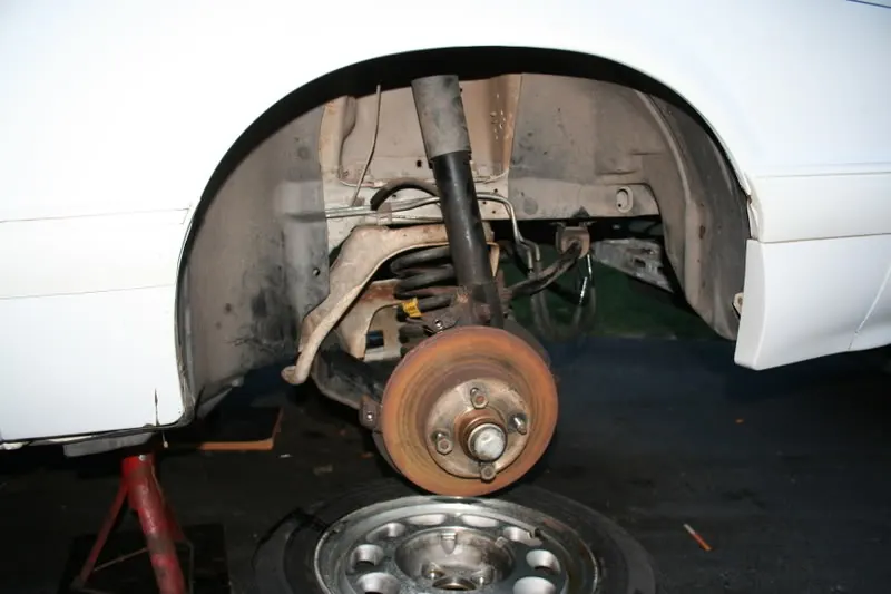

    Need to get lowering springs for the front, also it looks like the back spacing is a little too much, hell they stick out way past the fenders :shrug:
    Sure are some big cross drilled rotors you have! Never seen ones with holes that big! :eek:

    For the wheel locks, tack weld a socket to it and remove with a ratchet. Has worked for me great in the past.

    This is what i ended up doing minus the tack weld. I beat the socket onto the lug and got it off that way. I probably should have done it so i wouldn't ruin a socket but oh well!!

    I'll take some pics today of the front wheels and brakes that i took off.. Also pics of the engine going back together. I also got the new Waterpump on, valve covers and some accessories. My smog pump is seized. Even after taking it apart, i can't unseize it. Looks like i'll have to purchase new.. bummer! :(

    Get a tool designed to remove rounded bolts... We did it with some air on a friends car and they worked perfect... tough to find but I think we got one at sears.
    By the way PERFECT wheel choice, looks badass!

    13/16" 12 point socket does the trick. Thing is once i beat it on the lug, i can't get the lug out of the socket, thus its garbage!!
    Oh hey, check back a few pages, i took a pic of the e-brake for you, hopefully u can give me a heads up on where to put the spot weld :nice:
    Thanks, when i got the tires mounted, and rolled them next to the car i damn near fainted!! I love em!!! :)

    Theres no need to toss the socket.. Find a bolt that is wide enough, so it doesn't go through the lugnut, place the socket on couple pieces of wood or better on a vice and hit it the bolt with a hammer.

    Never thought about doing that. I can just stick it right back on the stud!!!!!!!
    now i gotta fish through the trash and find the two sockets i just tossed!!

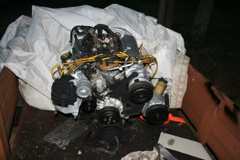

    More from the weekend...

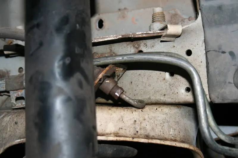

    I dont think i can get this fitting off.. What do you guys do to get brake fittings off of these older cars that have rusted over?

    For the brake fitting, WD40 the **** out of it, and grab the head of that with Vise Grips. The brake line wrenches always round them off. Vise grips work everytime!!! Can't wait to see the engine together!!:nice:
    BTW...The front does need lowering springs...Laser is right...it sits up really high!!!
