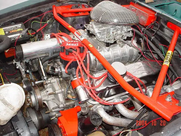

    yea running a 50/75 shot of nitrous will cool the intake charge, i used to run a 75 shot on my 174 B&m blower combo on my 85 notch, and that combo was a 93 cobra engine with a f303 cam full bolt ons and worked heads and i would kill almost anything i raced on the streets including alot of vortech efi mustangs, but that car was a freak of nature and ran high 10s all day long , i sold that car with 200,000 miles on that motor and it was beat to **** and i guess its still running today

    Jay, can you get us a bigger picture than that one, I can't see it very well!

    yea they are all on my desktop, i will post some more pics

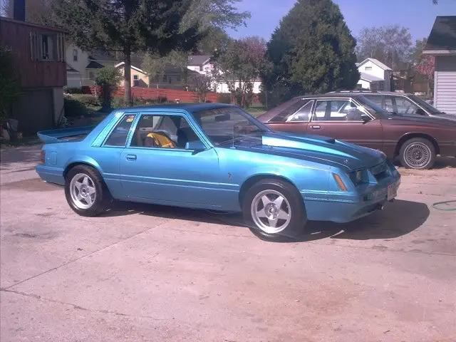

    i have a bunch more of it but i cant find them, that car was white,then this color then ended up black with chrome cobra r's when i sold it. this setup ran flawless only flaw i had was the original 6 rib setup it had. no matter what i would do i could not get it to stop spitting off the belt coming off a hard run, i ended up having to spend 800$ for a 10 rib upgrade, after that it was fine

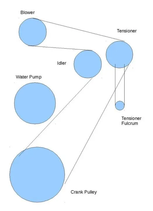

    Hokay, so. I went out to the garage to stare at my Mustang engine for a little bit and think about how you would route the belt. I firmly believe the blower should be on it's own belt, but the engine is so crowded on the front. The other problem came with the water pump. On the Eaton equipped mod motors, the belt generally comes straight down the front of the engine to the crank with 2 pullies mounted to a plate to guide it. This obviously won't work on the SN, because the water pump pulley is so dang big, where as it is very flat and recessed on the mod motor. And then it hit me, run the damn belt around the water pump pulley altogether. I went out there with some string to check straight lines, and found that if you mount another pulley on top of the current idler pulley it should clear the water pump pulley down to an extra crank pulley. The two pullies would have to be able to rotate at different speeds. Here's how you do it. You remove the bolt and replace it with a longer piece of all thread, or just a longer bolt that is threaded the whole way. Then weld two bushes to the bolt where the pullies will ride. Then you can use a nut and washer to hold them in place. Then you can put a tensioner outside of that. This will require building a bracket to mount it. The bracket could mount under the bolts that hold the driver's side accesory bracket on. This would require some bending and welding. I crayoned up a little diagram. This is looking from the front of the car back towards the engine. The tensioner would sit close to the power steering pump.

    see, the bug bit you too, now you're trying to figure it out in your head! I have lost sleep trying to come up with a solution.

    This is the stuff I live for. I wouldn't say I've lost sleep over it yet though.
