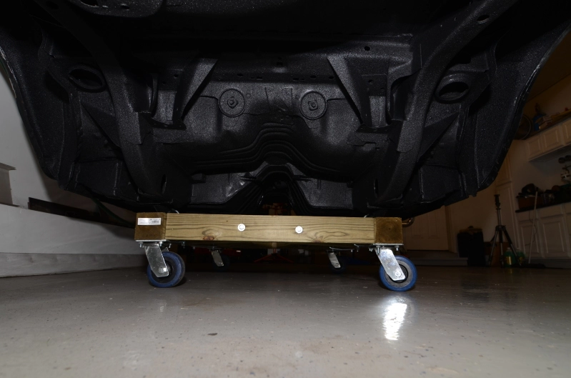

Thanks! _ I'm writing that down - the end result of the underside looks awesome!!Thanks bud. The seam sealer is made by Lord. This line of sealer is called Fusor 800EZ. I got it from my painter. It's a professional grade sealer. Not as 'professional' as those sealers that use the dual cartridge caulk guns to appy it, but it's still good stuff.
I'm applying the Raptor Liner as we speak. Just waiting for the first coat to flash, then I can hit it one more time...

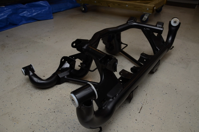

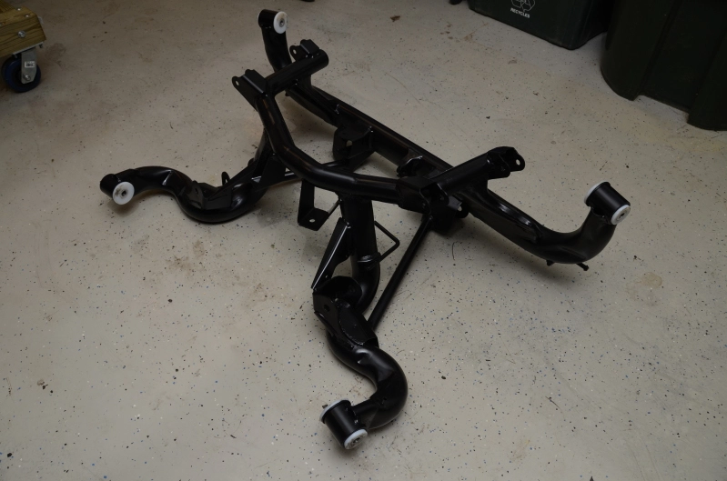

This is the stuff I used on the subframe. It's very durable and sprays very nice. Just takes a while to fully cure.
http://www.eastwood.com/ew-extreme-chassis-black-satin-aerosol-14-oz.html

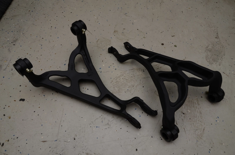

On the control arms, I just used Rust Encapsulator. They had some surface rust on them so this stuff will take care of that, and I liked the flat black look for contrast. I'll be curious to see how this stuff holds up over time.
http://www.eastwood.com/rust-encapsulator.html

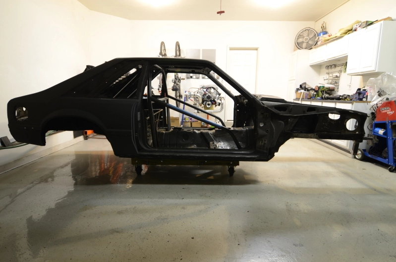

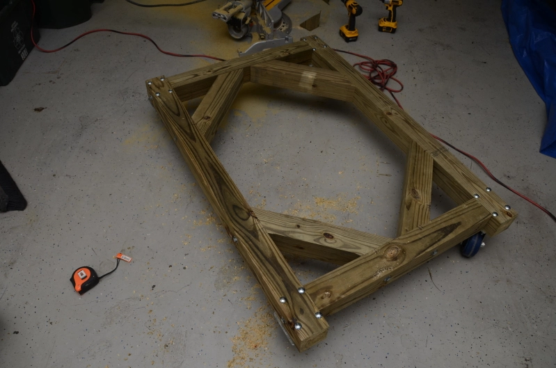

You can't really see them in the pictures, but yes, there are 4 clamps holding the frame to the dolly. I used 2' pieces of threaded 3/8" rod. Bent them over a 4" radius to form a u-bolt. I then used flat steel stock on the bottom side of the dolly. Having the tubular subframe connectors made it very easy to bolt everything together. It takes nearly zero effort to move the body around. Just leaning against the car makes it move.
The dolly will be used to get the body on a flatbed so it can be transported to the paint shop and back.
