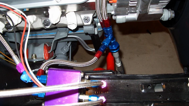

If you look at my pic, you'll see the lowest fitting that the black hose connects to. It's an anodized female quick disconnect that attaches to the factory hose coming from the tank. All you'd need to do is the same thing I did, but at the top of the T fitting, put a MALE quick disconnect to attach to the factory line coming from the fuel rail.
