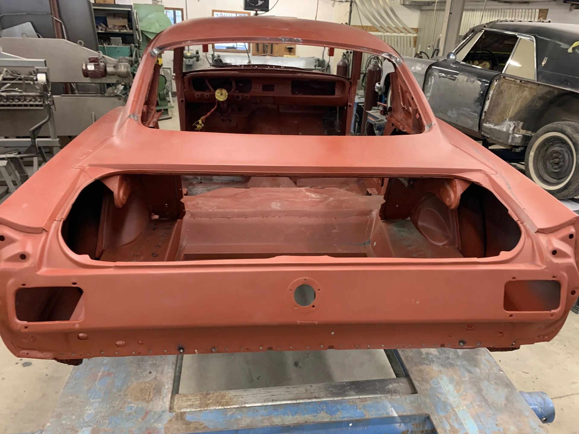

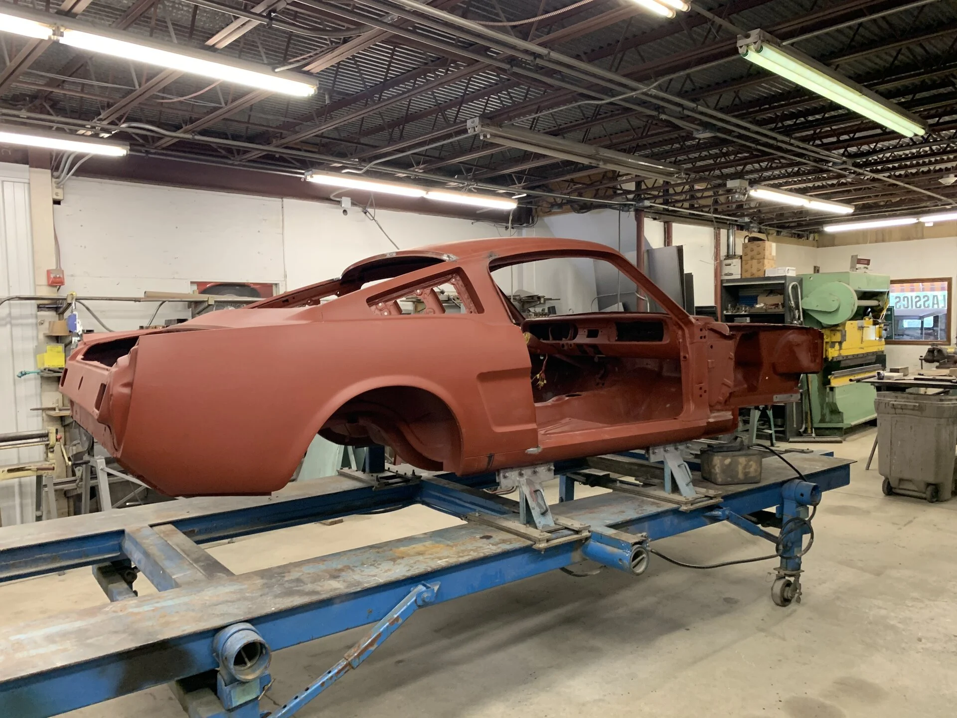

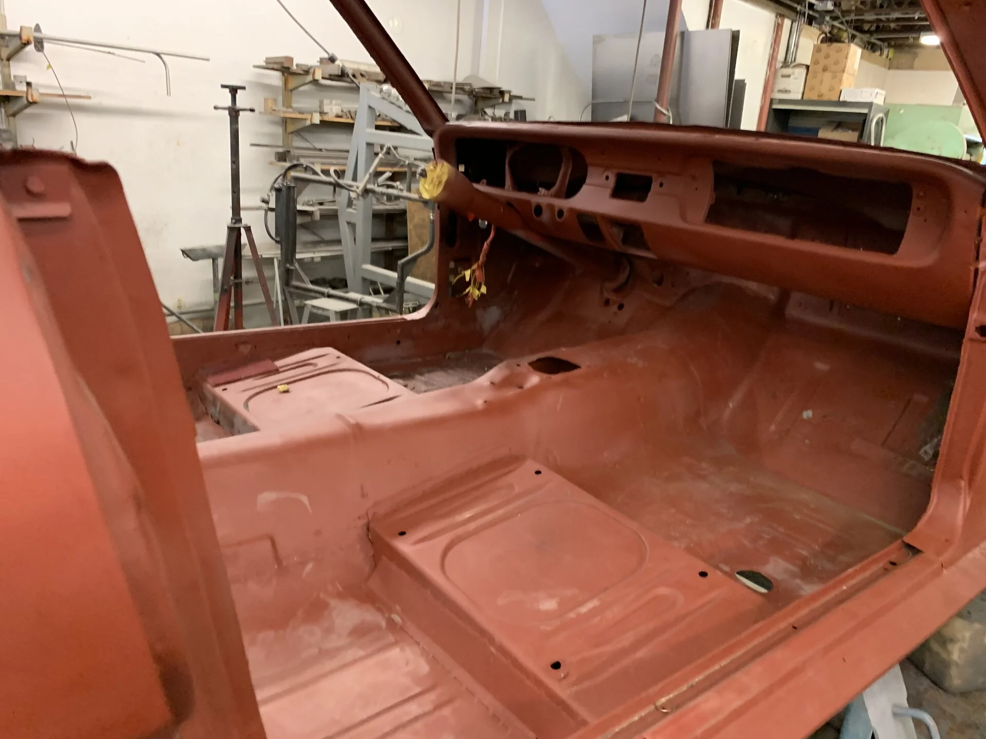

Filler primer and metal work started!

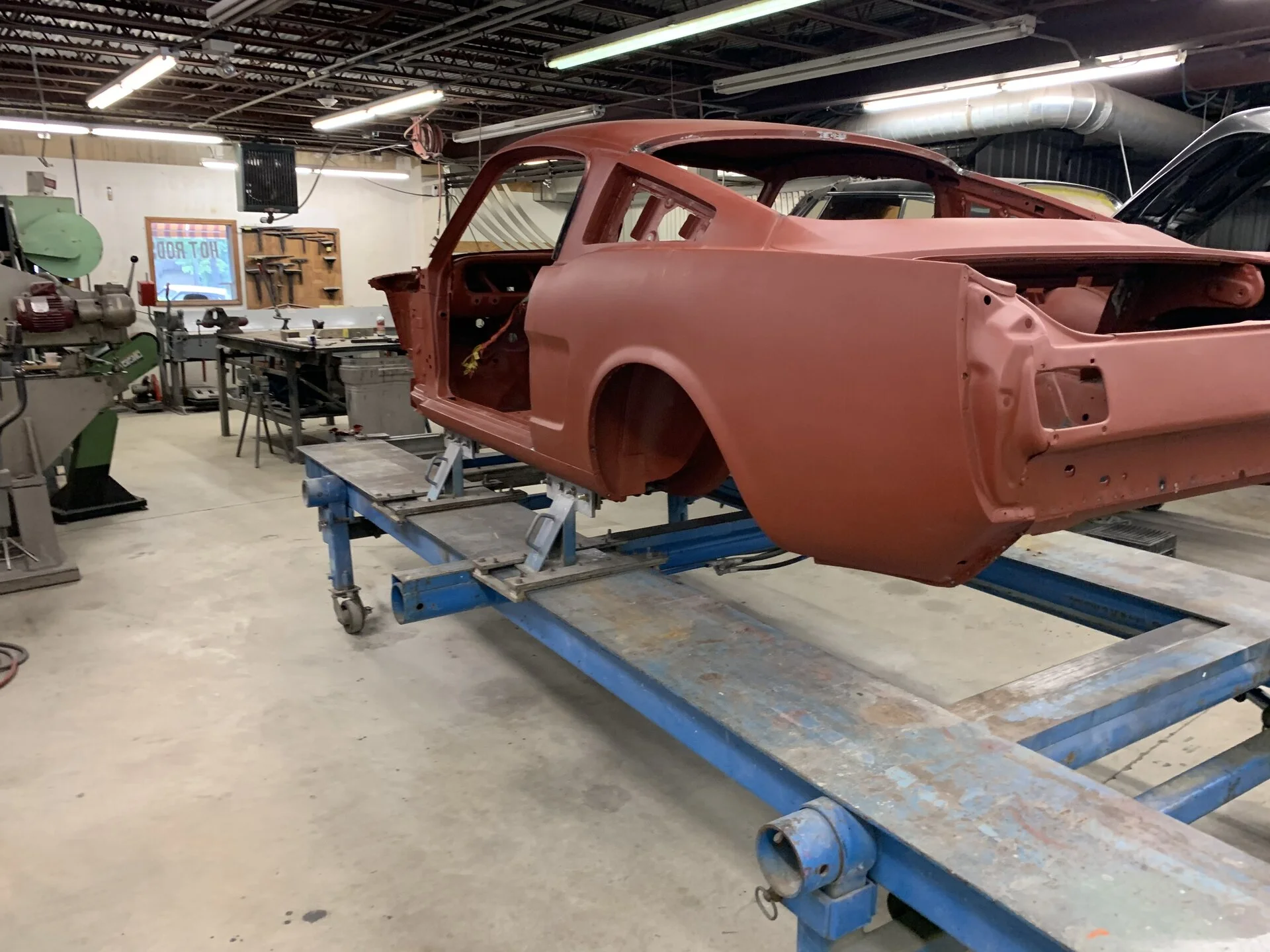

She's on the frame machine and looking good . Did she need a little pull?
