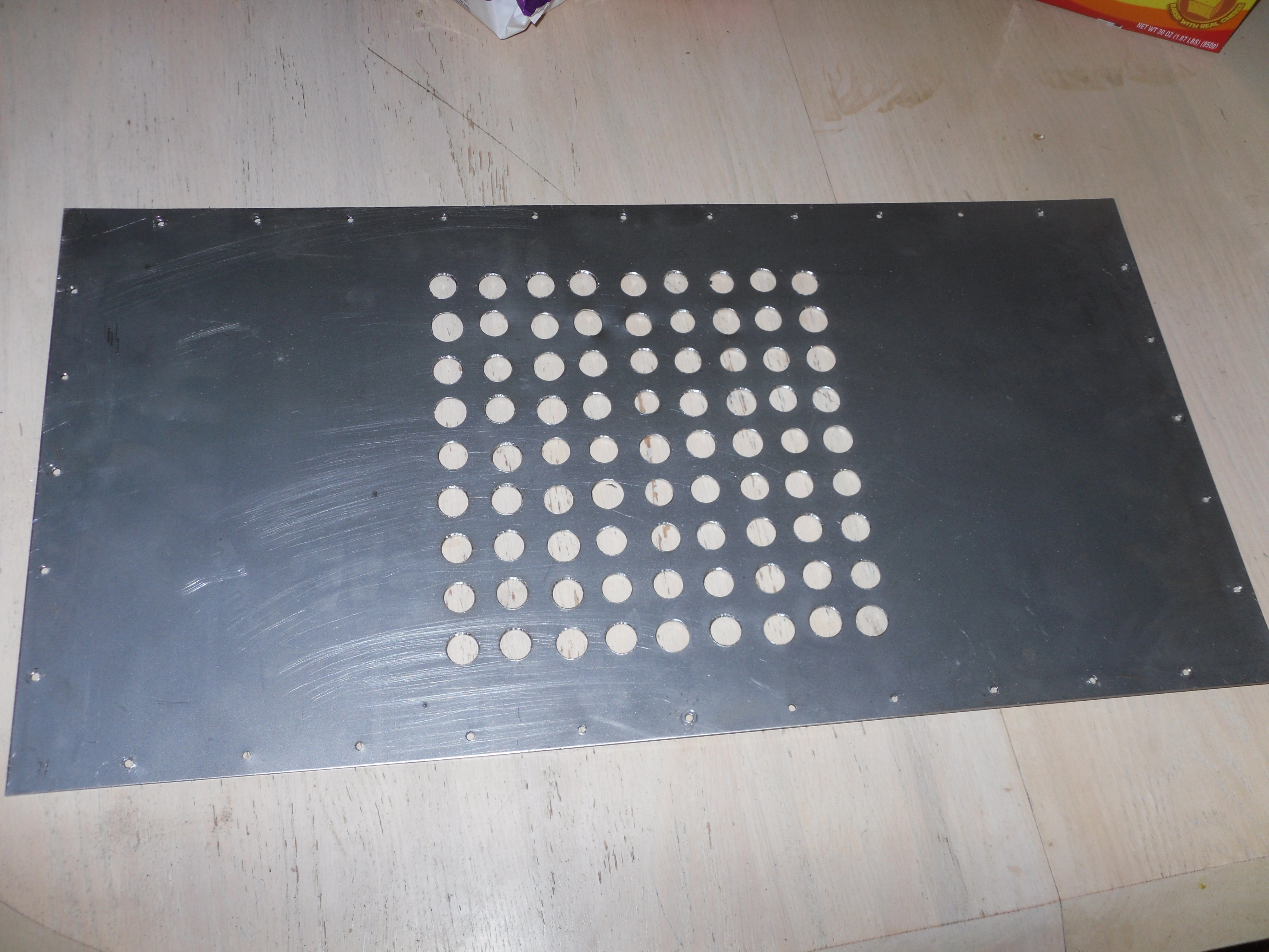

Thanks strtrcr50. I've never earned any internets before & my wife's cat looks just like that one lol. you make a good point about the scoops but, They are both going to be forward facing. the driver's side isn't going to be connected to the passenger side though. The one on the driver's side is going to take fresh air in from the outside that will be ducted to an 8" fan on top of the box. The fan will suck in the fresh air & blow the heat out through the floor once everything is completely closed in. the Passenger side scoop is going to act like a ram air scoop & force feed cool air to the intake side of the turbo. I know that only works at speed & wont help much off the line. There will also be a filter box for street driving & a straight through tube for the track.

Thanks. It feels like it is going to take forever to get things done. Funds have been put on hold for a while. My next step is to make templates out of cardboard to box in the bottom of the scatter shield. once I get that done, Im going to start cutting the floor up for the through floor sub frames.

Thanks guys & thanks for the recommendation on the side scoop. Mike (madmike1157) recommended the classic style scoops too. I think that they would have been more pleasing to the eye but, I couldn’t find any dimensions on the opening or length. Like it was mentioned, I didn’t want the turbo to have to work to pull in air. I started with a scoop that stuck out of the car 3” but that looked pretty bad so what I did was shrink it to 2”x6” but, I sunk the front of the scoop into the body so it still has a 3” opening but, it only sticks out 2” in the front. What is shown in the pics is the functional part of the scoop. I plan to try to fiberglass some more style into them, Kind of how a hood scoop angles out at the bottom.
