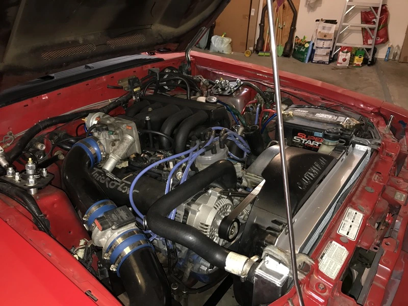

Bringing this back from the dead... I got burned out on the car for a while and I'm just getting around to working on it again. So I got my cooling system fixed up I think, SVE radiator, Mk VIII fan and DCC controller along with removing the UD Pullies. I have all the stuff to relocate the battery to the trunk but decided I'd tackle that last. Well... then I crawled underneath to see about running the cables and I noticed that a spot on the rear drivers floorboard that had looked like some rust had set in before was now really bad... like grand canyon bad and this car is a garage/jackstand queen in Texas. Well in preparation a couple years ago I had bought the floorboard panel from LMR knowing I'd have to do it one day and I think that day is today.
