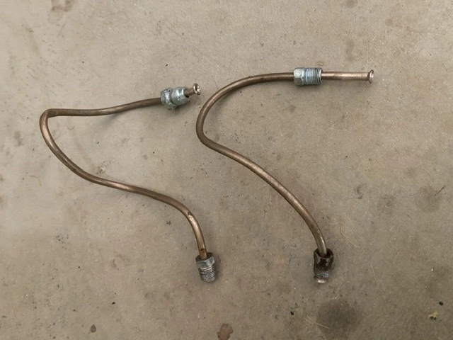

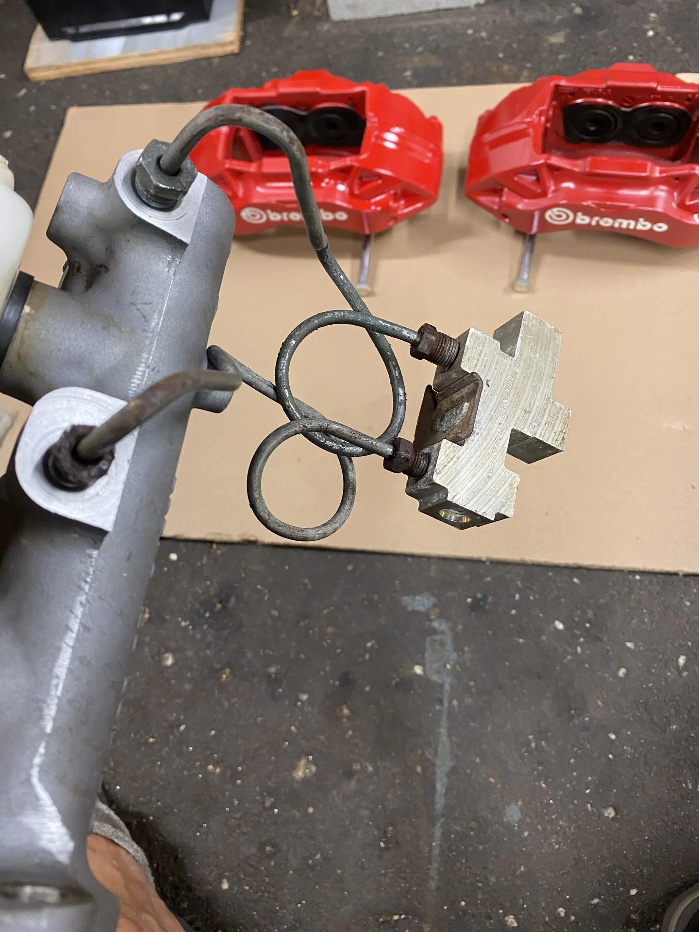

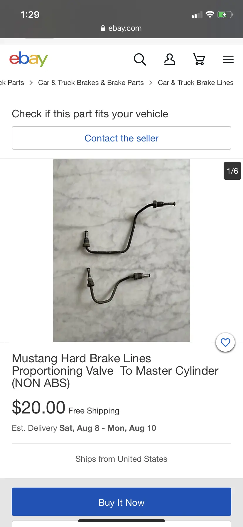

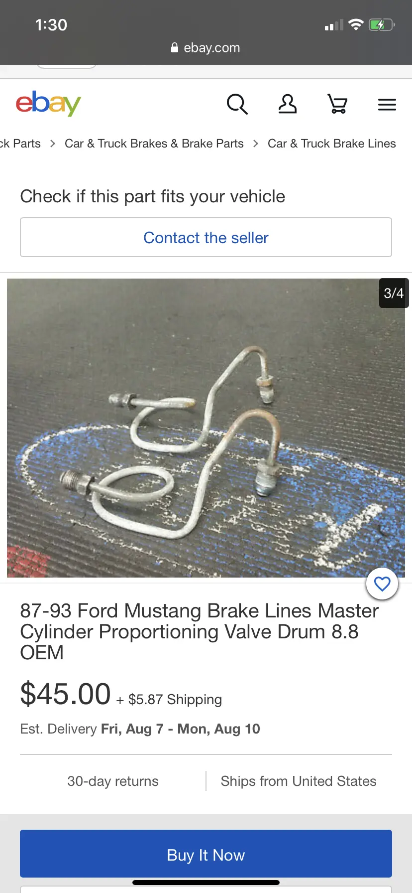

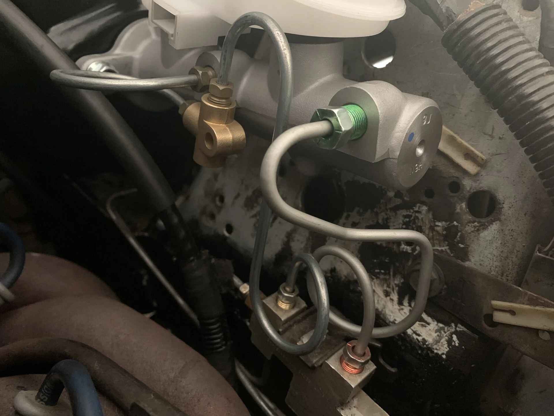

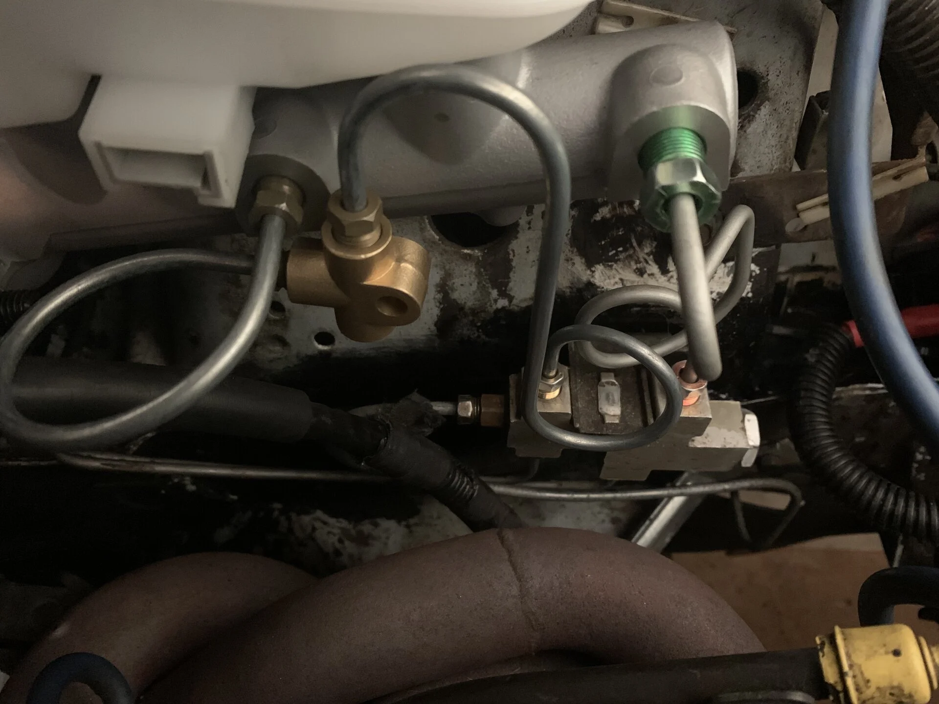

I thought that was the case but figured I would ask to satisfy my paranoia. Thanks for confirming.The prop valve only fits in one spot, the bolt and the 'tang' (little ear that fits in the hole lines the bracket with the bolt hole) only fit one way, the lines that you took off likely were bent by another owner for what ever reason, just adjust the lines that are supposed to be there by carefully bending them to fit.
Actually. You want my lines? I’ll just send them to you. Not perfect, but they work
I don’t need them. I’m going hydroboost. I was gonna trash them.
If you don't need them, I'll definitely take them. Let me know how much you want for them. Thank you!
Thanks man. I really appreciate that. Just sent you a message.Don’t worry about it. Guys here have sent me free parts, time to pay it forward. Send me your address I’ll try to get them out tomorrow

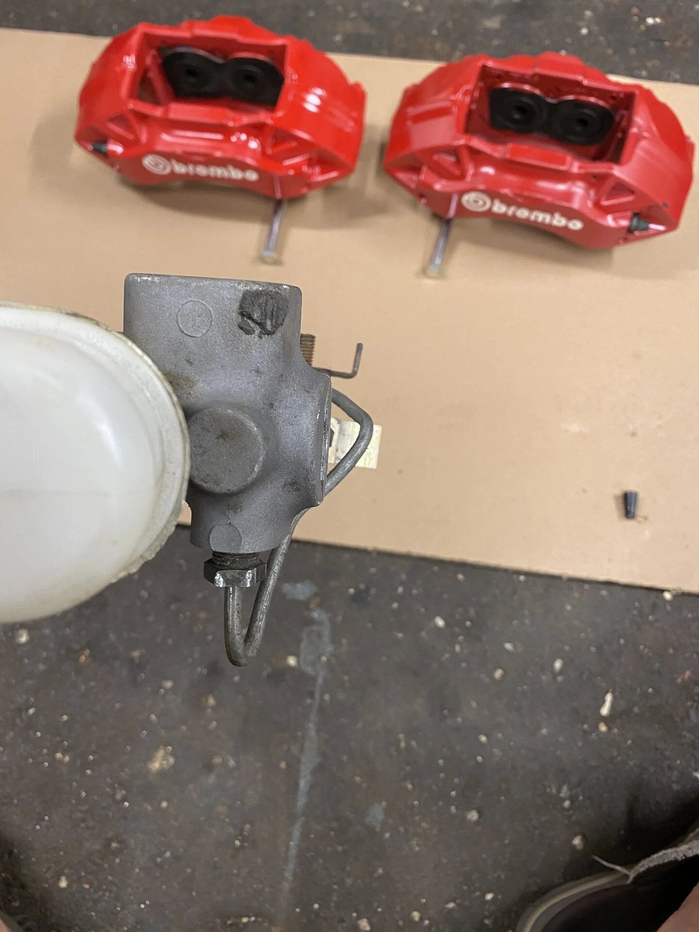

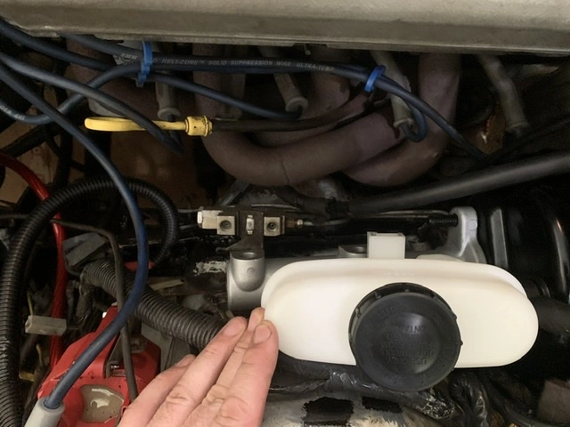

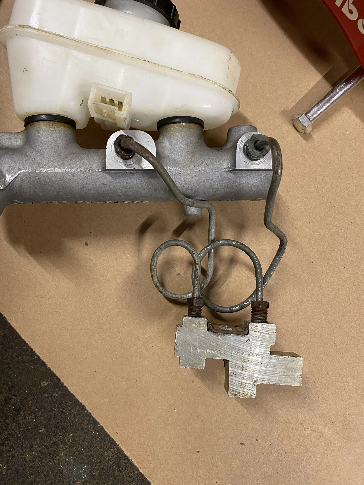

Yeah it’s been an experience trying to figure out what was done and how, between the unique alternator upgrade and the whole brake MC debacle.Just watched a few of your vids. Previous owner certainly did you no favors with that brake MC install.
One thing I caught was the original MC was in fact a stock 3-port MC. The PO plugged the bottom port, and then just relocated the line down to the prop valve. That makes no sense. They did the work to install a 2-port MC, but didn’t actually do it. Wow

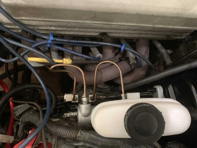

They do look like copper lines. The ones in the rolls at the parts stores aren't even that color. Whoever's eagle eye caught that deserves a beer.
Are those brake lines copper? They don't look right and one looks to be leaking at the fitting.
I'm over looked a lot around hereLooks like Mr car stealer guy pointed it out back in post 83 in March....and we all skipped right on over it.
