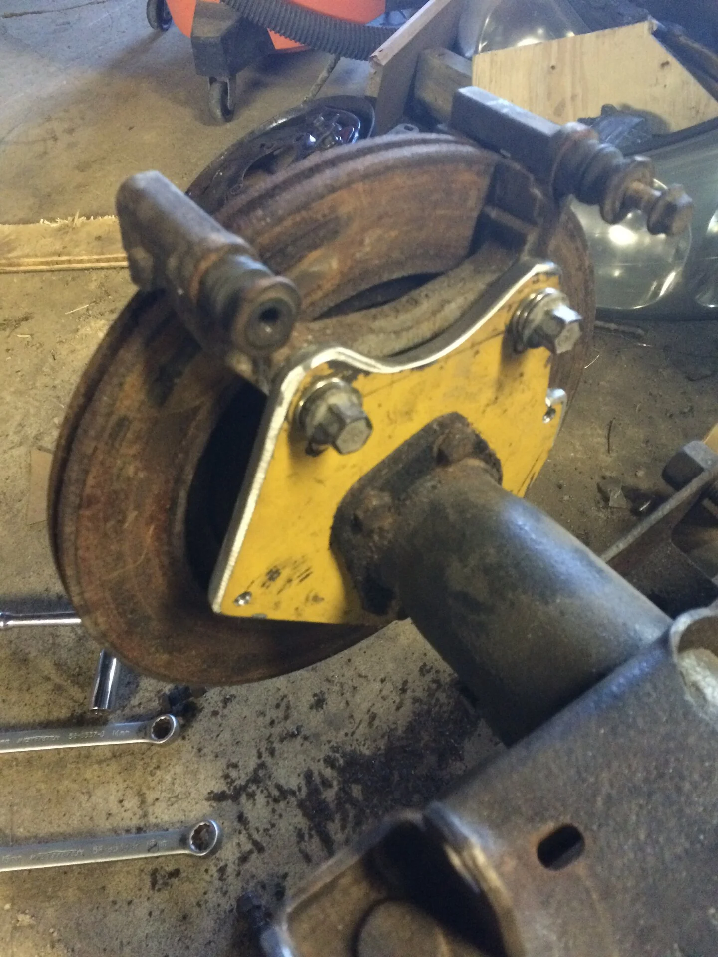

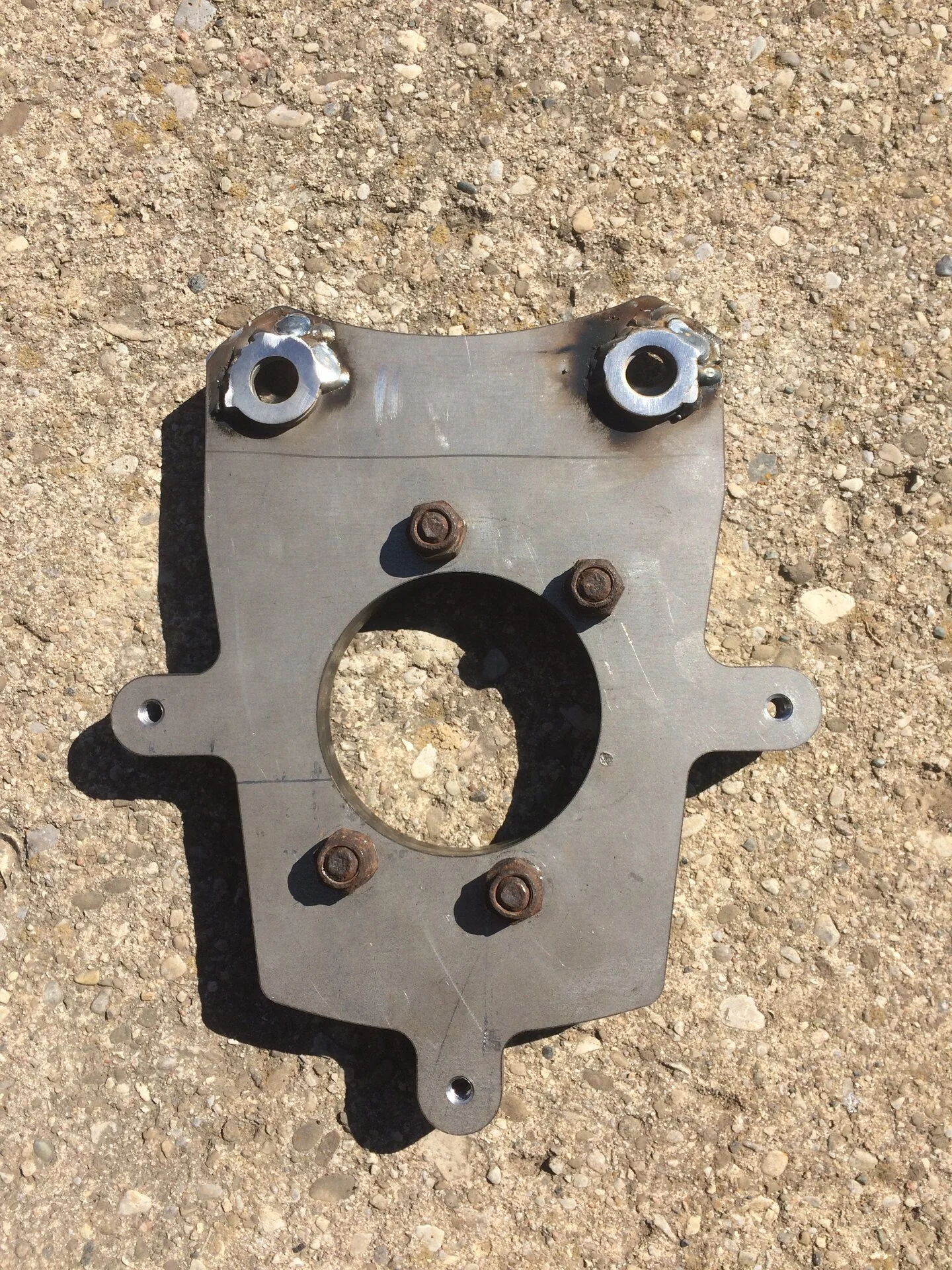

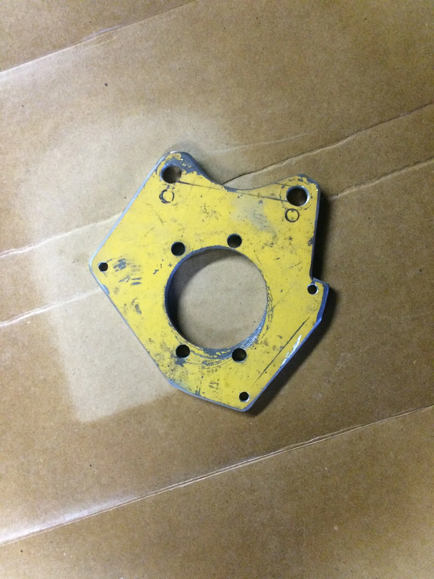

It doesn't say how thick the bracket is or what material it is (or I just missed it). If the bracket was beefy enough I don't see a problem.
I used at 11.33" Lincoln LS rotor (redrilled for 4x108 BP). I used LS calipers as well but I think SN95's would have been the same (I have some of those too)
I used the stock SN95 bracket as a template and fabbed a bracket out of 5/8" plate (some beefy material I had laying around). Stock mount holes are marked.
These mounted to the outside of the flange. The rotors are only 1.29" high so they are much thinner than the rotors used by most.
Shortly after I bumped into another member on a different Mustang site would had access to a water jet cutter and had scanned in the stock bracket. I needed the mounting holes moved 17mm away from axle centerline which he cut a pair for me.
In the end I needed a washer for each bolt hole to better center the caliper on the rotor. I welded them on and ground down to near perfect.
