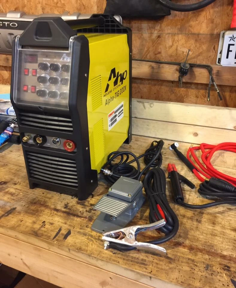

AHP alpha 200. Check them out. Around $800 and mine has kicked ass for 2 years or so now. I’ve used it to build 2 cars, 3-4 turbo kits and a million things in between. Used it for 6 hours yesterday.

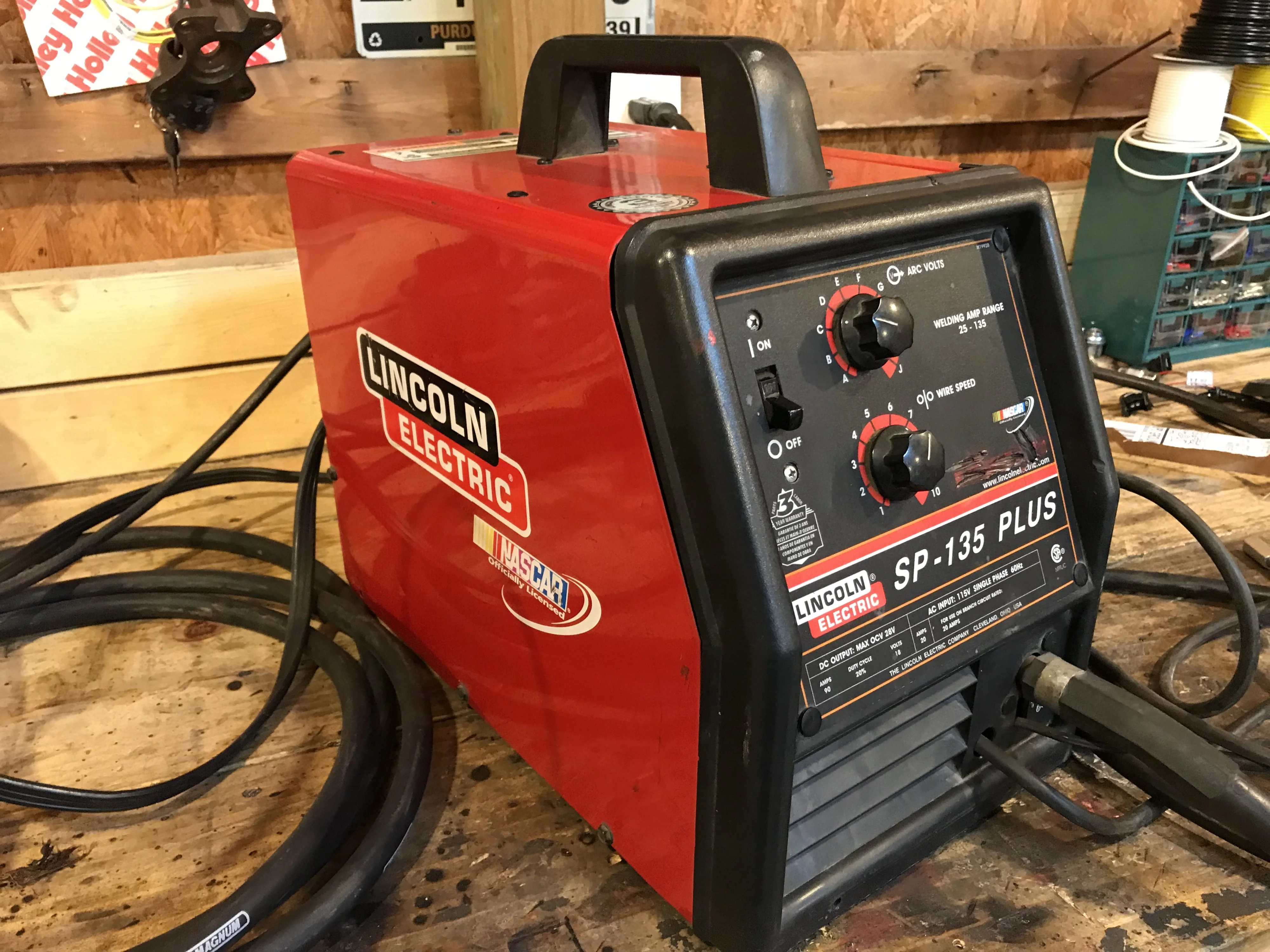

I also went out and bought a Lincoln MiG for $100 that I used the other half of the day yesterday. Being able to “point and shoot” can be super helpful with chassis stuff. Sometimes I tack it in with the MIG and do the real welding with my TIG.
I had a harbor freight flux core deal to handle the tacking stuff but flux core can be sloppy so for the same money I was able to replace it with a gas machine.
I guess what I’m saying is that each one has its place and does things the other can’t do but if I had neither I’d buy the TIG first 100%.

prob going to order an alphatig here in a few weeks

Ill definately look at the alpha tig...like i said ive never welded before but im a pretty quick learner so hopefully can pick it up with practice. Ive watched alot of videos and the array of settings and different tips/cups etc seems a little orverwhelming but im sure its like anything else thats new to someone. It would be nice to be able to fabricate my own exhaust routing, intercooler tubing etc then to try and rely on a shop.

I got a Miller 135 MIG mainly due to cost and it meets my needs. I don't have a 220 outlet in the garage right now so that would add to the cost for an electrician (SCREW messing with electricity) and I got it with a cart and bottle fo 75/25 mix for $500 ready to go. I want a TIG, but honestly just wanted to learn on the MIG first, so one day I'll upgrade but I'm happy for now.

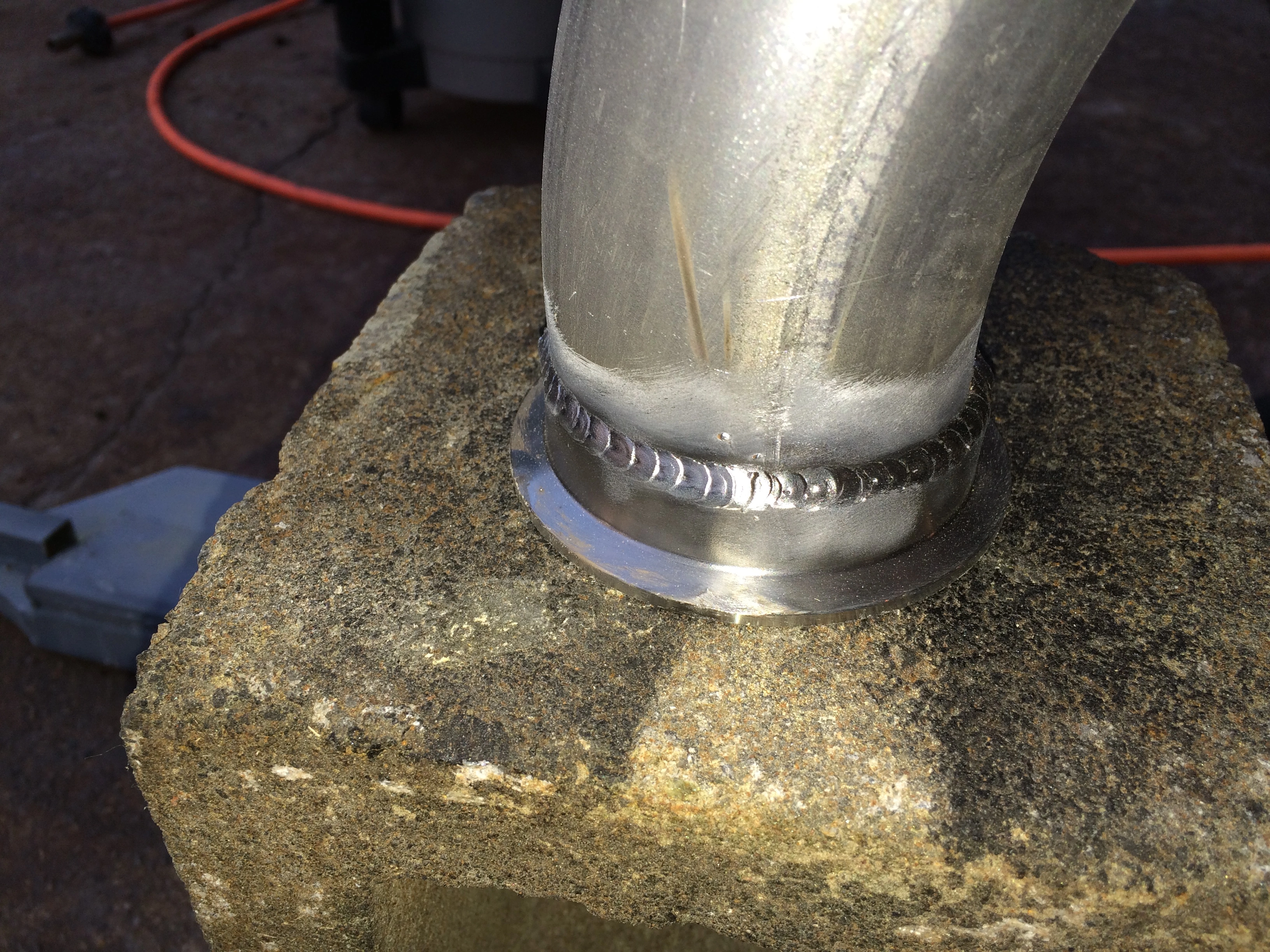

Pfft...It's all about how good you are and if you have your machine set up right for the material you're welding. this was done with a mig.
A TIG would take for freakin ever to learn the technique to get a weld to look this good. If you can see, hold a gun, and pull a trigger, you can make a mig weld look this good, and it took under a minute to do.

Will the MIG weld stainless? I hope to fabricate my own exhaust next off season.
There are just some things that you have to come to terms with when using a mig. Welding thin wall mild steel, ( like exhaust tubing) can be accomplished with a mig. If you use a thin wire, have your heat set right, and pulse trigger the gun, you get a weld that looks like the one I posted above, except it will stand on top of the joint because you're butt welding pieces together. If you can achieve that look, Despite the " stacked nickels" appearance, Most would elect to grind that down in order to have a seamless appearing joint.
Now,...throw in aluminum, or stainless.
Stainless can be mig welded, but why would you? Stainless doesn't like the excessive heat mig welding can generate and can become brittle when mig welded. Starting off not knowing how to weld, attempting to learn how to TIG, and then going out and using thin wall stainless to learn on is gonna be like a 1 year old baby attempting to run the Boston marathon.
There's gonna be a lot of crying, a bunch of mess, what's not messy wil be ruined, and it's gonna take forever.
Stainless is about the biggest pain in the ass to fabricate going.
It's 3-5 times more expensive
It's a pain in the ass to cut/ drill/ grind, will kill standard drill bits, and saw blades, and will wear out standard flap discs much faster than when used on mild steel.
Grinding on it will show the " tooth marks" of the disc you used to grind on it, requiring even more grinding to smooth it out, and it's already way thinner than the standard tubing to start with.
But,....if you master the TIG process, you don't touch the weld,..you want it visible. And nothing looks better than a TIG welded set of stainless headers.
There's just no way in hell anybody jumps from "a to z" w/o dozens of hours spent welding with a TIG. Anybody who can write their name legibly can learn to mig in a week.
