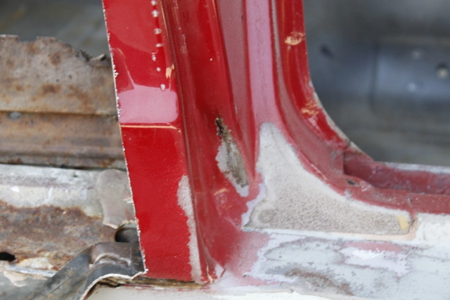

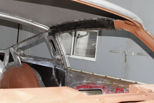

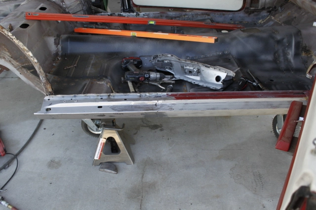

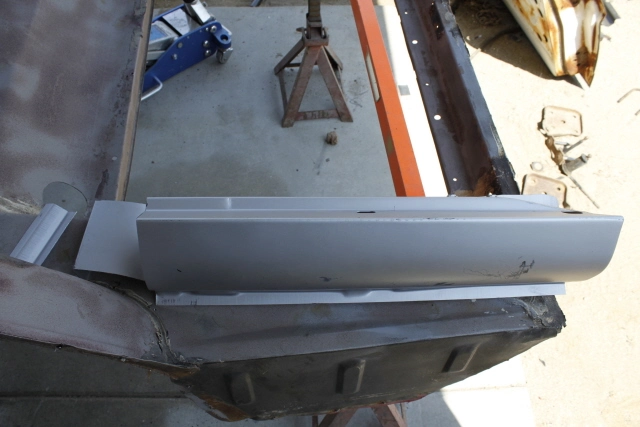

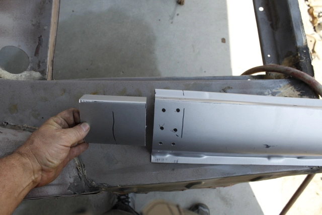

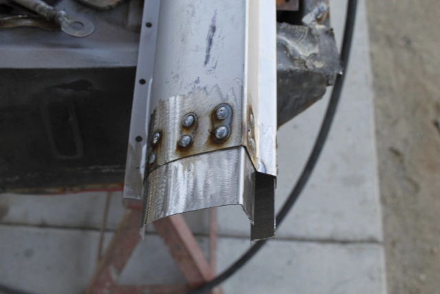

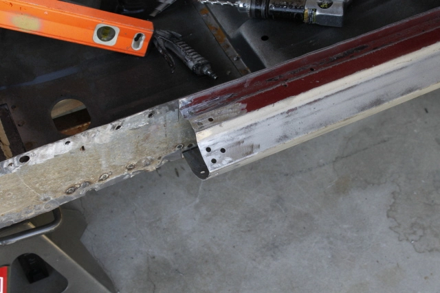

    the pass. side is done .i did it the same as the driver side . i had to cut this side a little longer ,it had a dent . it didn't line up quite as easy as the other side but not bad at all . the door post is welded in place .now i can start on the rest of the door frame. [​IMG] [​IMG]...

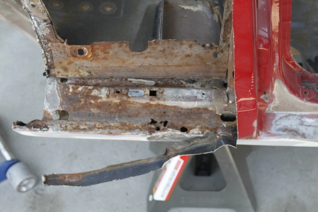

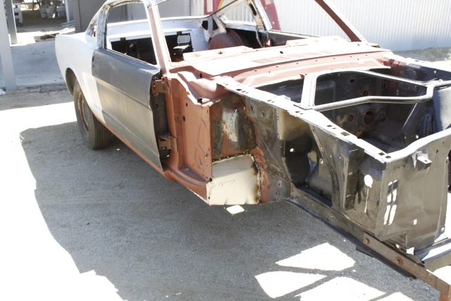

    [​IMG] [​IMG] [​IMG] [​IMG]

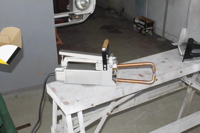

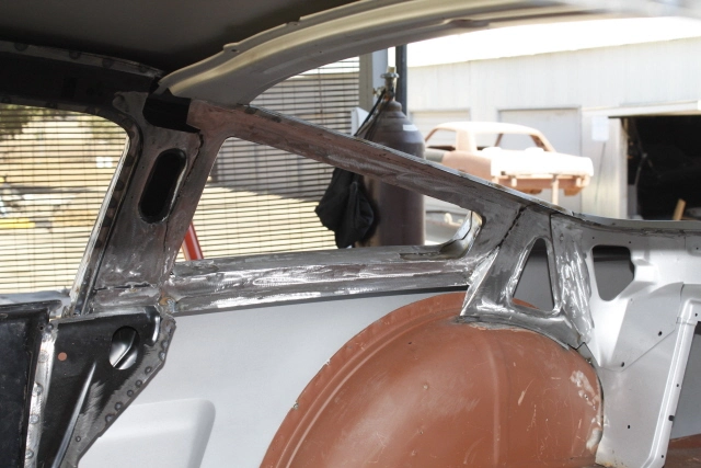

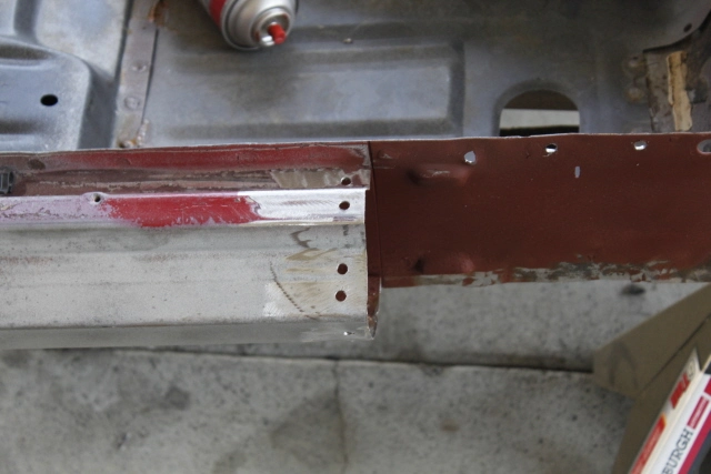

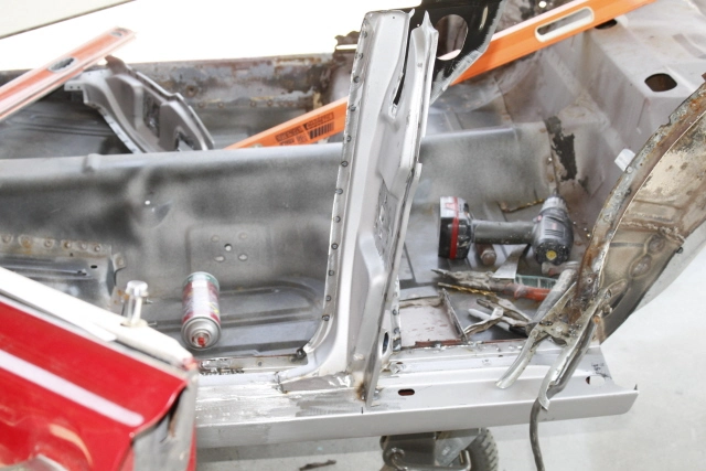

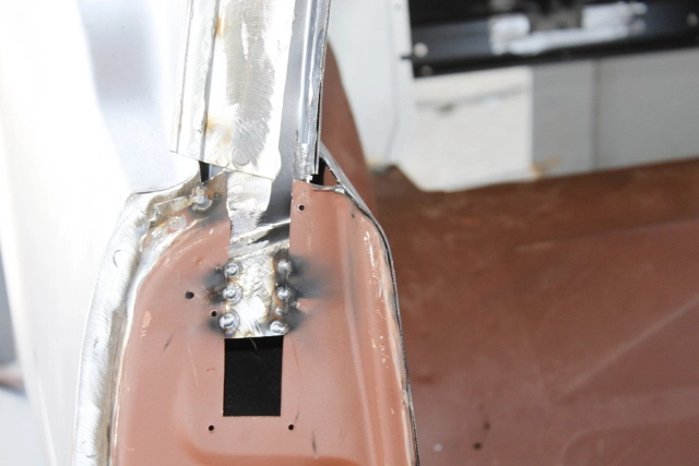

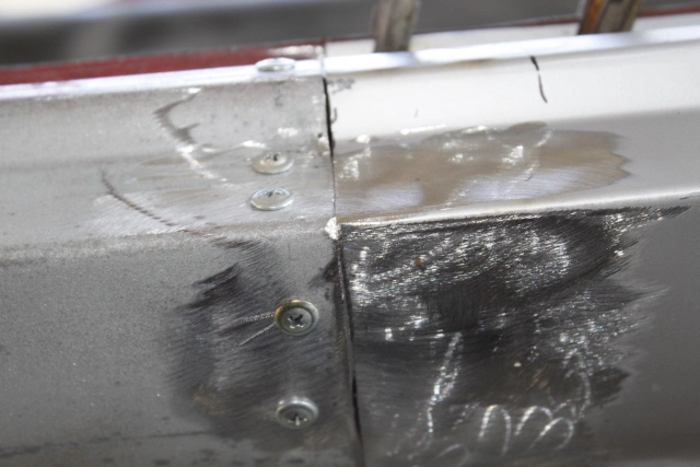

    i spot welded the rear door posts together and welded on the driver side to the rocker .i used my good old Harbor Freight spot welder,what a time saver .no welds to grind...

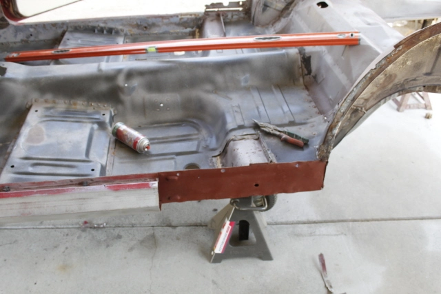

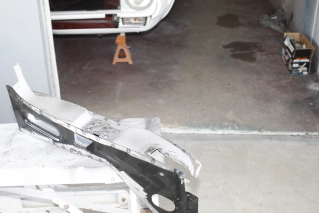

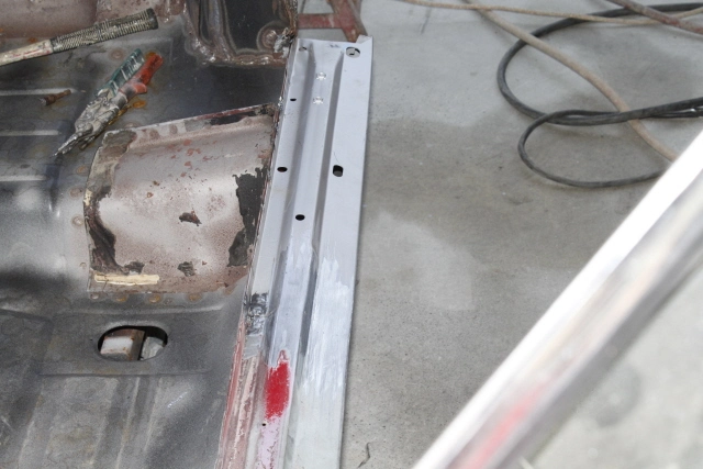

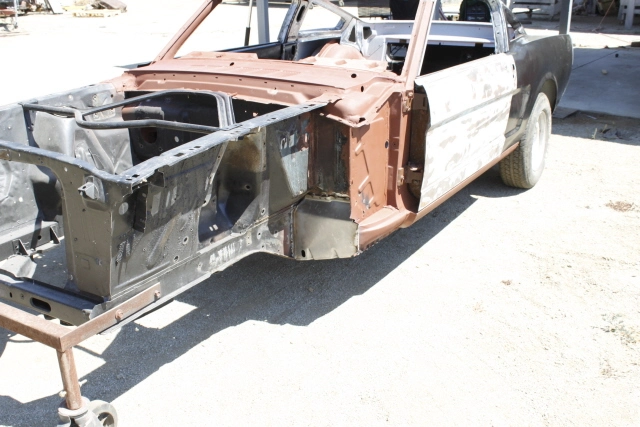

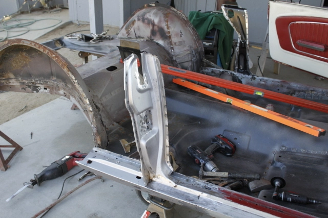

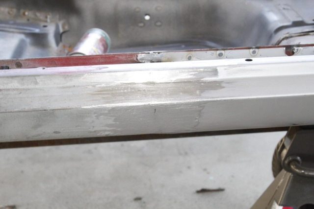

    the floor supports and torque boxes are in. the torque boxes did not fit they were welded together crooked,wish i had bought the non-welded ones . i had to take them apart...
