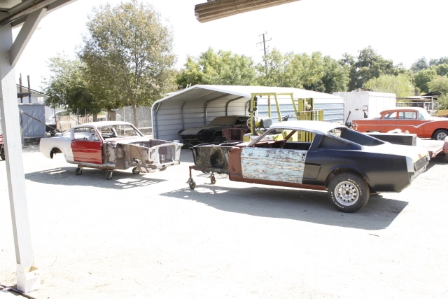

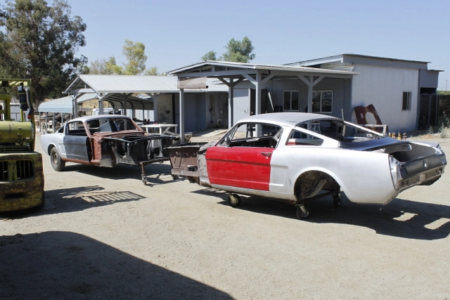

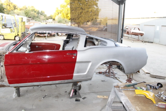

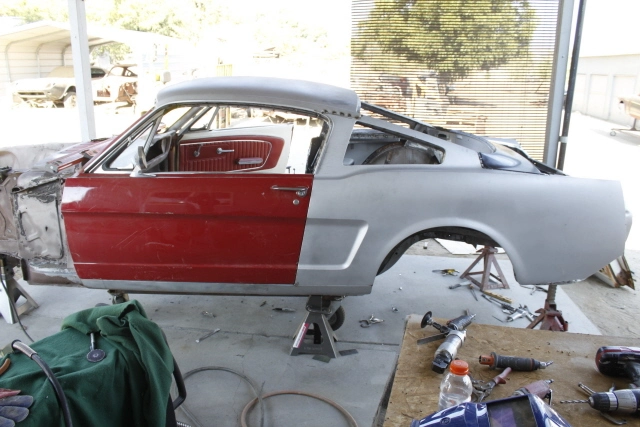

    [​IMG] [​IMG] the red car is finished. i loaded it in the trailer and it should be going home tonight. i still have some work to do on mine , soon as the new fenders and doors and radiator support come in.

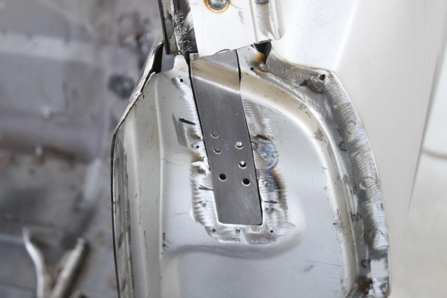

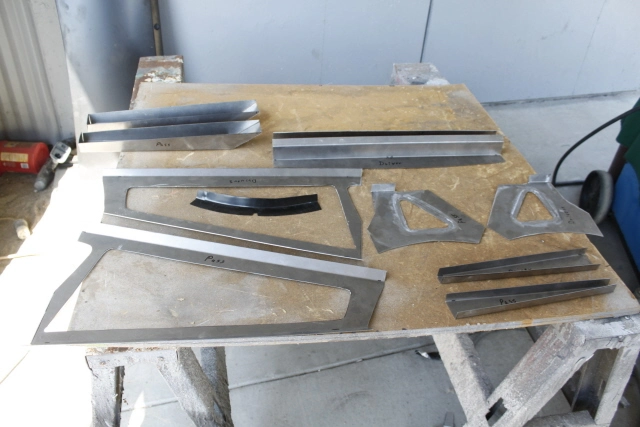

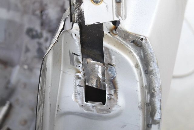

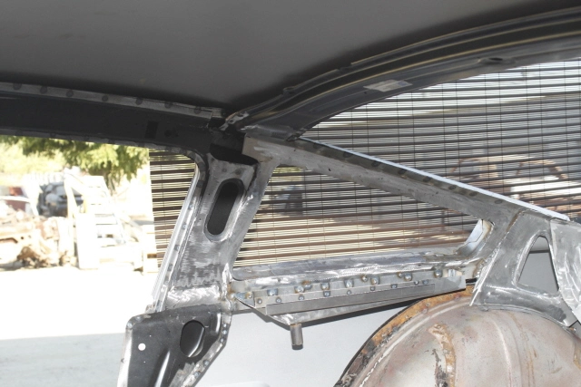

    [​IMG] [​IMG] [​IMG] [​IMG] i bent all of the inner pieces in the sheet metal brake ,welded the drip trays ends and attached the mounting for the inner fiberglass to the drip trays. it is all welded...

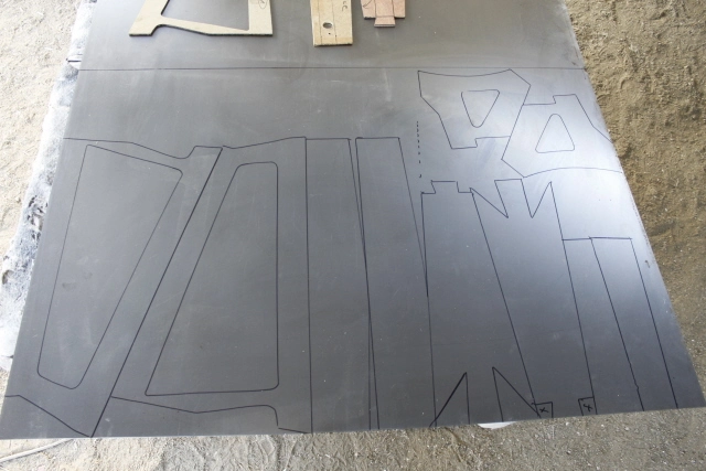

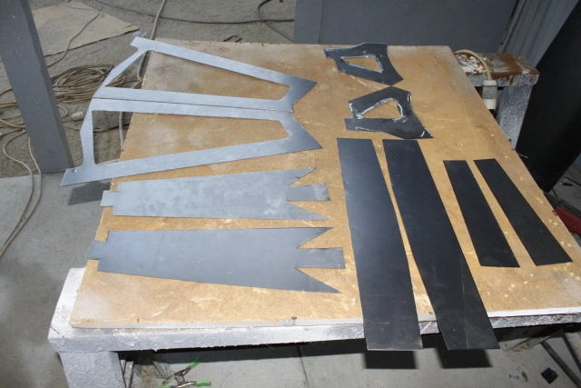

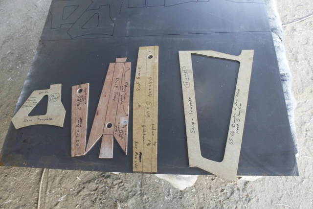

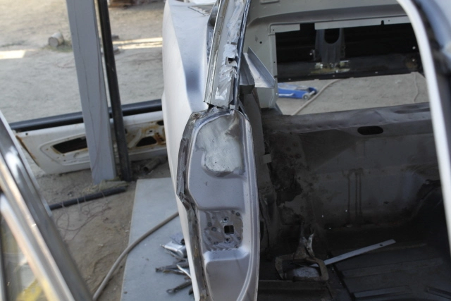

    the out side of old red is finished .i started making the inner pieces. glad i made templates of every thing. laid out the patterns on my sheet of 18 gauge sheet metal. a few minuets with the sheet metal shear and they were cut out. i have a few bends on the sheet metal brake tomorrow and they will be ready to weld in. [​IMG] [​IMG]...

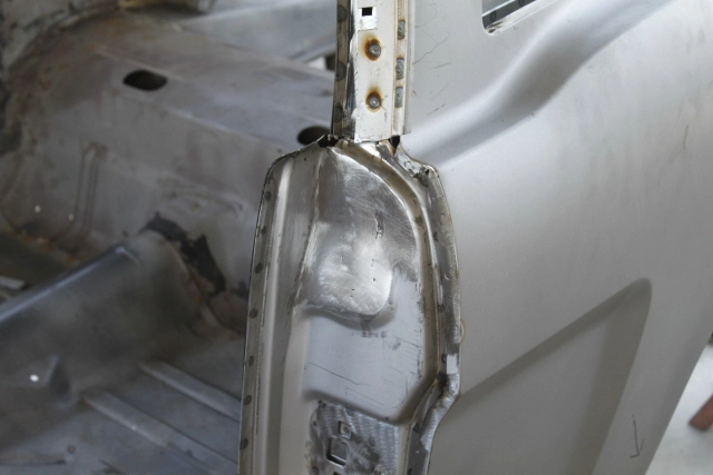

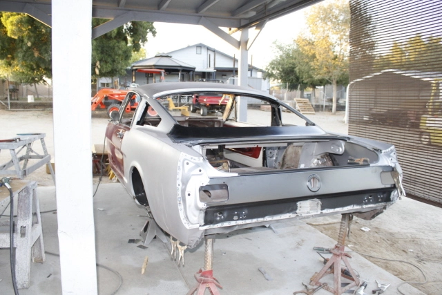

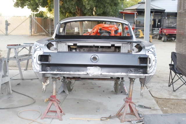

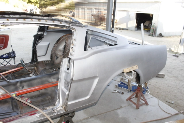

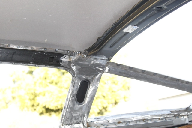

    horse sence

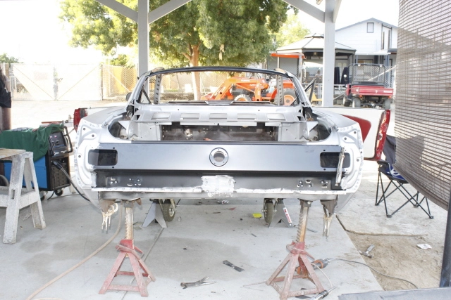

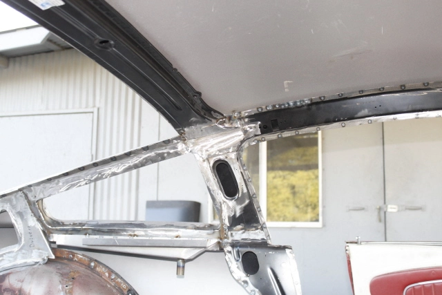

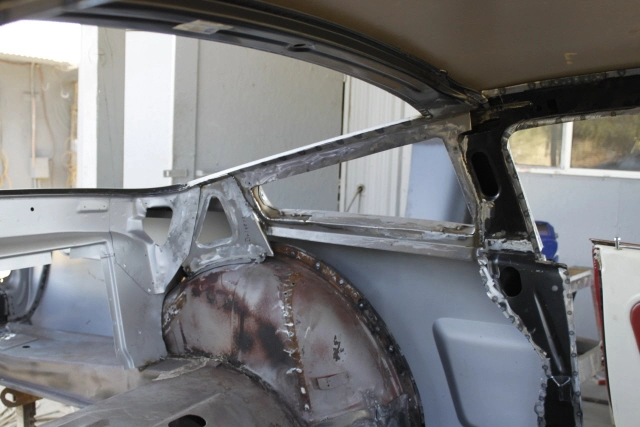

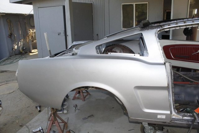

    i got the quarters and the back window panel welded in place on old red.the roof brace is held in place by screws for now.the roof is setting in place the fit is right on .i still have to spot weld the bottoms of both quarters but that will not take long. i have to weld the tail panel to the quarters and the back end is done. for such a beat car it sure went together easy. i should have the exterior finished tomorrow evening....
