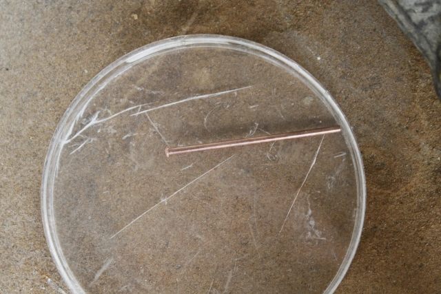

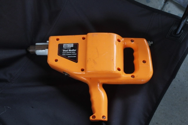

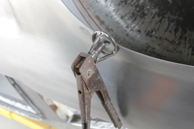

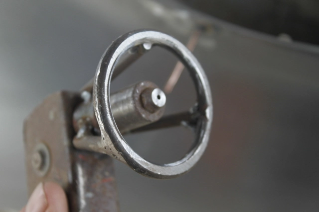

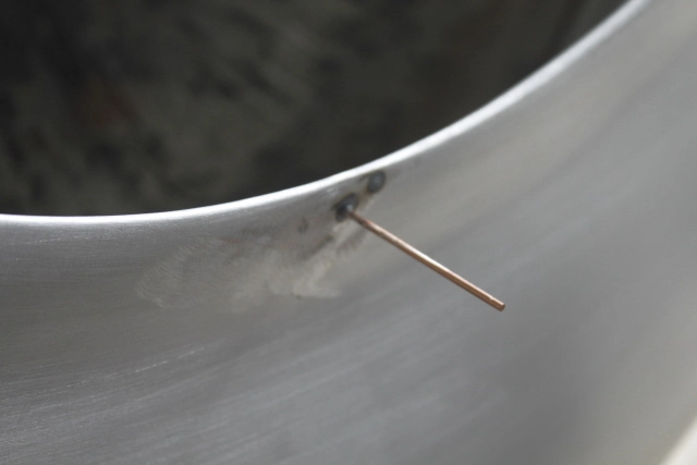

i just could not stand it ,that dent had to go . i got out my stud welder ,another Harbor Freight goody. before you can say weld, it is welded .the tool i made from an old pop rivet gun .it pulls the metal up flush with the surrounding surface and stops. it took 6 studs and about 30 minutes and the dent was gone. a light brush with a file and it was almost perfect . no bondo will be needed. i hate bondo this thing works great on creases and dings but you need clean metal to weld .

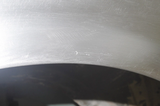

i haven't had much time to work on it , but i did get it sanded down. i was looking at it the other day and noticed blisters and lines in the black coating and the weld through so i sanded a spot .i found that there was writing under the coating in either felt pen or grease pencil so the coating didn't stick. i sanded it off with a D A sander. this is realy some straight metal....except for the wheel lip that i tripped against and hit with the sander. now i have a dent. it's a small dent ,looks like i get to try out my new stud welder. it welds a thin stud ,and with a special puller i should be able to pull out the dent. not exactly how i wanted to try it out. once you pull the dent up you snip off the wire and grind off the left over nub
