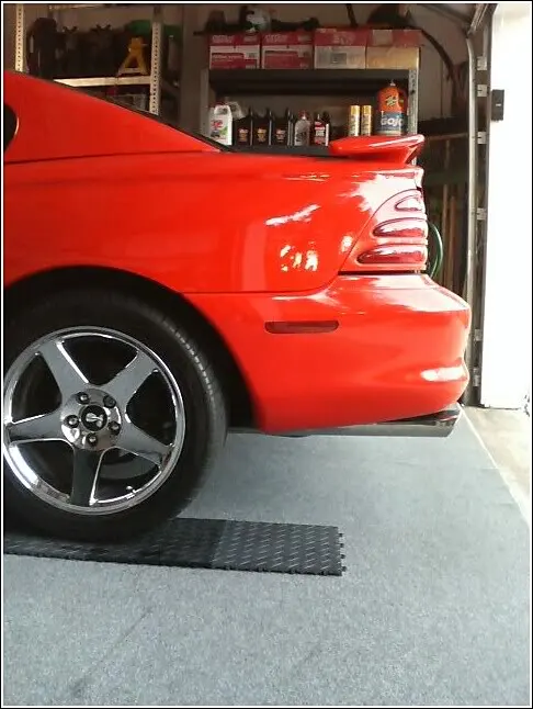

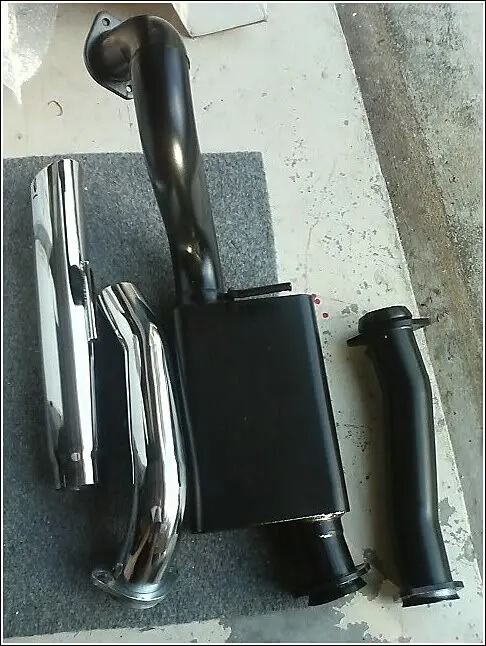

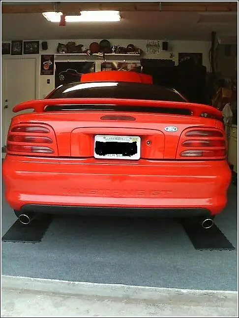

    I went with MAC Ceramic Long Tubes w/ 3" collector, MAC 3" Prochamber and MAC 3" Catback. The sound was crazy and the fitment was spot on. Had no complaints. Got the entire kit shipped to my door for like a grand.

  3. revhead347 I have face herpes.

    Why the heck did you leave the smog pump inlet on it? The first thing did was chop and cap that off. I've also been very happy with the Mac stuff I've bought. I really like their 2 piece tailpipes. It allows you to remove the exhaust later on without cutting and rewelding, it also gives you a better range of adjustment on the tailpipes to get them straight.

  4. VibrantRedGT "STANGNET'S PENGUIN SMACKER"

    I was actually surprised a 3" exhaust system would even have the smog pump pipe. I just capped it off. You're right, for those who don't have a lift can install a MAC system like this without getting the car high in the air because of the way it installs in sections.

    They put that stupid air inlet tube on all the exhausts for no apparent reason. When I first got my Prochamber I just stood on the end of it with a welder to close the hole. Eventually I went back, cut it off completely, and capped it at the Prochamber with a piece of metal. I don't see any reason to have it sticking up into the driveshaft area just asking for trouble. It's also one more thing to snag your arm when you are taking it out.
    I of course don't have a lift, but that's not the only reason I like the two piece tail pipes. Sure it was nice on my car, because I was able to install all the parts under the car, get it all aligned, and then clamp it down, take it back out and weld it on a bench. I also like the fact that you can go back and pull the exhaust out later without cutting it up. With one piece tails, you have to drop the rear end, slide the pipes over, pick up the rear end, and then weld once your under the car, which is also a pain. It's a good idea to get a sock hat and soak it in water to wear while you are under there. I've lit my hair on fire several times.

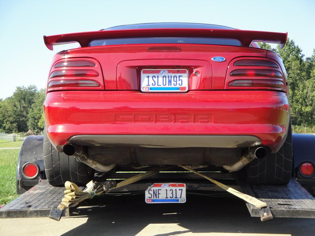

  8. 1slow95 Founding Member

    I made my own with the Flowmaster 3" tailpipes for a fox body. It was tight, but they did fit. I did get them to line up better than in these pics. The problem was with the muffler and x-pipe alignment.
