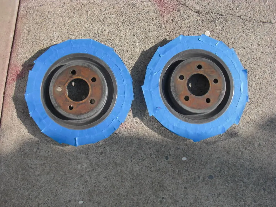

    On another note, make sure you paint the hats @ the center of the rotor before you install them or else they will rust after a day or 2 & will look like azz....
    Tape up most of the part that will be scrubbed by the pads, but paint a little into the area the pads will touch, that way once you brake for the 1st time, it will create a nice even circle & will look factory...
    [IMG]

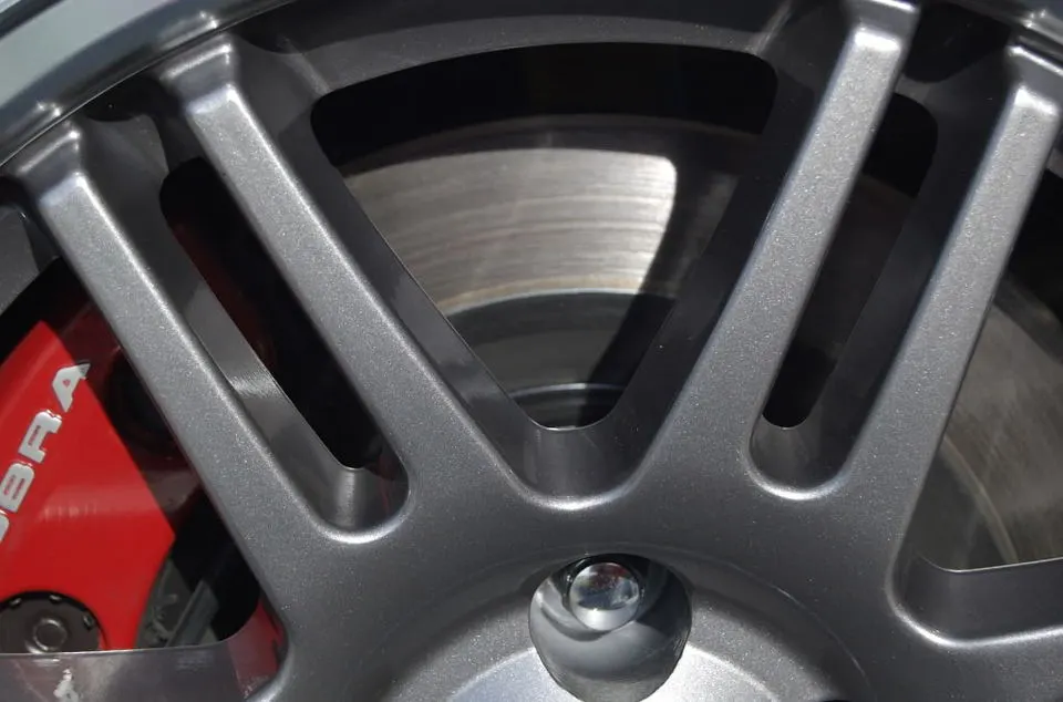

    After braking...
    [IMG]

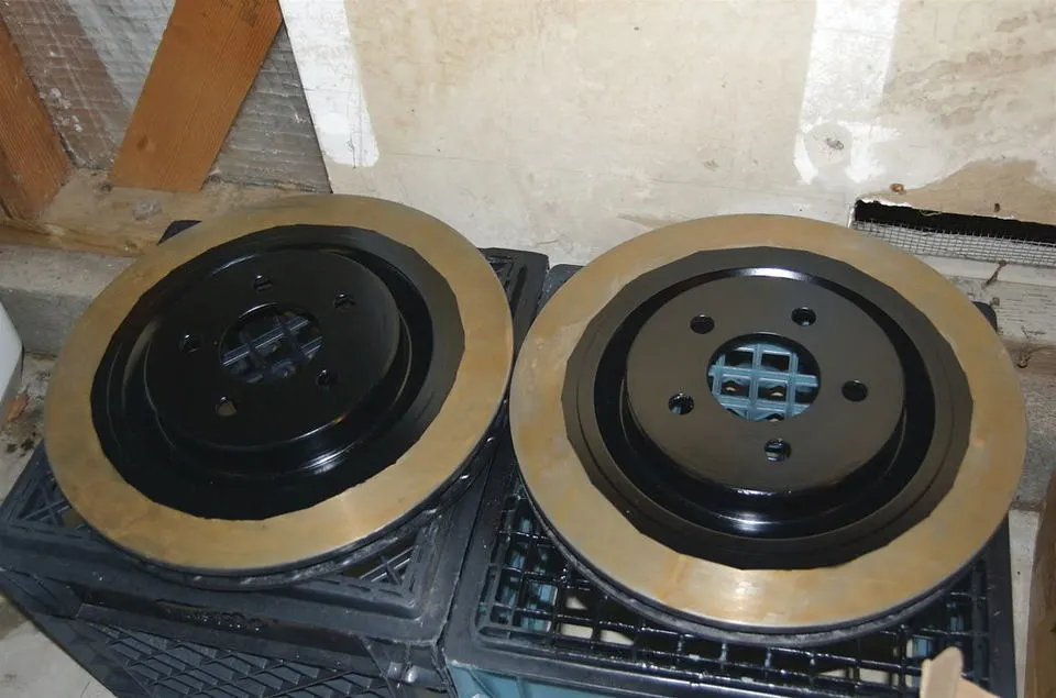

    Took a pic so you guys could see.
    [IMG]
    [IMG]

    THATS FINE. IT WILL COME OFF THE FIRST TIME YOU HIT THE BRAKES

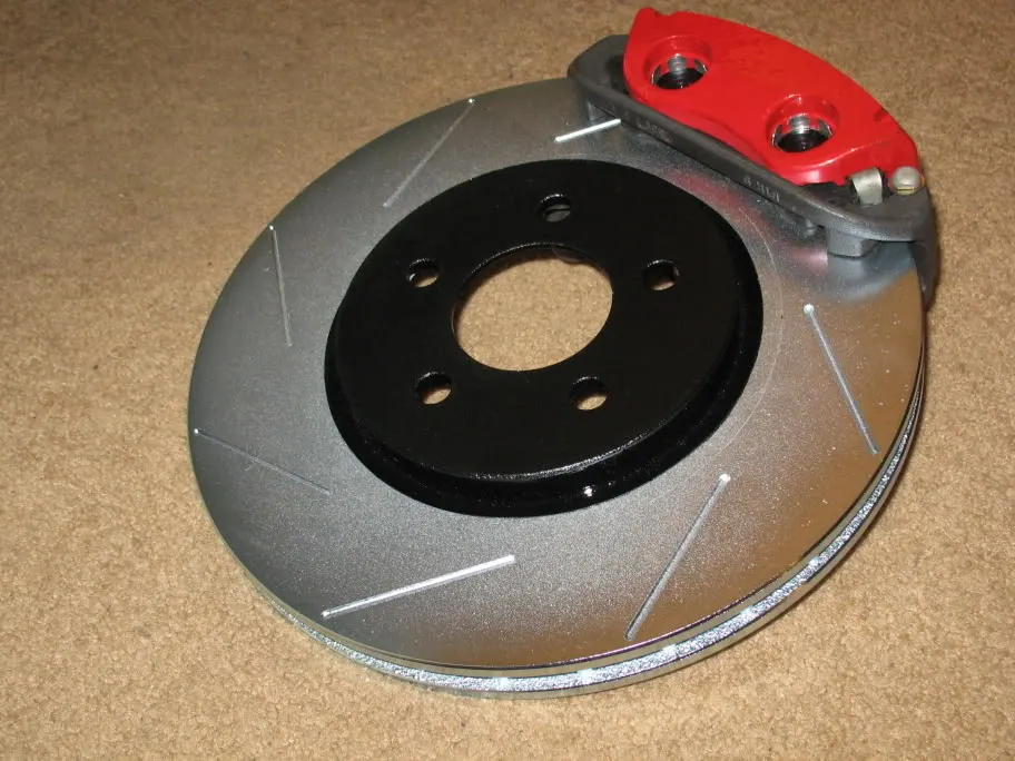

    The venting area wont come off, it's not a contact area, that's why zinc coated is kinda FTW sometimes
    [IMG]

    Normal... doesn't look like they are oil coated much, if any. That is why.
