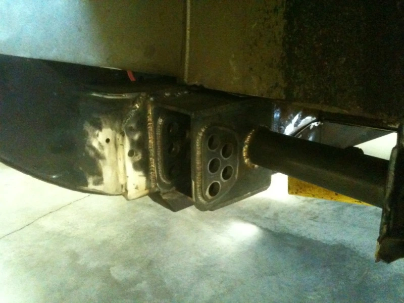

    I think mine is a little different. It has 40-spline axles, so Strange uses larger diameter 3.25" axle tubes with those, also they're welded inside the center section as well as where the tubes meet the center. Also, my 3.812" Ultra Case has the Large Pinion Pro Gear. (I don't think anything on mine is interchangeable with a factory 9", but I'm seriously not an axle expert) Another difference you can't see is that the mounting ears for the UCAs are actually sunken into the housing in order to avoid messing up the IC.
    I wish I knew the weight of mine. It's sheetmetal with an aluminum ultra-case and the "Daytona" bearing support. Also, the axles are gun-drilled and it (obviously) has a spool. Oh yeah, it's also narrower than the factory 8.8. It may not be heavier??

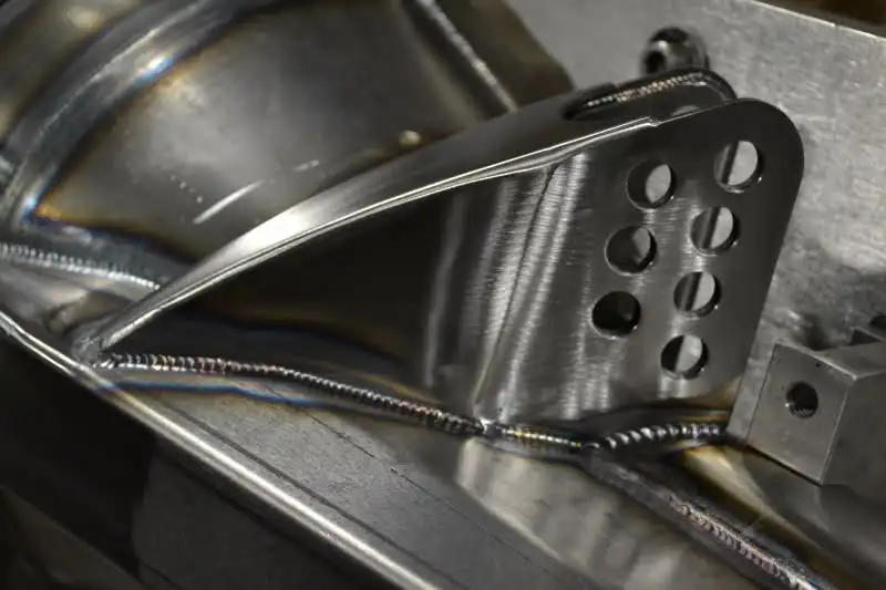

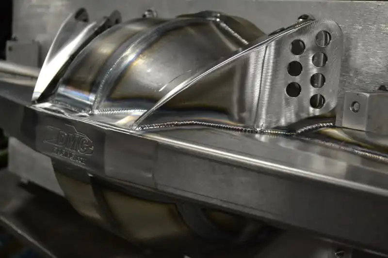

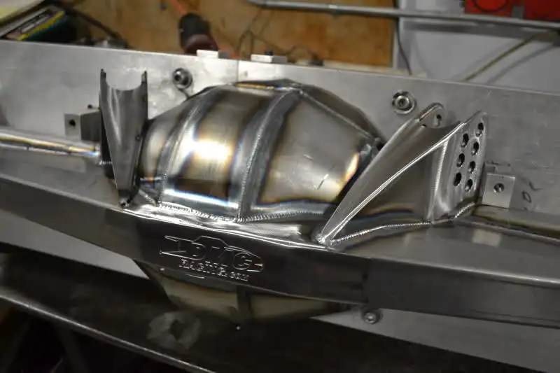

    saw that on FB today. Pretty sexy! Now tell me Derek, does it look to you like the UCA mounts are wider on that housing than on the factory housing? It does to me.
  13. srtthis
    srtthis the guy doing it does every local racers rear end
    Joined:
    Jul 3, 2009
    Messages:
    4,050
    Likes Received:
    548
    Trophy Points:
    154
    Location:
    in the shop working!
    You mean center line of each control arm or the bushing width? It def looks wider center line to center line
  14. Rick 91GT
    SN Certified Technician Site Sponsor
    Joined:
    Messages:
    9,697
    Likes Received:
    94
    Trophy Points:
    99
    Location:
    PA
    I thought the same things...looks wide...very nice piece, lot of fab work into that thing, cant imagine the cost.
  15. Sharad
    Sharad ALWAYS choose the V over the P!!! Wait... what?
    Site Sponsor
    Joined:
    Jan 5, 2011
    Messages:
    1,500
    Likes Received:
    416
    Trophy Points:
    94
    Location:
    Fort Myers, Florida
    See how my center section is notched to position the UCA mounts with the factory width and instant center?
    The upper mounts in the DMC housing SEEM to be spaced farther away from the center section, which would make the uppers closer to parallel than the factory configuration.
    Hard to tell from a picture though.
