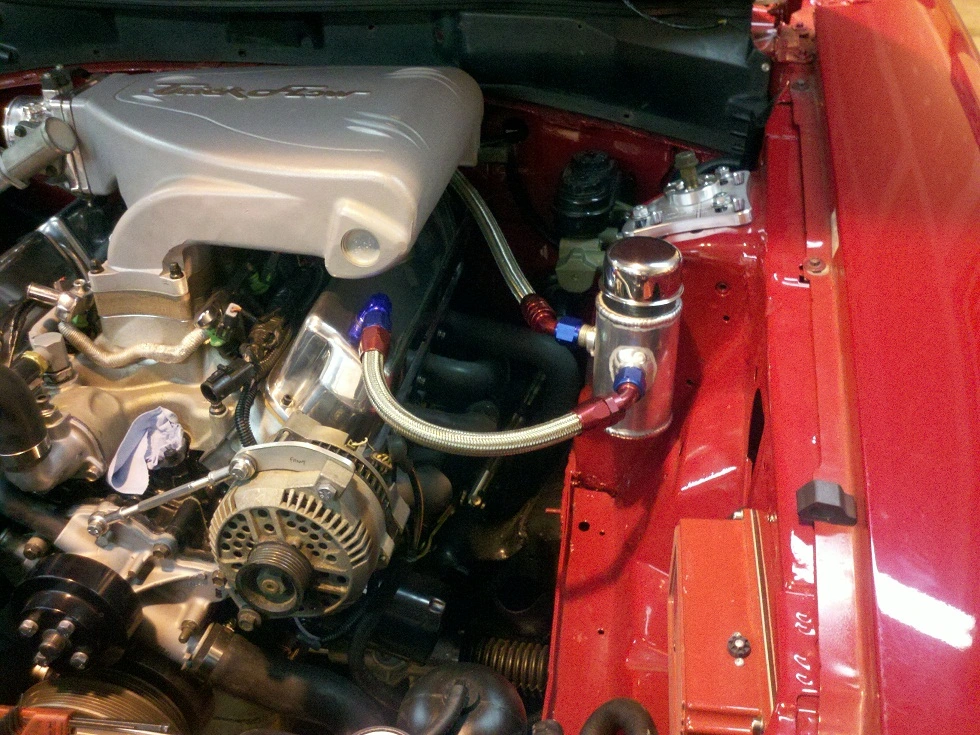

Here's a breather tank set-up I just did on a customers 94...it is boosted, no PCV

Yes the line coming around the backside of the motor is in the rear of the passenger valve cover....
Thanks for the compliments.... The hardest part is trying to get the breather as high as possible so it doesnt naturally pull oil. A lot of times if the engine bay isnt open I end up making the can itself just for clearance. This one I was able to start with a Stefs and weld in a additional bung.
Ive thought about putting a few kits together to sell, or a design your own kit...you tell me what length lines and I'll fab it all up.
**Noticed you can see the little alt mount I fabbed up as well, car has no a/c or p/s and a Vortech and I hate the Vortech alt placement so I had to come up with something.
Thanks, I made templates, the bracket and alternator are being powdercoated black as we speak....
Its amazing how much trouble it is to move accessories and maintain belt wrap
Looks good, Rick. I think that my breather leaks all over the place and might need you to fab something up for me, too. I don't believe in deleting the PCV system, though. Unless, you can make me see how that would be advantageous in any way, I don't think I'd go that route. Where is the line in the back going? Into the crank case where the PCV system normally runs?
sorry, a couple other questions ....
is the catch can an oil separator? or what does the can catch?
how does air flow through that system? is the catch can vented?
how effective is that kind of setup for alleviating crankcase pressure buildup?
as i said, i can be kinda dense sometimes ... :lol:
The catch can is just a "open body", purely to catch any oil mist/vapor and condensation, most have drains located on the bottom.
The can has a vented breather, so the pressure travels through the -10 or -12 lines to the can, and vents (NO PCV)
I find this to be HIGHLY effective at times, depending on the combo. The PCV is effective is working, sometime I find it just isnt enough, and this usually alievates all the pressure.
Scott, aka Raceaholic is doing a tank in line with a line from the PCV, Im intrested to see how that works.
