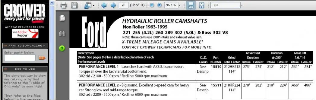

    I have used the crower 15511 cam and was not real impressed, but it was an AOD car.

    that's why, it's meant to be a 5 spd cam.

    I did note that it was an AOD car, so yes im aware results could be different in a stick car. But then what cam wouldnt be.:shrug:
    From what I remember it never stated 5 sp only.

    from their on-line catelog - the 15510 cam is the auto cam. Both great mild cams
