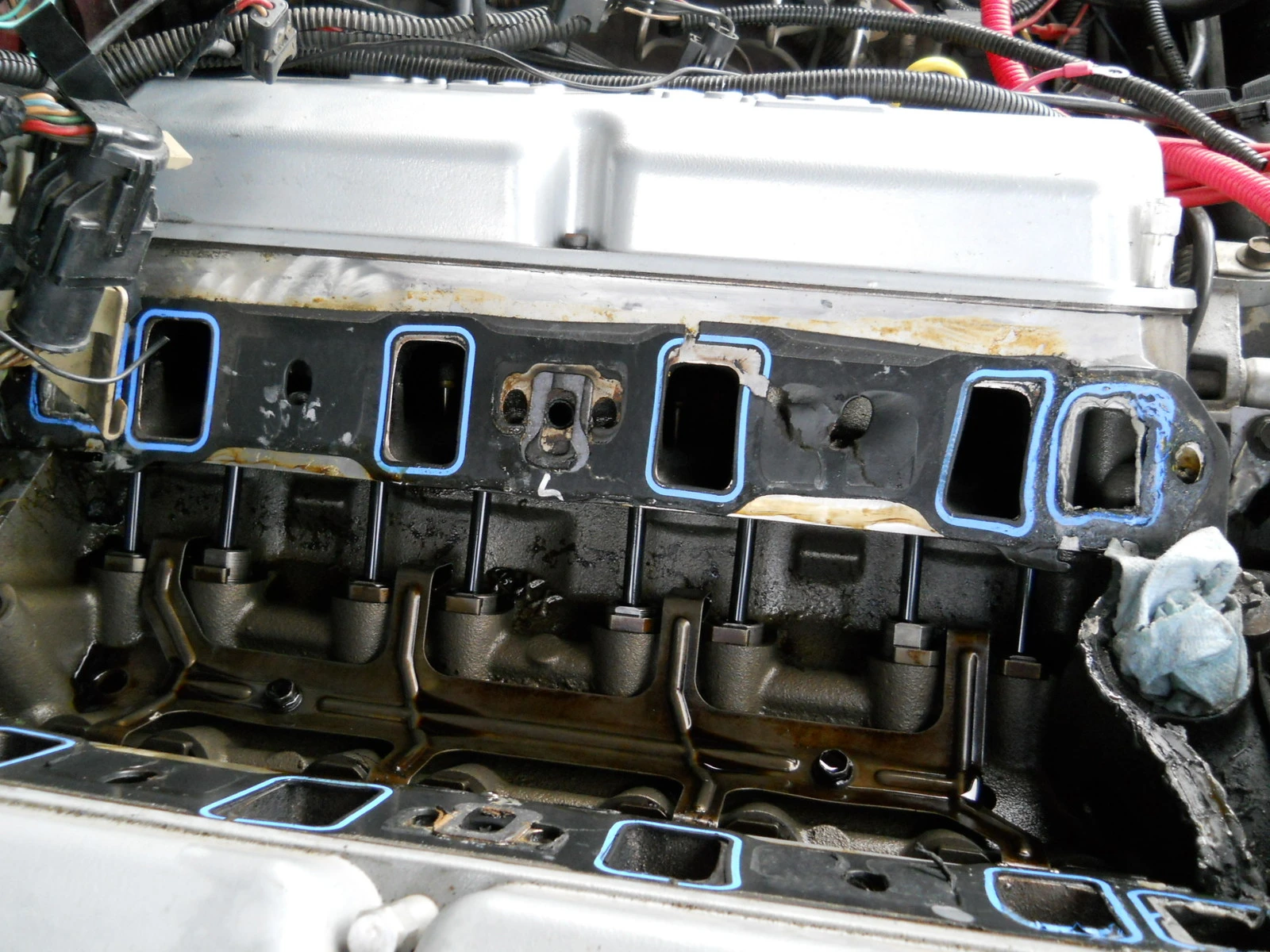

  14. This is what I got using Fel Pro 1250 gaskets TWICE! 007 (3).JPG 007 (3).JPG
  15. Yup....those damn fiber prinoseal gaskets.....they're worthless. Not intended for long term use. Guys have had better success with a set of their 1250S-3 gaskets. They still use the printoseal , but are built around a steel core design, so they won't shift around and come apart on you like your old ones did. An even better alternative are the Victor Reinz "nitro seal" gaskets. They too utilize a steel core, with graphite facing. I've used them in the past and they work great. I've heard nothing but good things from anyone else who's used them either.
    Part numbers for them are below, depending on which what size water port you need for your heads.
    #95186SG large water port.
    #95187SG small water port.

  18. WOW Looks like you would be losing HP on a few cyl. just from the gasket migrating. Why cant they make a gasket that looks like the modular ones? Hard plastic with raised rubber?
    Where can i buy these Victor Reinz Gaskets?
  19. My port Size is 2.10" x 1.30" I'm not sure what intake gasket will work. The 1262S-3 is 2.10 x 1.28 Pretty close. I think i was using a gasket too small. Also are Torque specs different with gaskets using a steel core?
  20. Torque specs are same for all intake gaskets. I torqued my lower intake manifold bolts the same with the 1250's and the steel core gaskets I finally replaced them with. Also Auto Zone can get Victor Reinz intake gaskets.
