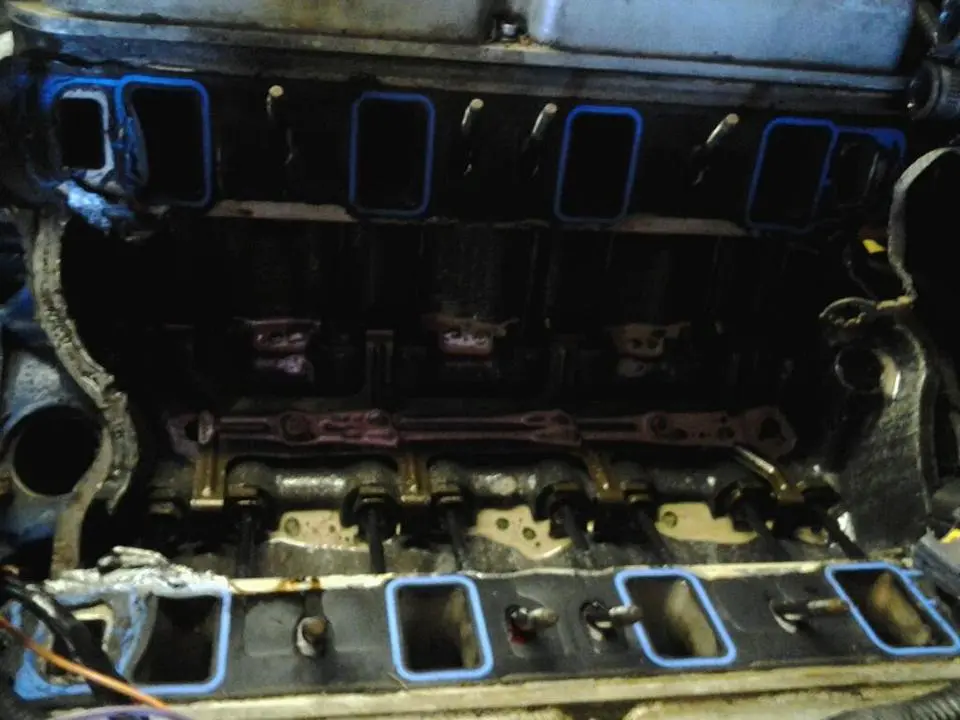

    My water crossover ports were to the point where if that one behind the thermostat didn't leak then any of the other 3 would have leaked inside of 6 months. But at least it looked like i did a great Torque job.
    I torque my gaskets in 4 steps and keep repeating the torque sequence until the bolts stop moving before going to the next torque setting. (Yeah it takes forever but it made 1250 gaskets lats 4 years.) I Torqued my intake to 6/12/18/24.

    My Carnage...My phone is crappy.
