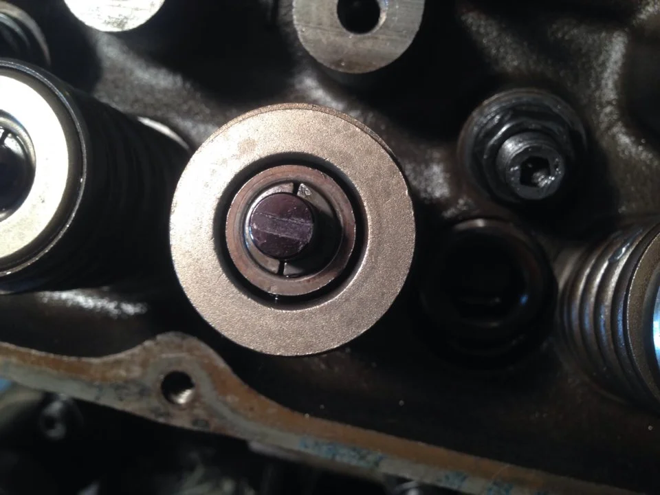

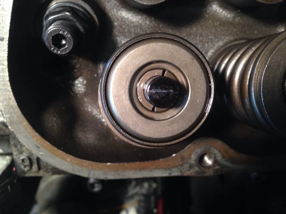

Ok I think I got it then! The .6250 Looks like it has the correct geometry so I'm going to get a set of those, 1.6 scorpion adjustable rockers, and a set of shims. Got my digital caliper in the mail yesterday and will be measuring the p2v tonight. Wont I also need to know the cam's lift to figure out how close the valve will be to the piston at full lift? How can I find that without knowing the cam specs? Maybe a dial gauge to the pushrod?
but i will need solid lifters?I've seen this one before, should work fine. GL.
with the 6.300 pushrod on the exhaust side I measured the p2v. I saw a .085 at the smallest bit of clay which is too close for comfort on the exhaust side I believe. I think I will just run the 6.250 and shim it until preload is below 3/4 turn.
