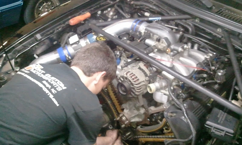

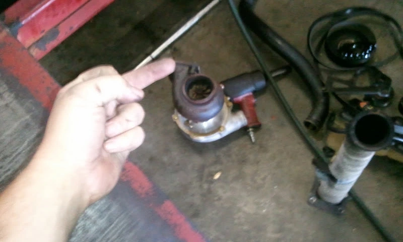

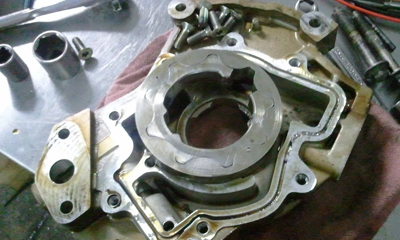

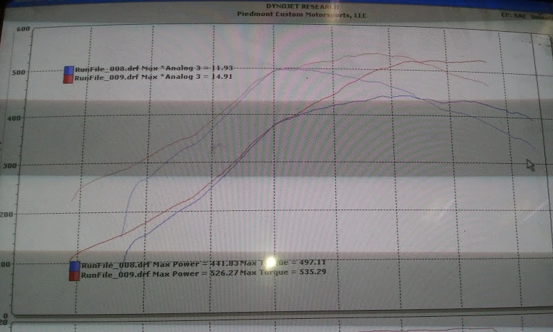

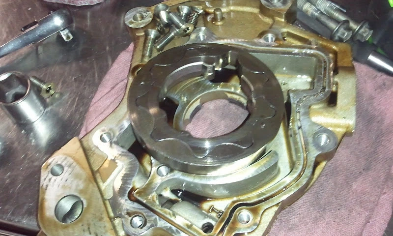

    First off let me say that it was not the tune that doomed her or the boost, we made 6 pulls all fine no fuel issue.... 526rwhp/535rwtq....14.5lbs of boost... Oil pump **** the bed @ 5500rpm by the time 6000 came around on the dyno the engine AND the turbo locked up... heads and cams are toast, the crank gone.. Only thing that is usable is the block, rods and pistons. New turbo, built bottom end, heads and cams coming soon, thats all I can say for now.:shrug:

  4. that sucks, i've seen it happen a few times on the 4.6
    hard to believe it ruined everything so quickly. usually takes a little more time with no oil for that to happen
  5. that sucks, i've seen it happen a few times on the 4.6
  6. Sucks Tank. Mine just let go about 2 weeks ago.
    Was that the stock oil pump?
  7. How many miles on the stock pump? That's too bad man, sorry for that but with a built block that thing is going to be evil. Because of you, I want a turbo.. stupid California would make me have to take it off every 2 years to smog though. Might be worth it
  8. What he said.
    Sorry to hear about that, man. I was terrified of something like that happening to my brand new motor, so I plunked down the cash for a TSS billet oil pump. You can get them from Modular Head Shop, if you're interested.

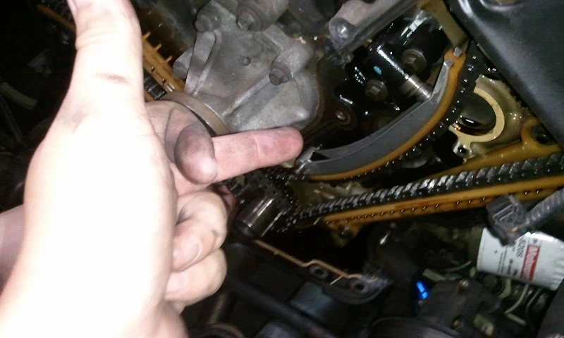

  9. Yep the stocker, 130,000+ miles on it. I just had the timing chains out and should have replaced it when I had the chance. On a lighter note the car did make over 500hp:rlaugh:
    Im looking into getting the TSS or the MMR pump. Its going to be a few months before I get the cash to rebuild it, but my goals are a 550-650 street car.

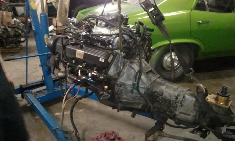

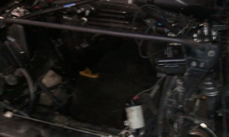

  13. UPDATE. Engine out, replacement on its way. Also new Milling oil pump w/ billet gears:nice:
    Lame cell phone pics*

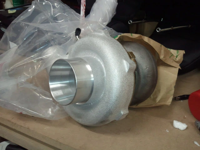

    Well, I was going to install another stock 4.6 in the car, but got down to the wire for mustang week, and not going to make it. So i have decided to do a full out engine build. I just got a 5.4L block, 2v timing cover and forged crank, turbo is back from precision:nice:
    -parts list
    5.4L block
    5.4L forged crank
    Stock SOHC ports w/ 3 angle valve job
    Stock PI cams
    Eagle ESP H-Beam Connecting Rods
    Probe Pistons (9.1 compression)
    ARP main and head studs
    Milling Billet oil pump
    AND
    TWO precision 62mm billet turbos
    goal is to make 700rwhp on 93
