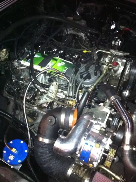

We got the car running really good. TPS set at .96v, Timing set at 10 degrees, idles at 800 rock solid. Damn AFM valve covers still leaking. We chased the threads for almost 3 hours. The guy before us put RTV in every thread. We tried and tried to clean them all out. We used shims but nothing worked. We are done with these covers. Rog is ordering TFS in black on Monday. They use studs with nuts.
Rog dialed the car in with the twEECer. Was running rich so he took 10% fuel out at idle and the rich condition was gone. If the valve cover weren't leaking right now we'd be driving it.
