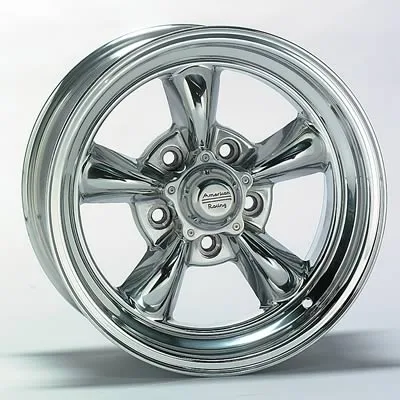

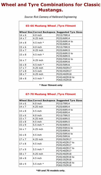

I wanna 17" wheels:
are 17x7" and 4,5" back space wheels OK?
Which wheel size and brand are the best also looks and fits (Foose, Boyd, Torque Thrust II, etc.)

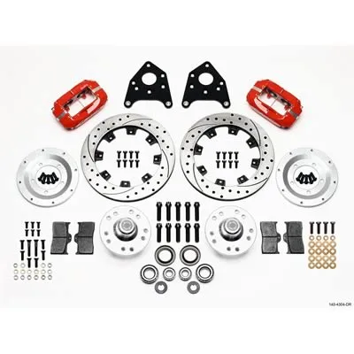

& willwood brake kits? (i likes red calippers)
Could you give me some feedback. Summit code like that...
